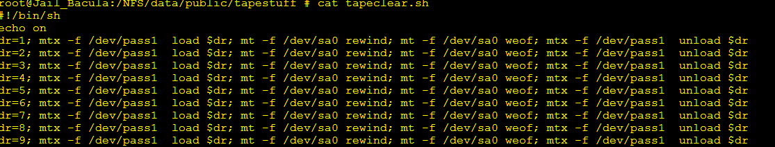

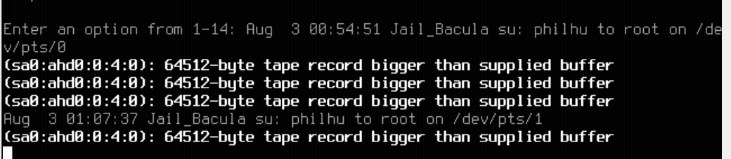

Got a tapeloader/drive writing tapes, was clearing them off and getting this error sometimes on trhe console:
Script I was running is:
Script running is:
I am sure there must be a buffer fix somewhere.

'fixed'
The error is a very badly worded informational message
The internal buffer is 131072, the message is really saying that that is the amount of buffer left, not that the buffer is too small.
