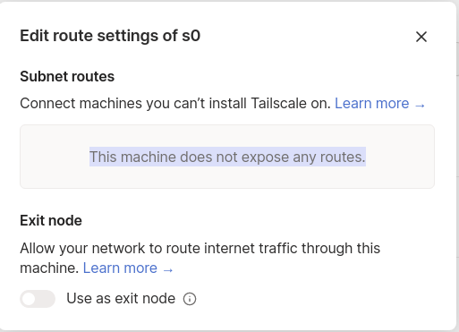

seem not working for me:
I added my subnet but in the tailscale admin panel I can’t se any subnet

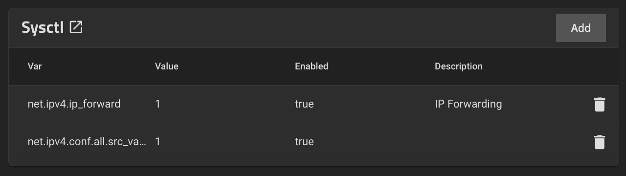

ip forwarding is enabled (as for truecharts guide here)

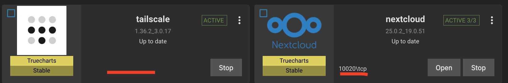

one thing I noted is that the app doesn't show any port:
9,700
It's not using one. (not to listen)
I don't think that's necessarily a requirement, but OK.
I ran the app and published one subnet in the Routes Field.
I immediately see it in the Tailscale website and can enable that route.
I have no idea what you're not doing right... are you sure you're connecting to the same account you're looking at?

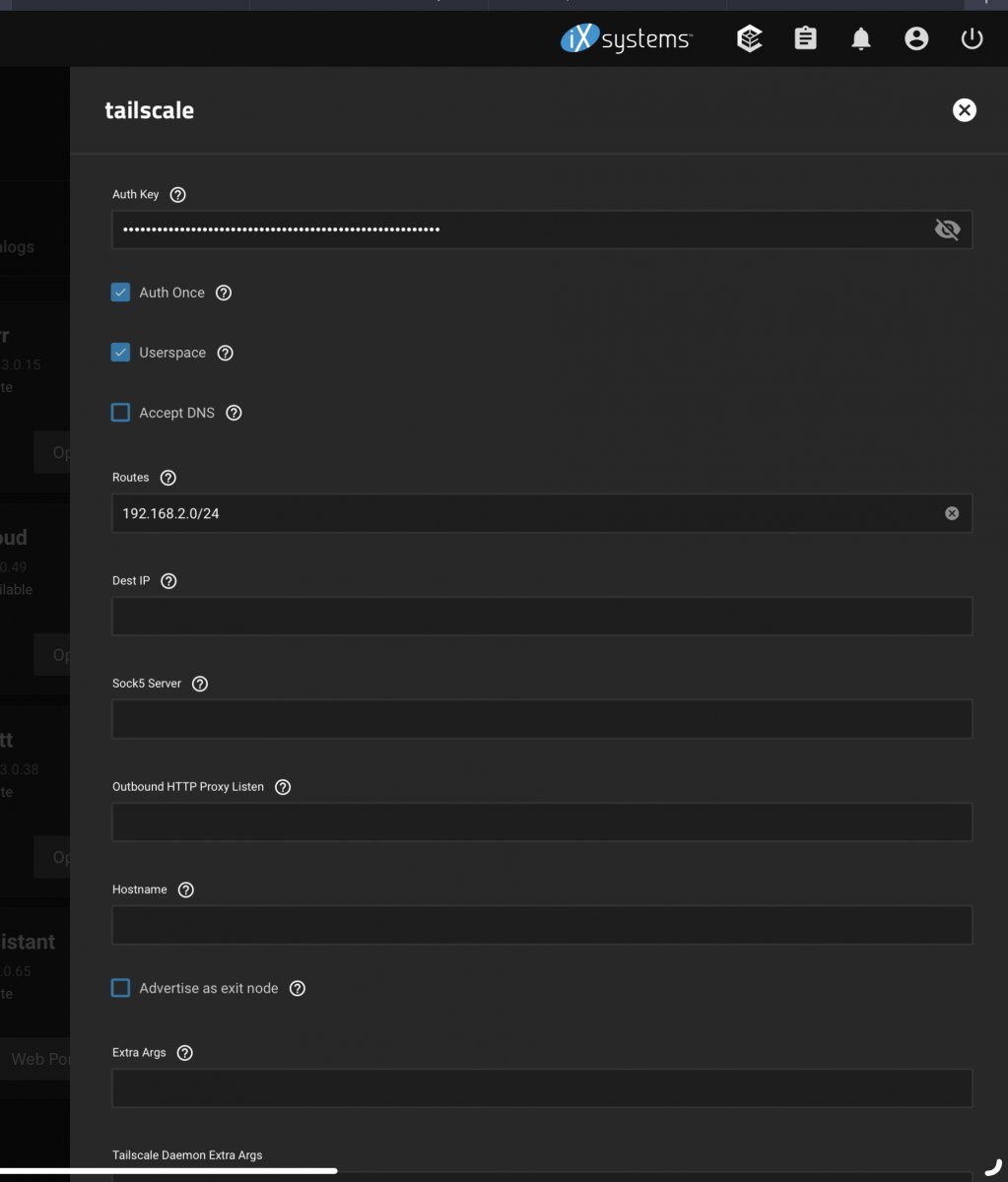

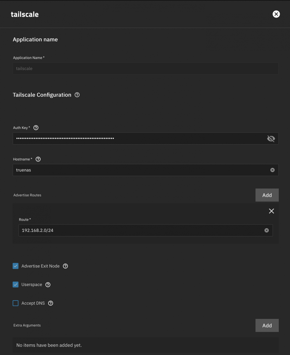

sure:
my network is 192.168.2.xx
is a super basic configuration and I've done nothing particular other than reinstalling...
imho if you still have problems is probably due to permissions

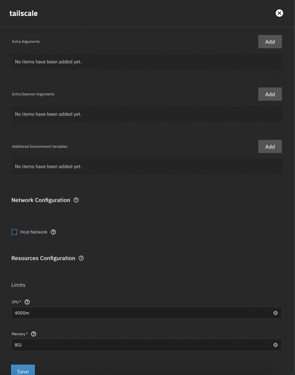

I'm having the same problem, I've tried reinstalling but nothing changed.. To get to the truenas UI through the tailnet, I have to check 'Host Network' but anything hosted on a port, immich, home assistent, etc. can only be reached outside the tailnet locally.
