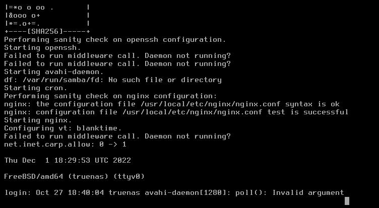

I managed to install Jellyfin a few days ago using the instructions and packages available here:
I had restarted TrueNAS a few times while installing Jellyfin and configuring it last night. I added several shares to the jail and let Jellyfin scan my media libraries.
Today, I can't get TrueNAS to deliver any services including its own web management interface. I fired up IPMI View to see what's going on and see an error message I can't understand, repeted every couple minutes in the iKVM console (see attached .jpg of the screen).
Can anyone see how to regain the use of my NAS server?

Jellyfin isn't even on the FreeBSD ports tree. Plex and Emby are, but not Jellyfin. I'm guessing you're using an unofficial package?

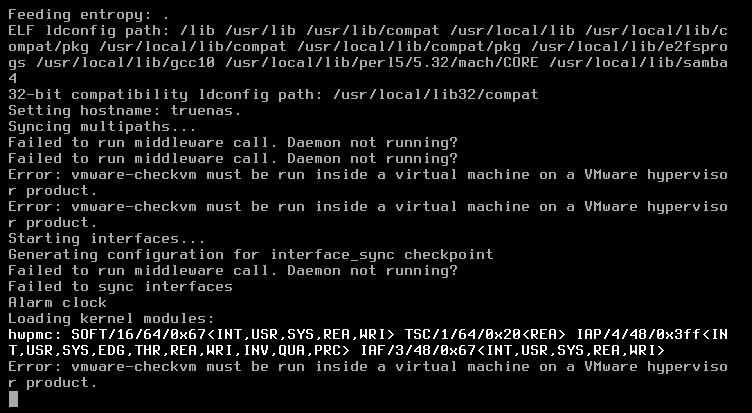

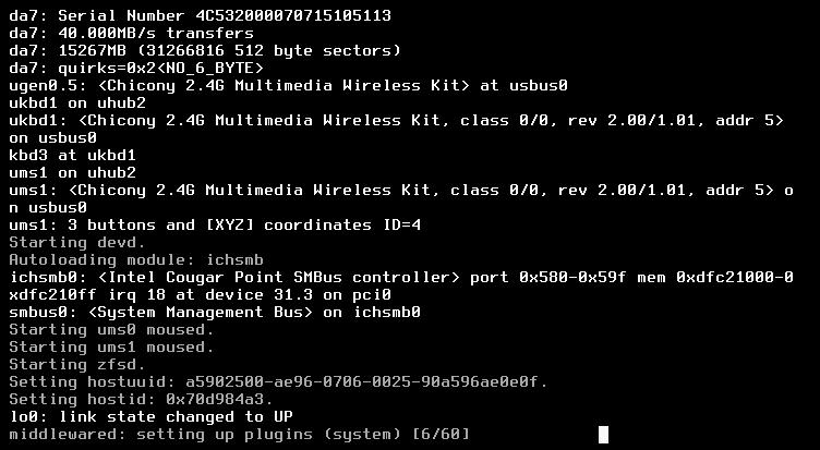

Sorry, I thought I gave the relevant network details. The 2nd router runs on the 192.168.0.1/24 subnet. I have never gotten confused and am unaware of any conflicts since 10 or so years ago when I went with that topology.
You are correct on all the other points about my network.
Glad you found the github repo and gave it a spin. I was very impressed, my first time using Jellyfin. Jellyfin worked great inside the iocage jail for me for the first several days I had it installed, and survived several reboots without incident. I'm not sure why I have this problem after only adding a jail. I captured more error messages as it was booting up. I think the 2nd screen shows some services that refused to start and are most likely part of my problem. Please help. I (iocage) exported my Jellyfin jail just in case I had trouble later. I can get a root command prompt using iKVM. I wonder if removing the Jellyfin jail from the shell would let me use the web interface again? Please help if you can. Thanks

I've never seen those vmware-checkvm calls. Are you running this in a hypervisor?
Jellyfin working fine for a while and suddenly failed leads me to believe that you may have corruption on the boot device. It's not installed on a flash drive, is it? Cause those are notorious for dying quick deaths under intensive TrueNAS use.
Do you, by any chance, have backup of your working config file? If so, you may have to clean install TrueNAS and restore the config as a last resort.

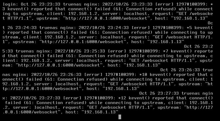

It looks like Nginx was able to start correctly, but all the middleware calls are failing. Quite honestly, I have low confidence that removing Jellyfin will recover your TrueNAS web UI.

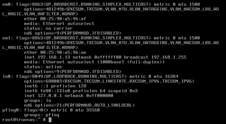

Could you post the output of
ifconfig

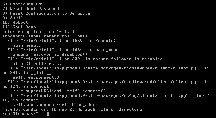

from your screenshots it looks like trunenas is fully booted....
you should be able to login typing root and then your password
then type:
/etc/netcli
and it will show the IP for the webinterface...
and let you configure an additional IP if the default ip is blocked by Jellyfin

Back home again. Here is the output of the ifconfig command as well as the results of choosing option 1 after typing /etc/netcli
When I tried 'iocage jellyfin stop', I received a message saying there were no pools & iocage requires a pool. Guess it never gets as far as mounting the 7 drive pool on my server.

I'm guessing en0 is your NIC? Seems like it at least initializes the network card correctly.
Try running sockstat -4 and maybe see if some essential service is missing (whatever the middleware is).
The only thing I can see there is it looks like your boot drive might be corrupted and you may want to do a clean install and restore your backup config. You can do a clean install by reinstalling from the TrueNAS ISO. Would probably be my next step unless someone else here has a better idea.

It turns out that the BIOS for this board stopped allowing access after 1/1/2020 and Supermicro put out a new BIOS that fixes that problem. For the benefit of anyone having a similar issue with their Supermicro board, here is the link to the discussion of it I found online:
I also had to discover that f11 during boot with this board gets you to a screen to choose the boot device, without needing to enter the BIOS. & While I was at the Supermicro site, I found and flashed a new firmware (specifically for just the IPMI part of the board) under the support section for this board. After upgrading the board BIOS to 2.3a, I can access the BIOS and change the boot order.
After catching up that part, I booted TrueNAS core 13.0U2 from a USB key I made from the .ISO file. When I told it where to install, it asked if I wanted just a new boot environment (rather than to reformat the whole disk and lose the one I was having the problem with), created it, and then when I booted, TrueNAS found the database, updated it, and all the configuration carried over without needing the backup configuration file.
To my surprise, everything seems to be working OK (including the new Jellyfin jail) after this. Watching it closely to see if the same thing happens again. My fingers are crossed.
