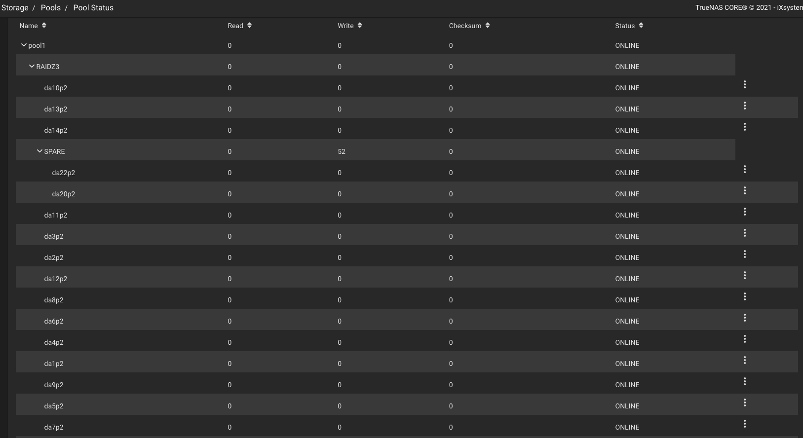

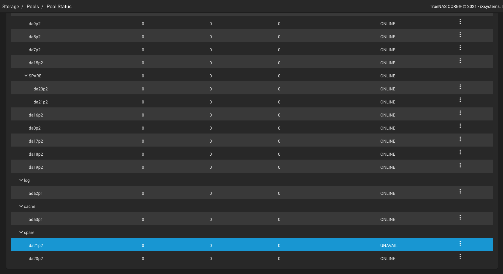

Hope someone can point me to the right direction. For some reason I have a disc (da21) that shows UNAVAIL and whatever I try, it wont go online. I also did a SMART test and this returns a succesful test. Additionally, this same disc shows up twice in both spare location and there it shows the status ONLINE.
I have attached the screenshots of the pool disc status.

It's a spare that's currently in use...
You need to decide what you want to... either keep it in the pool or put it back as a spare.
To put it back to spare, you should be able to zpool detach RAIDZ3 /dev/da21p2 (or maybe you will need to look up the gptid instead with glabel status and use that instead).

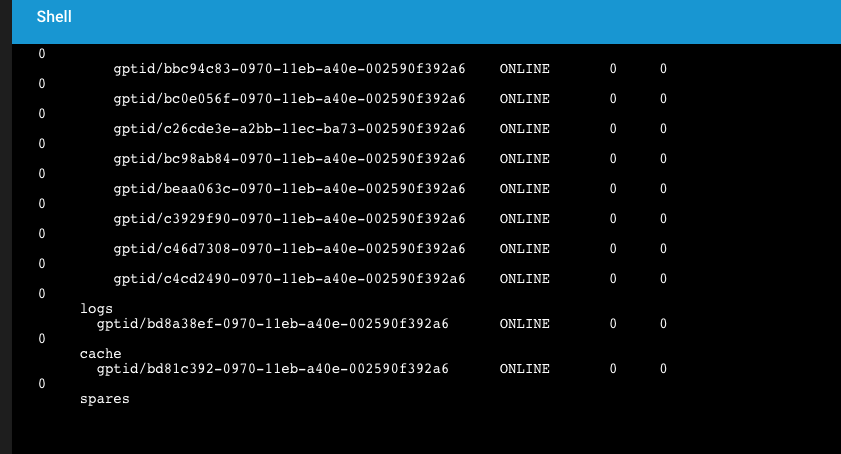

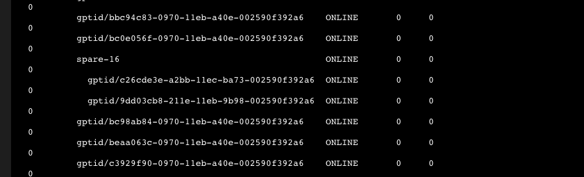

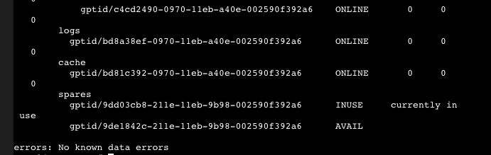

The Zpool status confuses me, as I am not able to clearly identify which of the discs shown is the da21p2. In the screenshots of the first post you see that there are two spare discs with status UNAVAIL and ONLINE. But Zpool status below shows two discs with INUSE and AVAIL. May I assume that for both situations the order of the discs is the same? So da21p2 (UNAVAIL) is INUSE?
And would this be the command to try when using gptid:
zpool detach RAIDZ3 gptid/xxxxx-xxx-xxxx

9,700
Yes.
Don't assume, use glabel status to link the gptid with the partition/disk identifier

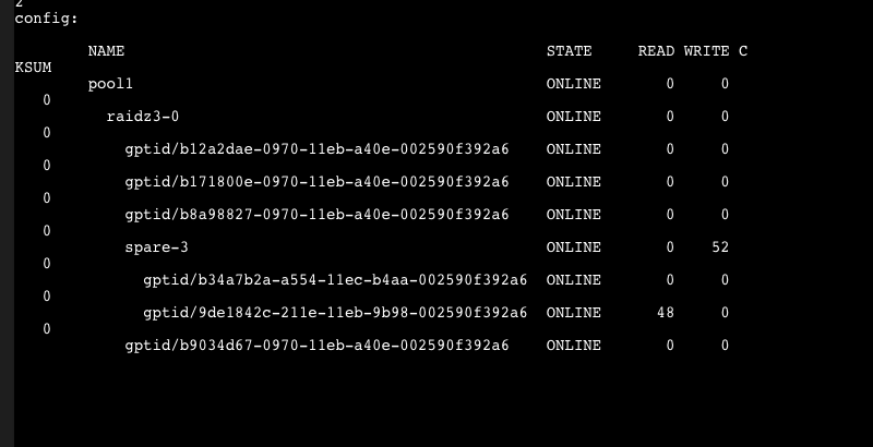

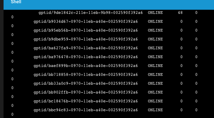

Let's see zpool status -v RAIDZ3
xbmcgotham
Oct 16, 2020
26

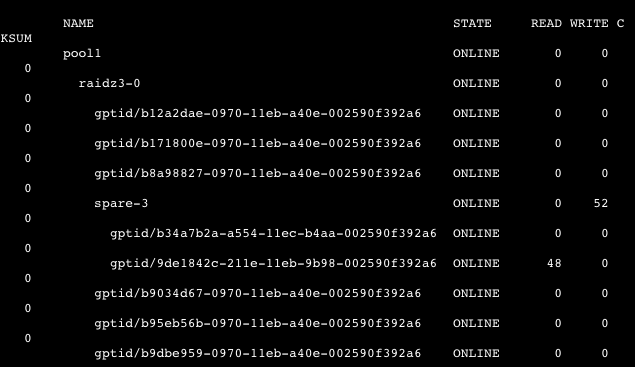

please find attached the screenshots. Its interesting to see that here it says both spares are AVAIL but still pool is shown unhealthy.
Thanks again for helping!

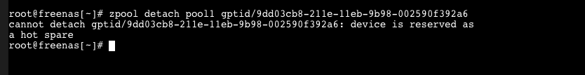

9,700
if your pool name is pool1, the command you ran earlier was wrong...
zpool detach RAIDZ3 gptid/9dd03cb8-211e-11eb-9b98-002590f392a6 shouldn't have worked... should have been zpool detach pool1 gptid/9dd03cb8-211e-11eb-9b98-002590f392a6
It seems your spare is still attached so you should run zpool detach pool1 gptid/9dd03cb8-211e-11eb-9b98-002590f392a6 and zpool clear pool1 assuming you're happy the disks are all now in good shape and you're ready to go back to monitoring things as normal.

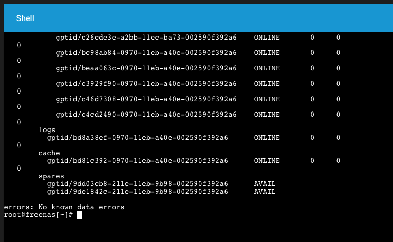

xbmcgotham
Oct 16, 2020
26
Hi, Sorry I did change the pool name, but had forgot to change it in my response below.
See response when running it again attached.
So I guess all is fine for now, but I just have to reset the pool errors by running the
zpool clear pool1
command?

9,700
OK, see if the clear sorts it out.
xbmcgotham
Oct 16, 2020
26
Great so I also did the same command for da20p2 disc. after this the pool status changed to healthy again!
