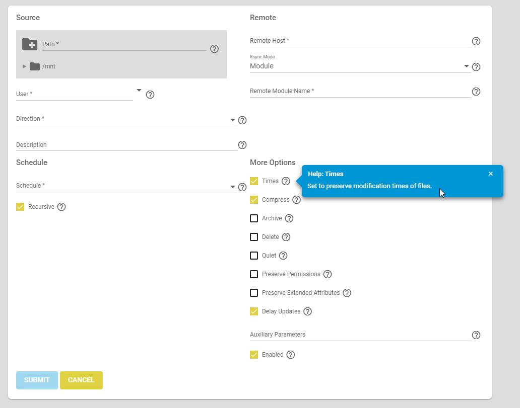

however i am very curious checking the rsync task for sipping how would i do this?
[user@truenas /var]# echo 'test' > f1
[user@truenas /var]# rsync -avv f1 f2
sending incremental file list
delta-transmission disabled for local transfer or --whole-file
f1
total: matches=0  hash_hits=0  false_alarms=0 data=5
sent 93 bytes  received 102 bytes  390.00 bytes/sec
total size is 5  speedup is 0.03
f2 is uptodate
total: matches=0  hash_hits=0  false_alarms=0 data=0
sent 48 bytes  received 105 bytes  306.00 bytes/sec
So here you see (1) file1 is created, (2) file2 is an exact copy of file1 (modification time and size is identical), (3) rsync skips copying with message "file2 is uptodate".
Important is that modification timestamp remain identical. If you initially rsync'd data without "-a", meaning "archive mode". That mode contains "-t" which stand for "preserve modification times". Then data is identical but modification timestamp are not. Because without "-a" or "-t" a new timestamp is applied reflecting the time of copying, resulting in rsync processing the whole file in the next run.
So just use rsync with "-a" or "-t" and it should speed up from the second run on.
EDIT:
TrueNAS Rsync Tasks seems to preserve modification times by default.
