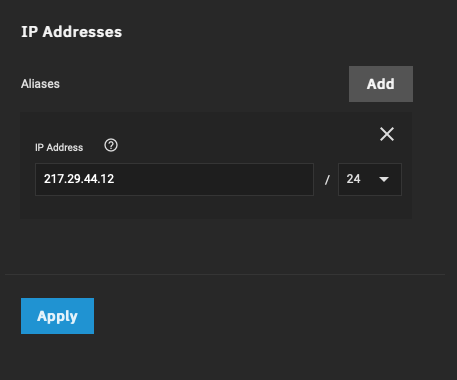

The UI might be a bit misleading.
You need to click on the interface you use and then add an alias - see screenshot.

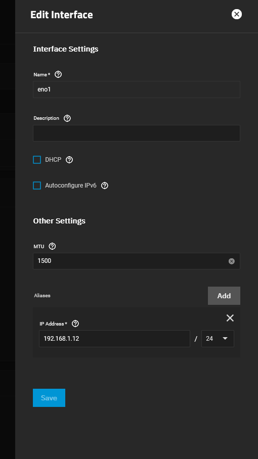

I have the same problem with fresh install of truenas scale but when I set static ip address and click save nothing is happening and the left panel still opened.
When you click save on that page, it saves it a change waiting for a test... back on the network interfaces screen you will see the options to launch the change/test and then again to confirm/finally save the changes made (if they succeeded).

The static ip in scale is called alias, so disable dhcp and add your desired ip as an alias.
In addition to that you have to set your nameservers and default route (your routers ip) in the global configuration.

Yes, the docs page is just nonsensical in that regard. You'd enter any static IP as an alias, in full CIDR notation (e.g., 10.0.30.10/24). There have been multiple tickets put in against that docs page (at least two from me, because there's a lot wrong with it); hopefully iX will update it to not suck before too long.
