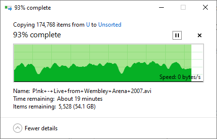

I am struggling to figure out whether the error above, which I'm seeing from two different cabled Windows clients, is being caused by something I've done wrong when setting up my FreeNas system
  • HP Proliant ML10 Gen9
  • Intel Pentium G4400 CPU
  • 32GB ECC RAM (Crucial)
  • 4x WD Red 6TB Drives in Raidz
  • Network card identified as Intel i219 (built-in NIC)
I have set this up with DeDupelication on some datasets so am expecting to need to add more RAM, but I've not been able to transfer any more than a few hundred GB as the transfers all stall too frequently to be usable.
If there's any other information that I need to consider to figure this out please let me know, any help greatly appreciated!

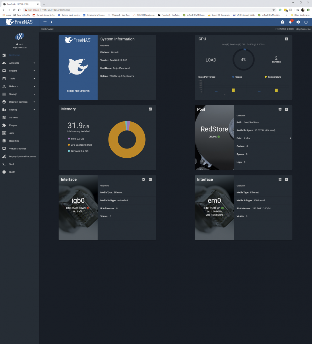

Thanks for the response! Nothing that I would call "special" about the network setup. I have a Netgear Prosafe GS108E switch & an Asus Wifi AC router. Not using jumbo packets, no config done on the switch... CPU usage seems to spike around 70% when transfers are able to maintain 100mbytes/sec and RAM seems to indicate most of it is being used by ZFS cache.
I'm aware Dedupe is almost frowned upon because of its hardware requirements, I intended to increase the RAM as I populated the datasets using the feature, assuming the more storage in use determins the memory usage of dedup.

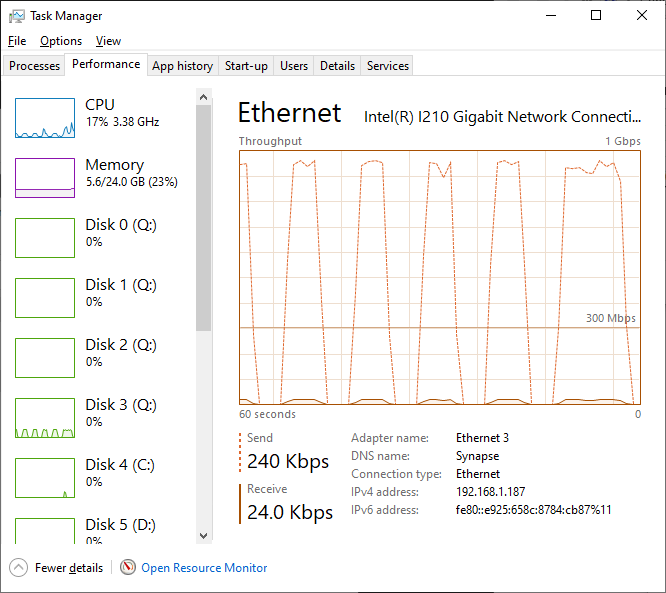

Thanks again for the response. So today I have rebuilt my storage pool as RAIDZ2 with an additional spare I had (originally removed because it reported pending sectors, but subsequently passed the WD DataLifeguard diagnostics tests) and not enabled Dedup. Copying 500GB across to it now, and while I've yet to see the error quoted above, I am getting regular in transfer speed from 100MBytes/sec to 0. It tends to hang for a couple of seconds before climbing back up and repeating. This is the same behaviour it was exhibiting previously before then giving me the error referenced earlier.
Is there anything else I can do to monitor what is going on with the server itself to figure out where this behaviour is coming from ?

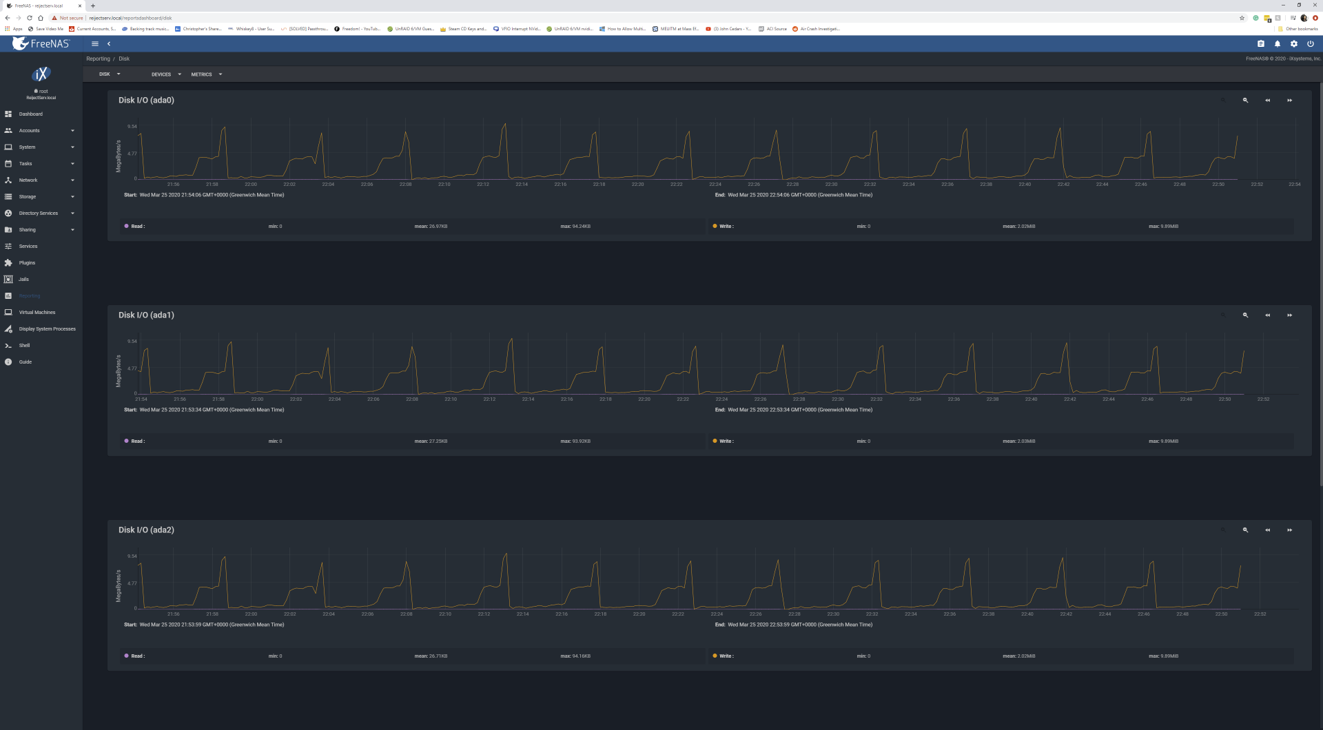

Looking at the disk writes - when I start to observe the error I notice the disk write activity seems to take this strange pulsing pattern. Might this point at any particular problem? Or can I look elsewhere to see what's causing this ?
