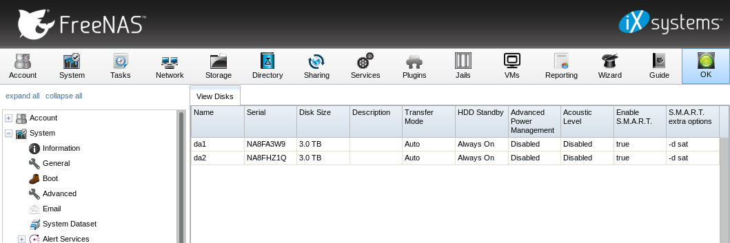

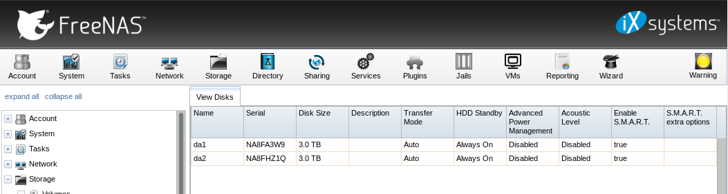

AndersL
Aug 2, 2017
5
Thank you all for this info, even though it is disappointing to me. It would have been such a nice and cheap way to get backup storage.
@Spearfoot : Yes, "Enable SMART" is true for both disks. See the screendump.
Why is the first "real" scsi-disk (the boot disk) not listed in smartd.conf? It is in my old 8.3.0 system.
You really mean I am just lucky being able to run the 8.3.0 system with usb-disks for so long (several years) without a crash?

AndersL
Aug 2, 2017
5
After some reading, especially at smartmontools.org, I could get smartd to work, by adding the extra smartd options -d sat. I will take my chances with external usb-drives for some more time, maybe I will be burned.
