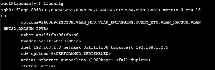

Hey i'm very new to Freenas i built my systems only few days ago. I have been transferring data from my PC to my NAS and only get about 40MBps writes. I was hoping if someone can help me find out what is wrong with my config as i'm fairly certain i should be seeing higher write speeds. I have run the ipconfig command and the "1000baseT <full-duplex>" has been detected. Could it be an issue with my cables?
I am also suspect that the read speeds are also having the same issue however i can't fully identify for certain as i don't know how to test the read speeds.

i also did a iperf test which falls in line to the speeds i'm getting
root@freenas[~]# iperf -s 192.168.1.10
iperf: ignoring extra argument -- 192.168.1.10
Server listening on TCP port 5001
TCP window size: 64.0 KByte (default)
[  4] local 192.168.1.3 port 5001 connected with 192.168.1.12 port 52550
[ ID] Interval       Transfer     Bandwidth
[  4]  0.0-10.0 sec   362 MBytes   303 Mbits/sec
