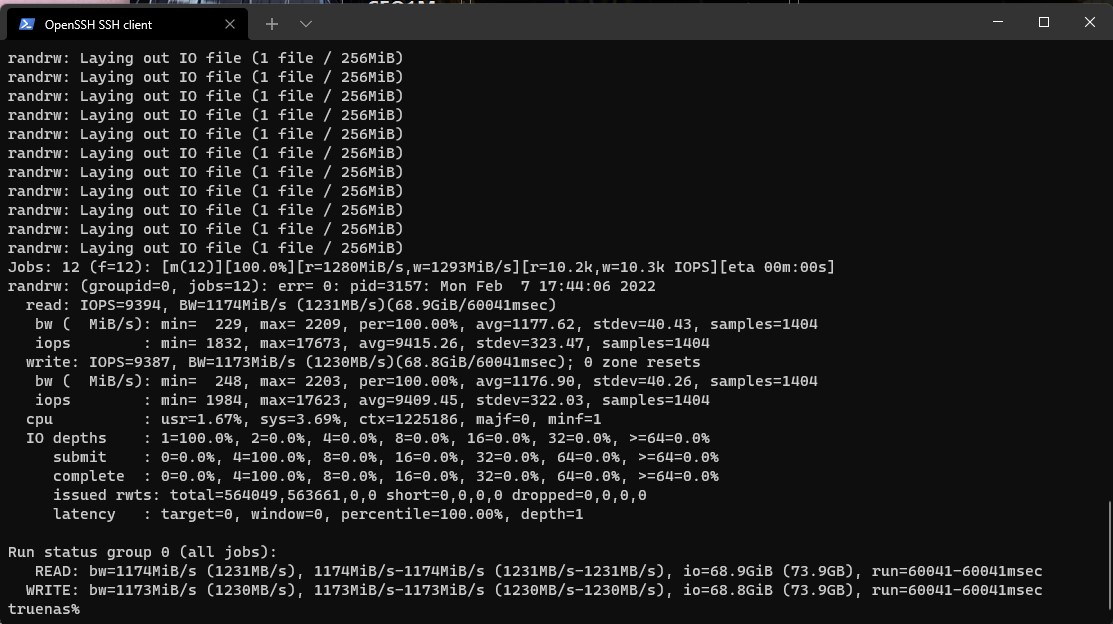

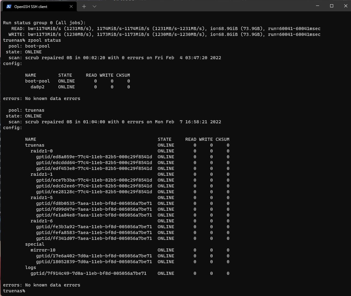

This is a home lab environment primarily hosting VM storage and Game storage (largely steam) via iscsi due to game mounting requirements and issues. I will out myself right out of the gate and state that the zvols are raidz1 (3 drives) and I know that it is not ideal for block storage as per @jgreco and his wonderful posts and guides. While it is a less than ideal state I haven't procured the drive(s) to move everything over and blow away the pool yet. That said the network performance is abysmal atm between the NAS and Windows 11 over iscsi (jumbo frames or not). Based on some of the guides and posts I have seen of others troubleshooting I am posting the performance across the drives which is showing I should be able to hit 10g speeds (which I had prior to 12.0-U8)
I'm sure we would want better for block storage however largely the speed has been acceptable.

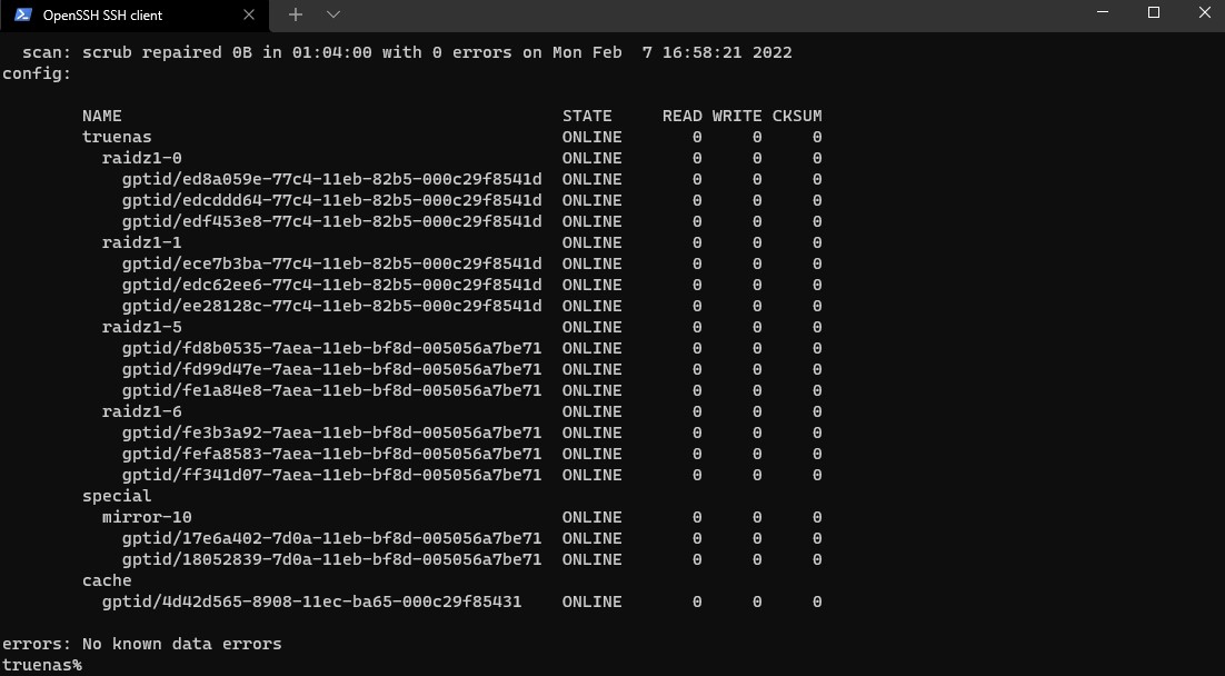

My pool configuration is as follows with 3 SSd's for SLOG and l2ARC, spinning rust sas drives for the rest

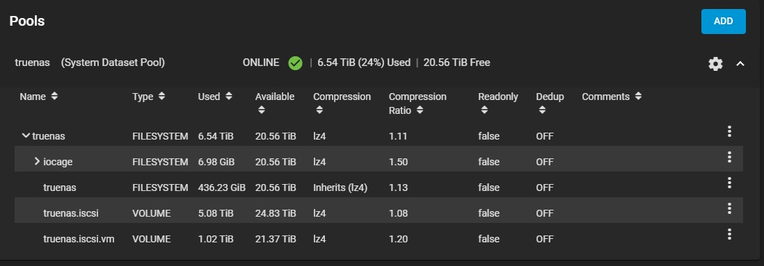

Pool configuration is here and note it says 24% which is roughly accurate given the 1vm in it's datastore and the 4tb of games on the iscsi share

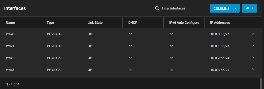

As previously mentioned I have 10gbe with 4 virtual nics for MPIO however since I'm the only one using it to the iscsi share and esxi is connected once to the vm datastore I can and likely will trim that back if not needed

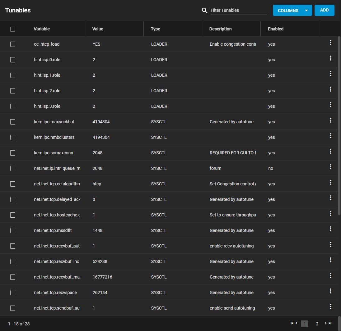

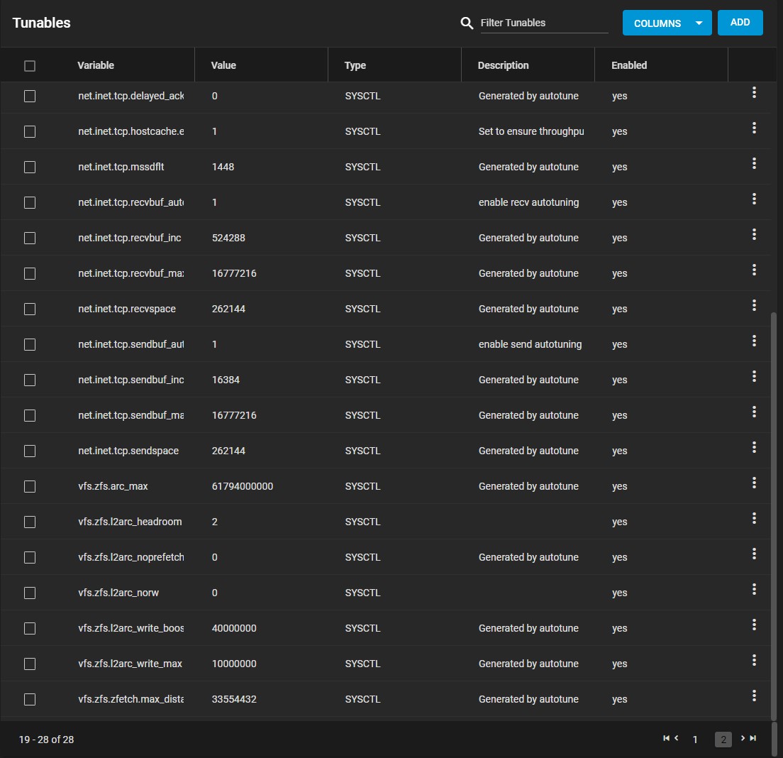

My tuneables are as follows

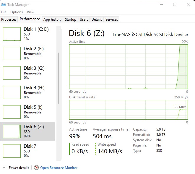

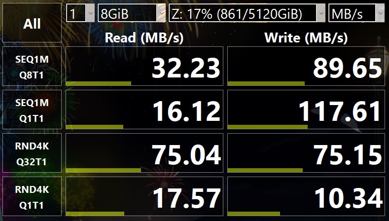

Attached are some graphs for experienced performance when attempting to do any work on the nas be it a single file move, stream a file, benchmark, etc. I'm at a loss as to what would have changed or why the performance is tanking. Network latency is shooting through the roof on any file access and when the connection to the nas hits 99%-100 latency can be anywhere from 100-1000ms making everything come to a screeching halt. While this graph is showing 104 MB/s that is actually a luxury due to the forthcoming results from a crystalmark benchmark and likely due to larger file xfer.

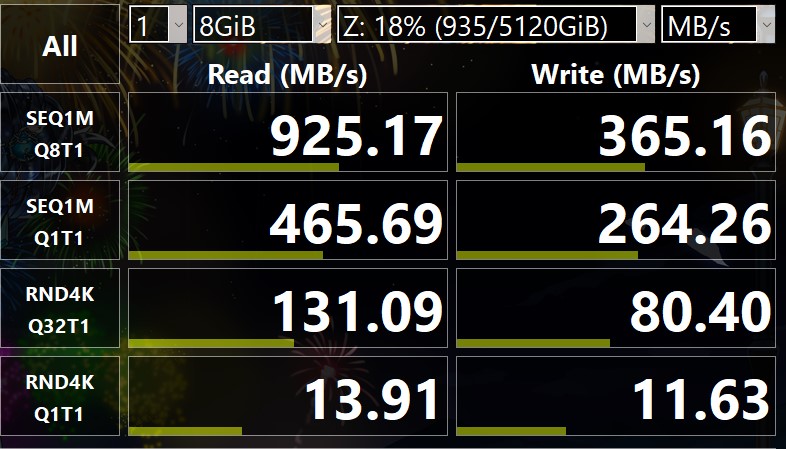

Here in all it's glory is what I'm experiencing from a file xfer perspective. I had previously experienced this at almost 1GB/s in the SEQ1 portions however given my setup I never expected it to be that high nor consistently that high. That said read performance is now terrible and is overshadowed by the current write performance which is backwards from what i have come to experience. No changes to hardware, or software other than the newest 12.0-U8 updated.
I've got some news for you...
You aren't running L2ARC, but it seems you have a special VDEV (for Metadata?).
Depending on the hardware (what SSDs you're using) your SLOG may be part of the problem if it's not up to the task.
You're not going to be improving anything with 4 virtual NICs for one user.
Since you've already identified the biggest problem (using RAIDZ1 for an IOPS-driven block storage/sync writes workload), I don't think there's much more I can advise you on.

Thank you @sretalla for the response. You mentioned I'm not running L2ARC... I thought that was how it was represented in the drive list with the "special" vdev. The 3 ssd's are Samsung 850s (540 MB/s max)
With respect to the 4 virtual nics I agree however the intent was never for me to be the only one using the datastore in this way.
The raidz1 performance previously had been perfectly adequate however after the update i'm experiencing a 5th - 10th of the performance I had previously become accustomed to along with the insane latency. I can certainly see a misconfigured l2arc / slog contributing to that however per my understanding (and the guides I followed in the beginning) I believe it to be correct.
L2ARC will show up as cache, not special. And also shouldn't be mirrored (not sure if you even can mirror it).
What you have is a special VDEV that is critical to your pool and can't be removed. Those Samsung SSDs are OK for that task.
That model of Samsung SSD is terrible for SLOG and you may find improvement just by removing it.
If you're serious about getting 4x 10G, you'll need to invest in Optane... check out the "finding the best SLOG" thread.

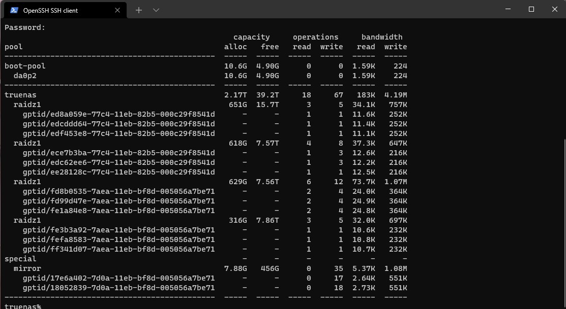

@c77dk You might want to check the SSDs with smart, to see how much write endurance they have left - and how much space (zpool iostat -v) they have left.
Here is the output of that
c77dk
Nov 27, 2019
468
sVDEV not full so that part seems ok.

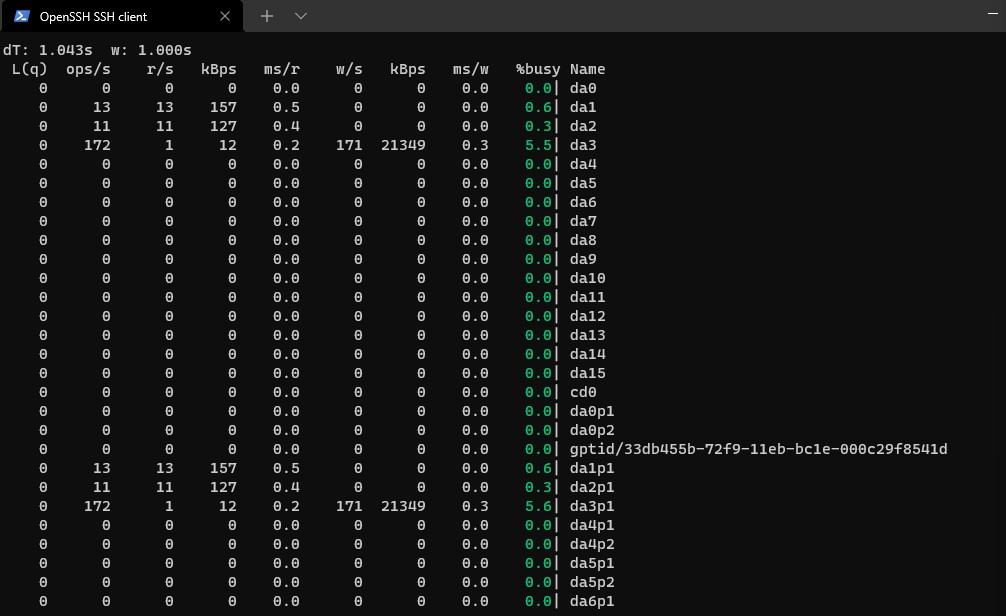

Then you might want to check how busy your disks are when you see the issue (gstat) - if you're lucky one of them stands out like a sore thumb and needs replacing
Frollo
Feb 7, 2022
8

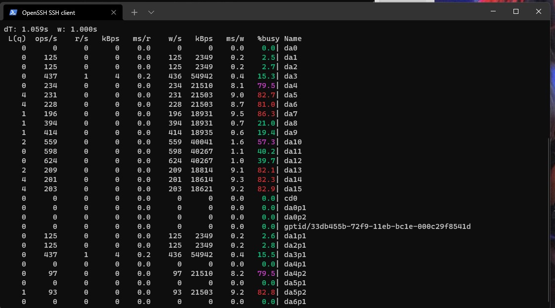

So here is the picture after running the same load test. Primarily it is hitting da3 (which is the newly configured l2arc) and after it flushes to the drives thus the high busy time across the other drives. That busy time is extremely small and was difficult to capture. The latter picture is the gstat when streaming a game with high latency and almost 100% drive usage as reported by windows. Another curious question is that it does not seem to be using the l1arc at all as I don't get any bursts of speed or anything.
