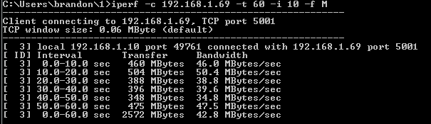

iperf
If you want me to try a different DD test file (bigger, smaller, buffer size change) please let me know and ill post the results. Unfortunately after reading so many of the problems, 7/10 times its a cable or a non-intel nic. Ive tried changing the Ethernet cable and both nics are intel...

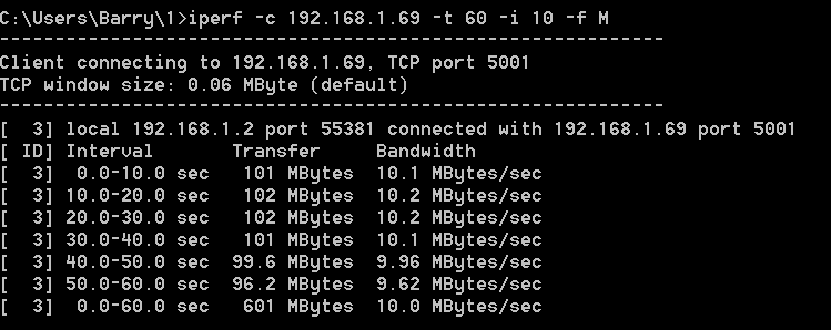

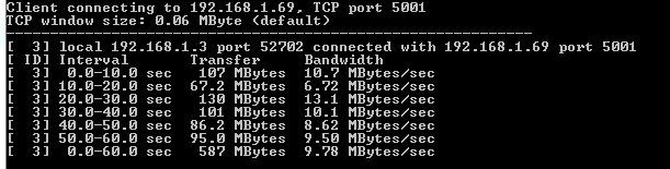

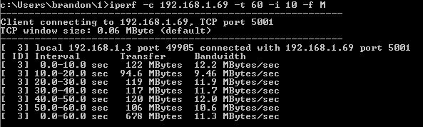

IF config
Wired connection #1 (9' cat 5)
Wired connection #2 (about a 80' cat 5)
High speed wireless cable
currently unable to get to the powerline adapter. not sure what else i can do to test this.
Side note: is windows 8 better than windows 7 for this kind of stuff? would upgrading help the situation?
thanks!!

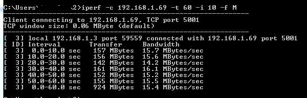

Test on raid 3 volume windows cif
[root@freenas /mnt/drive]# dd if=/dev/zero of=./tempfile bs=4k count=1000k
1024000+0 records in
1024000+0 records out
4194304000 bytes transferred in 16.405418 secs (255665782 bytes/sec)
Test on Strip single drive windows cif
[root@freenas /mnt/Test]# dd if=/dev/zero of=./tempfile bs=4k count=1000k
4194304000 bytes transferred in 28.591567 secs (146697241 bytes/sec)
iperf test to strip drive
cyberjock
Inactive Account
Mar 25, 2012
19,525
See, that dd test is 255MB, sec. That pretty much validates that your pool can perform at far more than 1Gb speeds. So your limitation is certainly your network.
cyberjock
Inactive Account
Mar 25, 2012
19,525
Ug.. you edited your post and added details...
So your first test looks like its capped at 100Mb.. so you need to figure out where your limit was there.
Your test #2 is a mess. Not sure what is going on there. You should go check your cabling and network switches to see what is up. Something is wrong there.
#3 is pointless. Wireless can vary widely from second to second and there's no point in even doing tests over wireless.
Powerline adapters just suck. Almost as bad as wireless, but usually somewhat vaster than wireless.
In short, if you are using powerlines or wireless(anything except rj-45 cat5 or cat6 cabling) between any 2 points expect to artifically bottleneck yourself and have disappointing speeds.

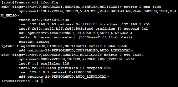

Ok.. and 100Mb LAN maxes out at 12MB/sec(before overhead). I'd say check your LAN connections. Just because you've transferred stuff from your hard drive at 45MB/sec doesn't mean that the connection from your server to your LAN isn't 100Mb because of a bad cable or something.
I'm sorry, far more than a coincidence that you are ending up stuck at 11.3MB/sec. I've been around here long enough to know better!
Post the output of "ifconfig".
