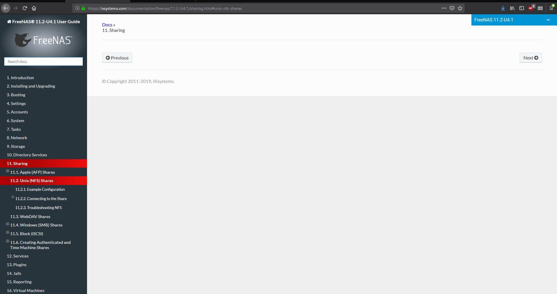

Just having some setting up glitches with shares so went to look in guide and the entire sharing section seems to be missing in HTML guide, it appears OK in PDF version though.
All other sections seem to appear OK in HTML version just sharing section.

I just tried that URL with Firefox, and it worked for me. It looks like you are using Firefox, too. Does the page appear if you force a cache reload with Ctrl-r?
Browser add-ons like Javascript or ad blockers might cause problems, although we have not heard about any troubles with those up to now, and have not added or changed anything in the HTML version that would be a problem. As far as I know, anyway.

Turn off your add-ons
via
May 11, 2019
11
Apologies, yes it was me, turned out to be adblock plus, disabled and shows up fine, weird how everything else worked though, must be some trigger word in there.

If you can get it to tell why it was blocking that section, it might be useful. Can't recall if Adblock Plus has a way to report false positives. I switched to uBlock Origin quite a while back.
via
May 11, 2019
11
Shows 2 items blocked, I have reported it as false positive, these are the relevant lines from that report...
  <filters>
    <filter text="||googletagmanager.com/gtag/$third-party" subscriptions="https://easylist-downloads.adblockplus.org/easyprivacy.txt" hitCount="2"/>
    <filter text="###sharing" subscriptions="https://easylist-downloads.adblockplus.org/fanboy-social.txt" hitCount="2"/>
  </filters>
Full report link.. https://reports.adblockplus.org/1418a254-5c3f-4c47-a0b9-cfb0eedb926d
