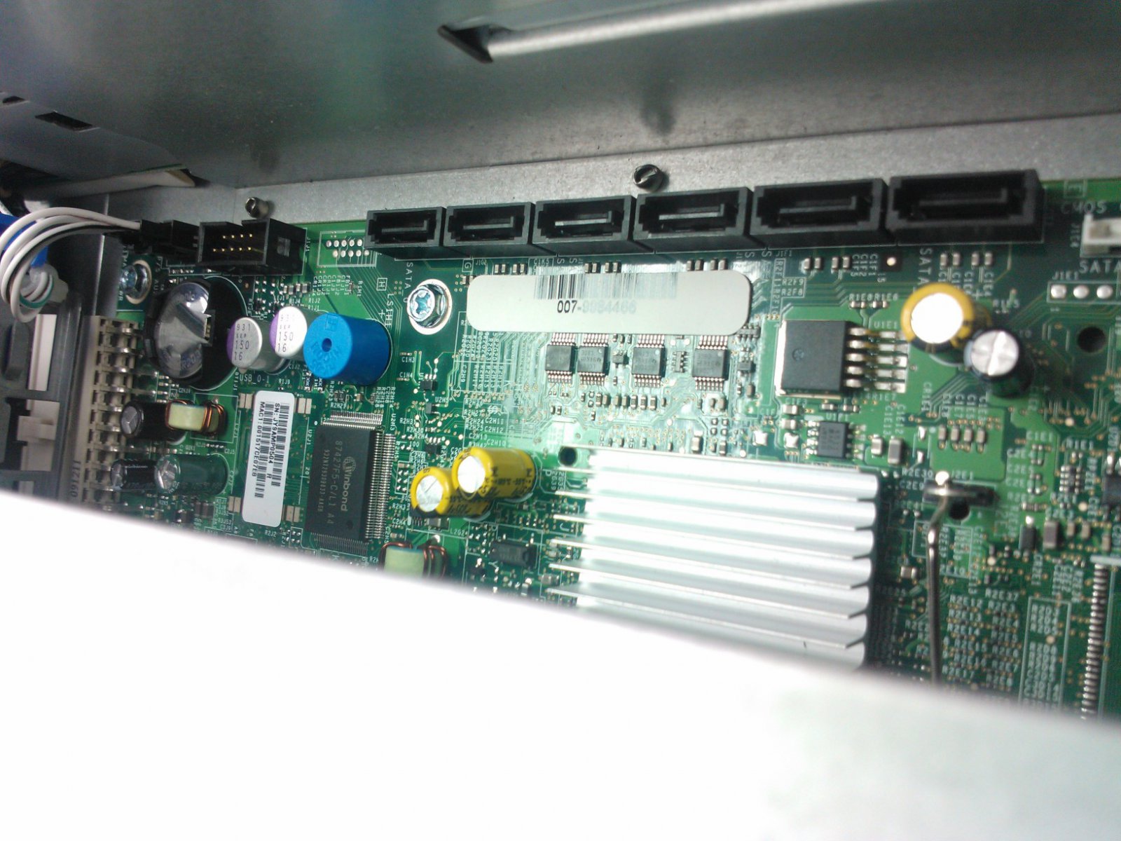

I've got a confusing situation I'd like help with regarding backplanes, midplanes, SATA and SAS drives...etc. I have two INTEL SR2500's. One with a SATA backplane and the other with what I think is a SAS midplane as it seems totally different to what was refered to as the backplane on the other SR2500.

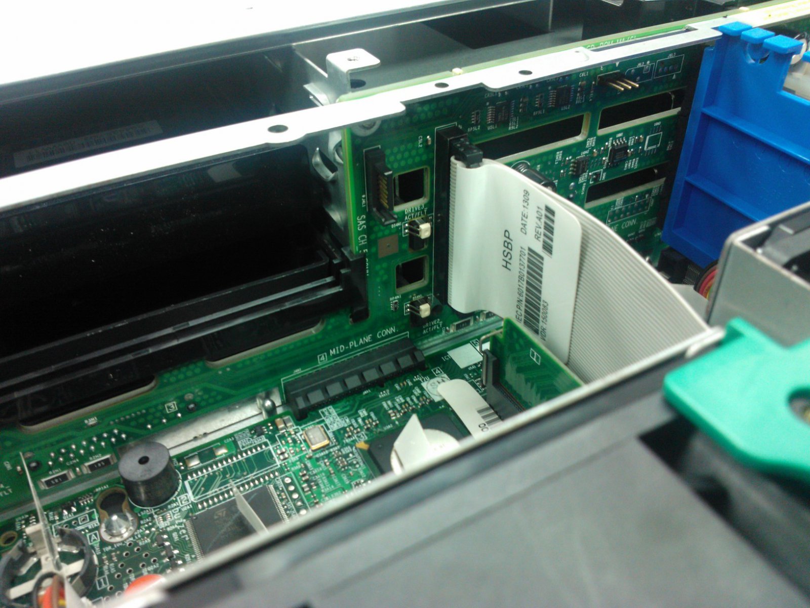

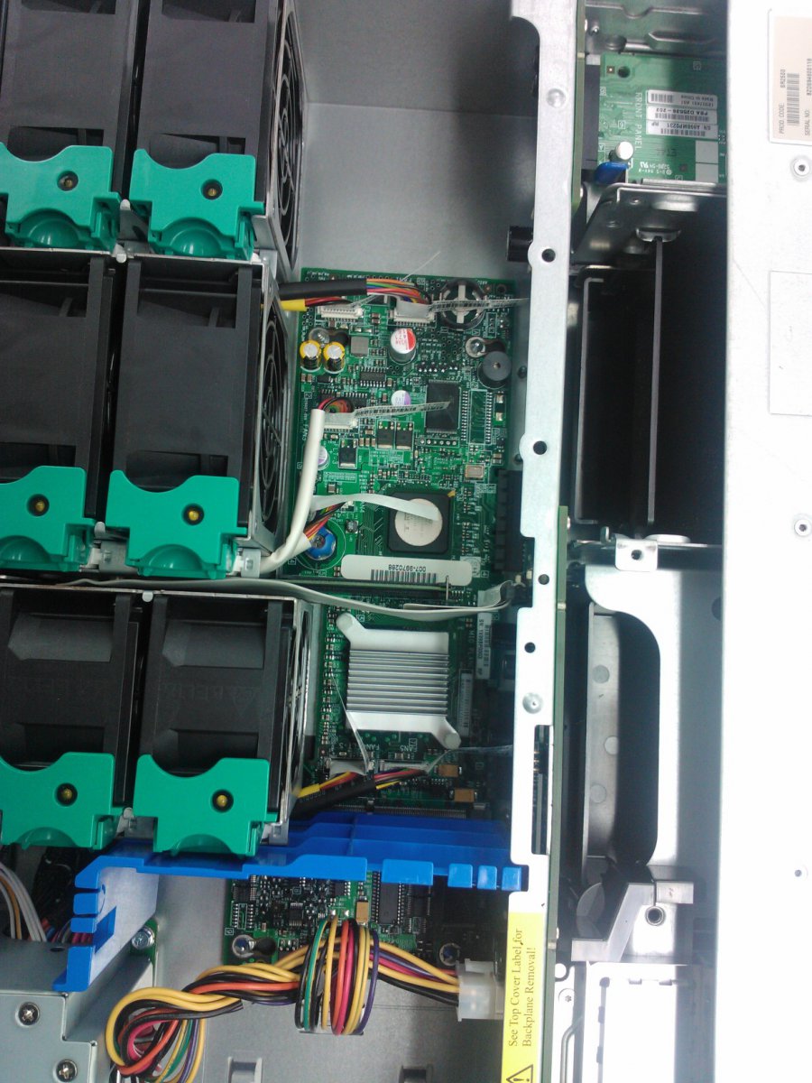

The current SR2500 has a SATA backplane where one side has media connected and on the directly opposite side is the data cable connector in order for the cable to be connected to that particular drive and corresponding port on the board or RAID card. On the NEW SR2500, I have several bays with a what looks like a SATA backplane, but there is also this device called a "midplane" which does not actually allow me to connect any SATA devices to it. It looks as if there is one SATA connector on the rear of the backplane. I'm not actually sure what the midplane is designed to do.
I've got a funny feeling I have a SAS backplane with a midplane in the middle. I was thinking...I could transplant the new motherboard from the new SR2500 in to the older chassis with the SATA backplane in order to achieve the same setup I have right now. Or perhaps the backplane from the old chassis in to the new chassis in order to do the same thing again. Not sure if it would work since they are two different models.

I've just realised that even though I have nothing at all attached to the SATA ports on the motherboard, the test drive I have in a caddy will be detected no matter what caddy slot I have it inserted in. I've got a feeling that midplane has something to do with it. It makes me a little worried. I have no idea where to get one and it is a single point of failure that I can't really account for. If the board goes, I can replace it reletively easily.
Would butchering the old and switching the backplane out still work, even if I removed the midplane SAS/SATA interface and simply used the SATA backplane as an adapter to attach the media to the board? I'm such a n00b with this stuff.

Search the forums for the recent midplane discussion we had with a different user.
The midplane is probably an SAS expander. I can't make out what's going on with your picture.
