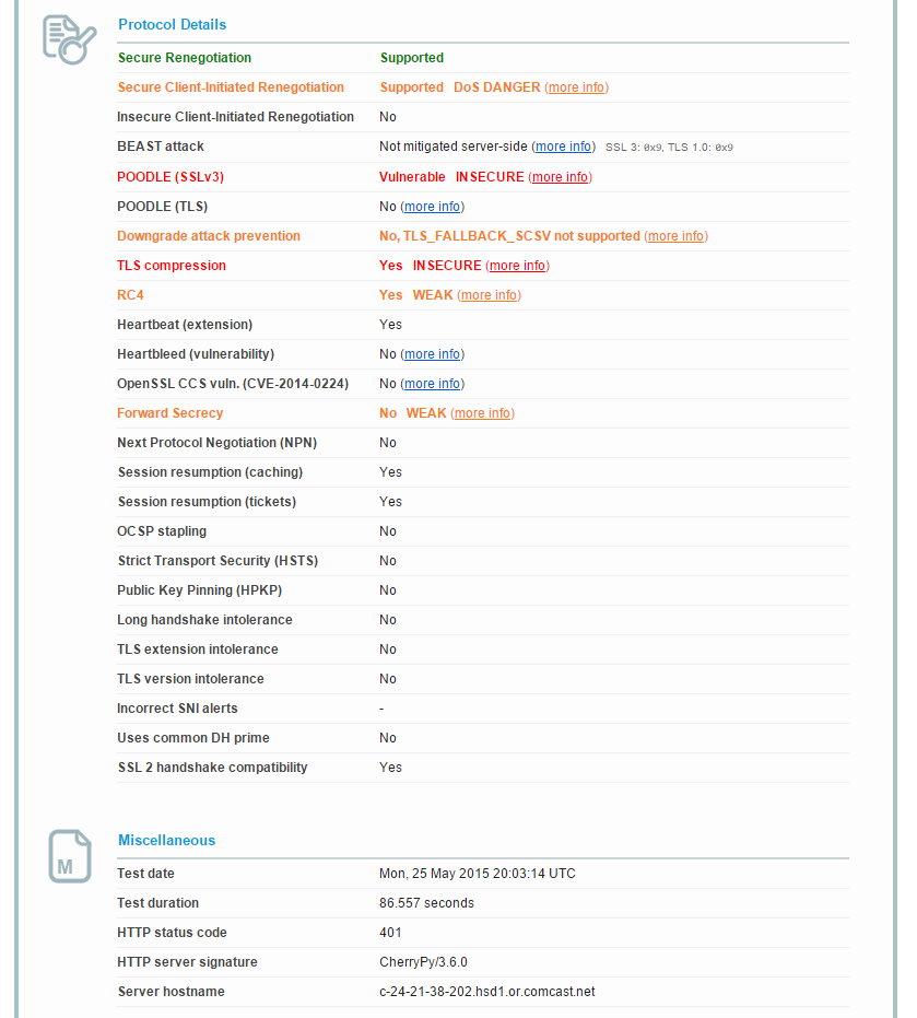

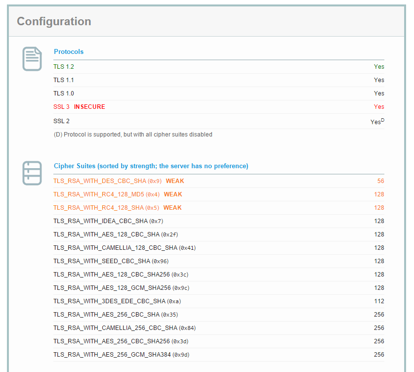

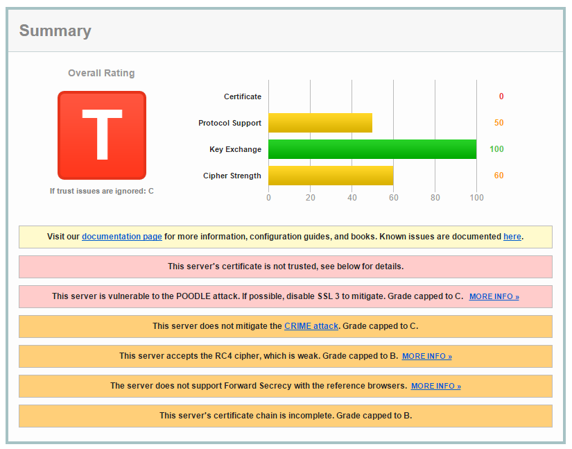

Attached are three screencaptures of the Qualsys report for Headphones. The main issues are:
* Vulnerable to CRIME attack. Need to shut off TLS compression
* Accepts weak ciphers: TLS_RSA_WITH_DES_CBC_SHA, TLS_RSA_WITH_RC4_128_MD5, TLS_RSA_WITH_RC4_128_SHA
* Does not support Forward Secrecy
* Vulnerable to POODLE (Need to disable SSLv3 support)
* Vulnerable to DoS attacks due to Client-Initiated renegotation support
Does anyone have recommendations on where to begin in resolving any of these issues, especially disabling SSLv3, RC4, and TLS compression?
