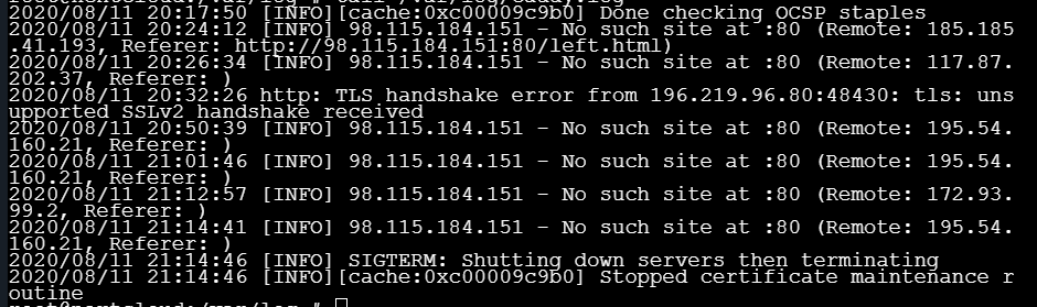

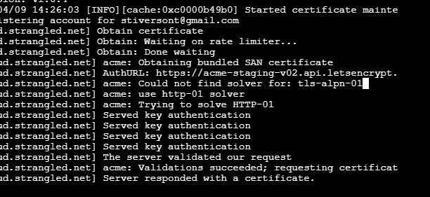

all the dates in that log are only showing 4/9 original from what I see, it did show successful and "done" at the end of the below log. Doesn't look like it tried to renew???
=====line 1 col 0 lines from top 1 ============================================
2020/04/09 14:26:03 [INFO] Caddy version: v1.0.4
Activating privacy features... 2020/04/09 14:26:03 [INFO][cache:9b0] St
2020/04/09 14:26:09 [INFO] acme: Registering account for stiversont@gmail.com
2020/04/09 14:26:09 [INFO][.net] Obtain certificate
2020/04/09 14:26:09 [INFO][s.net] Obtain: Waiting on rate lim
2020/04/09 14:26:09 [INFO][.net] Obtain: Done waiting
2020/04/09 14:26:09 [INFO] [.net] acme: Obtaining bundled SA
2020/04/09 14:26:09 [INFO] [.net] AuthURL: https://acme-stag
2020/04/09 14:26:09 [INFO] [.net] acme: Could not find solve
2020/04/09 14:26:09 [INFO] [.net] acme: use http-01 solver
2020/04/09 14:26:09 [INFO] [d.net] acme: Trying to solve HTTP
2020/04/09 14:26:09 [INFO] [d.net] Ser

I get Service caddy is running, below was the response from Tail command. I am still seeing port forwarding on.
here is the snip of the caddy.log. Cut and paste was cutting it all off.
