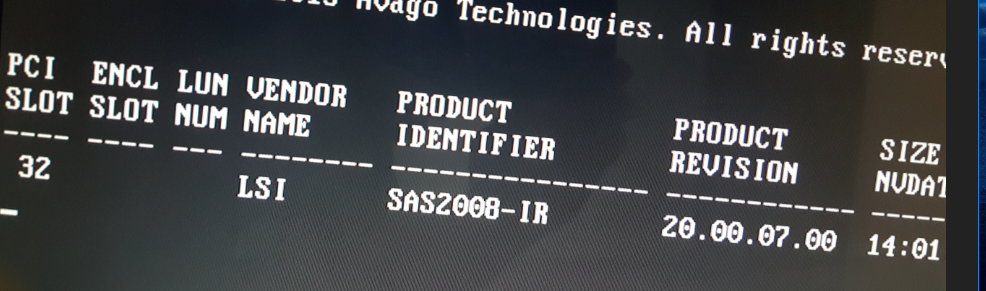

Here is a shot
15,504
Ah, I'd missed that. No, if it says IR on boot, it's probably in IR mode. This isn't a critical problem--if you don't set up anything in the BIOS and just use FreeNAS to manage your disks, you should be fine. However, it is better practice to have it in IT mode.
How you've done it I don't know, but you do appear to have downloaded a much older firmware than you intended to. This link should be the most current package.
I attached the zpool drives to it and freenas read them fine threw the sas, so I think I can leave as is. what do you think dude?
