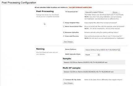

Thanks. Do you see any problems in these configuration screens?

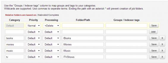

I apologize again, but I'd really like to solve this folder issue while I still have some spare time (xmas!). The way I understand it ( but please correct me if I'm wrong), there are THREE sets of folders that are used.
  • After sickbeard pushes the desired show info to sabnzbd to find the nzb and download it, sabnzbd first downloads the different parts (e.g. the rar-files) to the FIRST folder named 'incomplete'. In my case that is /Sabnzbd/Incomplete.
  • Once complete, sabnzbd then processes all those temporary files: it repairs them if necessary and possible; and then unpacks them to the SECOND folder, which is called 'complete' (in my case /Sabnzbd/Complete. Since I have assigned the category 'tv' to these shows in sabnzbd 'Categories' section, these files end up in the folder /Sabnzbd/Complete/TVShows. It also automatically creates subfolders for every show with the name of the show.
  • Finally, sabnzbd then runs the python script (sabToSickBeard.py) which sends a signal to SickBeard that it should continue post-processing by renaming the files based on the pattern specified by us in the Post-Processing and Naming sections of the Post Processing Configuration in SickBeard config. That is how they should end up in the THIRD and final so-called 'show folder', which is what things like xbmc or plex can then use. In my case that's /TVShows (which is different - 2 levels higher - from the /Sabnzbd/Complete/TVShows!)
Where I must still go wrong now is in which one of the folders has to be entered where. Here is the error message I still get
 Loading config from /mnt/plugins/pbi/sickbeard-amd64/SickBeard/autoProcessTV/autoProcessTV.cfg
Opening URL: http://localhost:8081/home/postprocess/processEpisode?nzbName=Name_Show.nzb&quiet=1&dir=%2FTVShows%2FName_Show
Processing folder /TVShows/Name_Show
You're trying to post process an episode that's already been moved to its show dir
Can anybody please tell me where I am still making a mistake? I would really appreciate that!

The way you explained it is almost exactly correct, though i would change this line.. "It also automatically creates subfolders for every show with the name of the show." too.. "It also automatically creates subfolders for download in the specified category folder", sab doesn't know or care about what show is what, it just downloads files and makes a folder for each download.
It seems as i you entered /TVShows into sickbeard's 'TV Downloads Dir' but this obviously isn't the case.

I understand this must be frustrating for you. But believe you me, I have searched both this AND other fora for hours, but the problem is that a search also yields a lot of inaccurate results (people posting wrong configurations - as I have done here in this thread a few times; results for Windows instead of FreeBSD, etc) and that it's not easy to find 'authoritative' answers. And this thread IS indeed extremely unwieldy, as I suggested before. A FAQ with links to 'authoritative' answers (like the ones you refer to in your last message, but without a link) would therefore certainly help. And couldn't you, for the time being just add that to the first message in this thread?
Now on my issue here:
It's not clear to me what you're suggesting here and what I should do. My "TV Downloads dir" ("The folder where your download client puts TV downloads.") in SickBeard right now is set to/Sabnzbd/Complete/TVShows. And that IS indeed where sabnzbd puts the files after repacking them (and before deleting them again and sending them on to the /TVShows folder). So are you suggesting that I should change my 'TV Downloads dir' to /TVShows, or that this configuration is correct but doesn't seems to be working? Here is what my SickBeard config.ini says
cache_dir = cache
root_dirs = 0|/Sabnzbd/Complete/TVShows
tv_download_dir = /Sabnzbd/Complete/TVShows
keep_processed_dir = 0
move_associated_files = 0
process_automatically = 0
rename_episodes = 1
create_missing_show_dirs = 0
add_shows_wo_dir = 0
Can you please specify what exactly is wrong here and how I can fix it?

I suggested that what you had entered was correct and the error message you were getting didn't seem right compared to what configuration you had showed earlier.
EDIT
I checked my sickbeard config (mind you this is on a freebsd jail on pfsense not freenas) and this is what I had (though this was all generated from the gui)
root_dirs = 0|/mnt/media/videos/tvshows
tv_download_dir = /mnt/media/downloads-complete/tvshows
notice my root_dir (which i believe is set when you choose where to put your tv shows) is not the same as my tv_download_dir
when you added your shows in sickbeard did you choose '/TVShows' (in your case)
You might want to look into sickbeard's home > addshows
maybe backup your data folder then go into sickbeard and change the default folder for shows to '/TVShows'
remember sabnzbd complete folder is category/download while sickbeard is organized by tvshow
