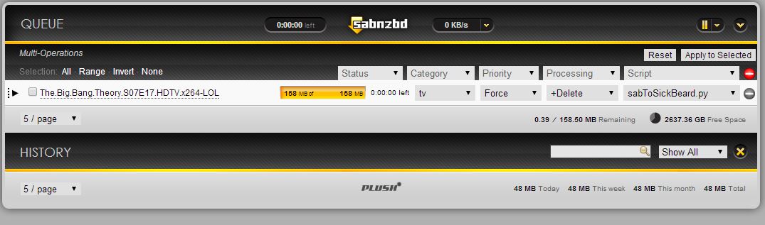

I cannot get SABnzbd to transfer a completed downloaded TV show to Sickbeard.
Sickbeard instructs SABnzbd to start a download fine and the download completes but it just sits in the incomplete folder. (see attachment)
I have SABnzbd and Sickbeard installed on different IP addresses / different FreeNAS jails. All Jails shared the same storage /mnt/Media.
I have configured SABnzbd to use the sabToSickBeard.py script. The post processing isn't working correctly.
Can sombody please help?

how can sabnzbd see the script if they are in different jails?

To me, it looks more like the download isn't actually finished, rather than sabnzbd not being able to access the script. Typically, when it can't access the script, it will move the entry down into the 'history' section and show that it had an error attempting to execute the script. Instead, it shows that there is still 0.39MB / 158.50MB left to download. I'm not sure why it's not finishing it, but maybe the logs will help point you in the right direction.
