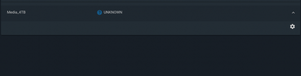

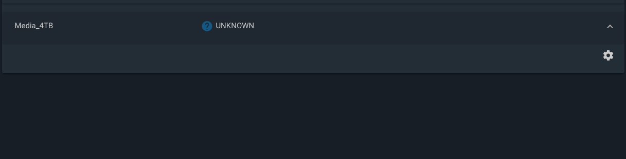

one of this, Pool Media_4TB = HD WD RED 4TB, I have extended this with another same disk ( to have an 8TB pool ) and the operation finished successfully.
Today the Pool is in an UNKNOWN state and I only see the first disk . The new disk doesn't work, it's dead.

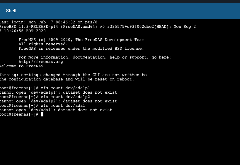

I have try with ZFS MOUNT but i have this error "dataset does not exist"
How i can fix?

dev/ada1 is not the same as /dev/ada1 (unless you first cd to /)
Second...
zfs mount has little to do with what you seem to need right now.
What would be helpful to see is the output from zpool status -v Media_4TB

if i use zsh mount / dev / ada1 i will received this output
cannot open '/ dev / ada1': leading slash in name
after searching on google, haved found a suggestion of a user that tell removed the first slash. i tried without / before folder dev with the result of the previous post.
Maybe you meant zfs mount... in any case, I already said that command has little to do with solving your problem, so I won't address its correct use here.
@sretalla's already mentioned that neither this, nor anything like this, is a reasonable command to be using, but also be aware that the spaces you're adding are going to break things. / dev / ada1 is not the same thing at all as /dev/ada1.
spaces have been added by copy and paste of the web console. As you can see in the screens of the first post, the command is without spaces. The first attempt was zsf mount /dev/ada1 getting the slash error, searching the web a user said to remove it. The second attempt was with zsf mount dev/ada1 getting the other error. But let's not talk about this anymore because we have ascertained that it is not useful for resolution.

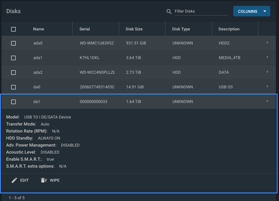

And ada1 was the original disk in that pool? That's bad news, but not the immediate issue. Edit: never mind; I was confusing ada1 with da1. So the question is, what is da1? If it's the new disk, that's at least part of your problem. Does the new disk show up in Storage -> Disks? If so, which pool does it say it belongs to?

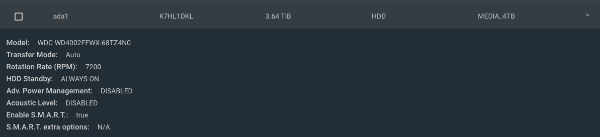

My guess... da1 is likely the USB attached disk. ada1 is likely the SATA attached disk still in the pool.
15,504
That's my current guess too, but the show disks screen would tend to confirm--and would also indicate if the USB adapter was messing with it in some way (e.g., by masking a serial number).
9,700
You can see the show disk details for ada1 in the first post already. I guess the outstanding io is preventing da1 from showing up...

HD that does not work I connected it via usb and now he sees it under da1 but only 1.64TB of 4TB
15,504
Yes, as expected, the USB bridge is messing with it--you can see it's also reporting an incorrect serial number. That kind of foolishness will mean that you won't be able to bring the pool online with the disk attached that way (or at least using that adapter). If you plug it back into a SATA port, will it show up now?
