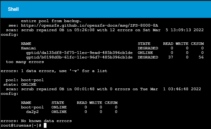

These are the results of my ZFS list and Zpool status

i am a bit confused why it looks like your pool should be completely dead but you are getting a zfs listing of the datasets.
if you have a pool in the webUI, make a READONLY share for it, and try to copy anything you can off of it?

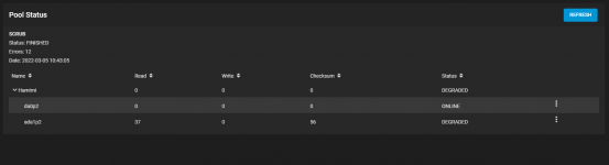

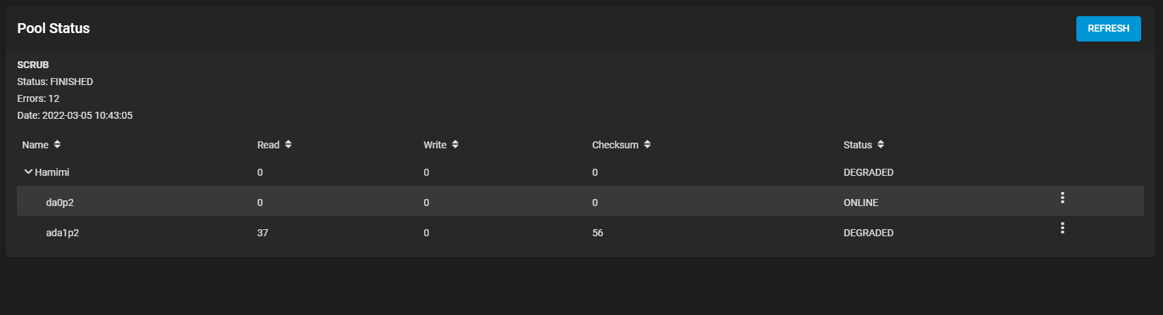

How can I do it? This is the pool status I have now (attached).

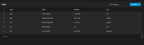

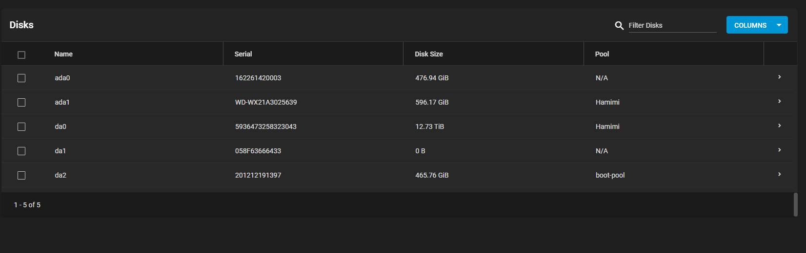

Seems like my biggest HDD (main drive) status in the pool is ONLINE! How can I copy that? Can I access it and copy the data to somewhere else?

Problem solved. I just added the drive using the windows shares (and also added a user before) and was able to add the drive using the Windows Map and it worked. Thanks all.
