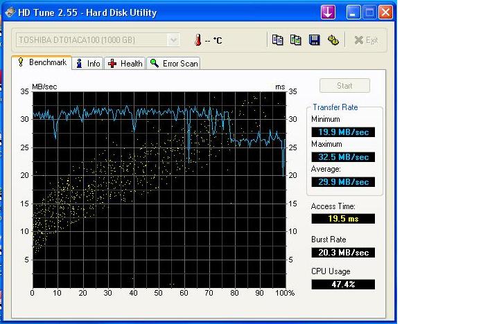

Yeh I was happy with the other WD Greens and its odd that the replacement drive appeared to fail also? I switched of my NAS removed the HDD and plugged it into a USB Ext HDD enclosure to run some tests. Fired it up and got the normal spin up and access noises and NO clunking. Windows XP picked up the drive fine (clearly cannot see any data as its a FreeNAS Disc. Ran HD Tune and the screen shot is attached - seems fine.
Could it be a dodgy Motherboard or PSU?

Sorry forgot to add the attachment.
HDTuneToshiba_zpsc9941cd3.jpg.html

I don't care about benchmarks. Those don't tell you if something is wrong with certainty. SMART, on the other hand, was designed for just such a purpose.
