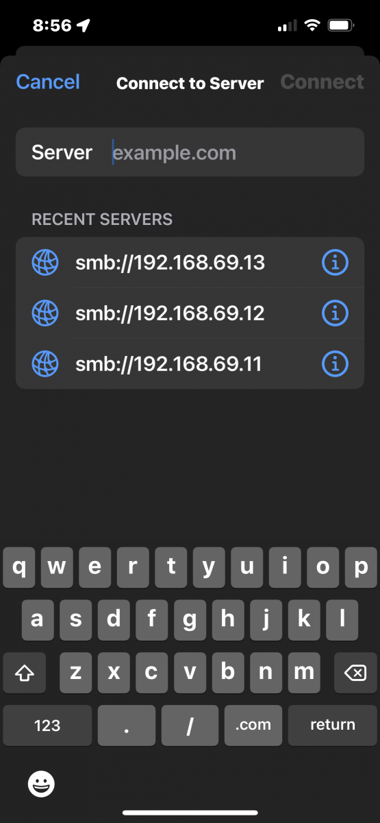

You can simply prefix the LAN IP address of your NAS with smb://{IP address}
On iOS you can use the built in Files app. You will need to find an equivalent Android app if File Manager+ does not support SMB
