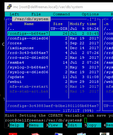

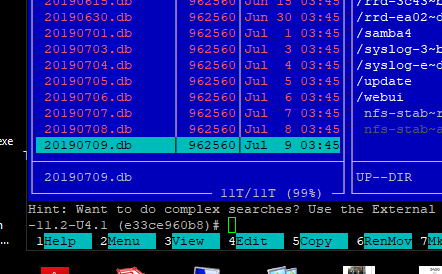

Redcoat
Feb 18, 2014
2,922
If the system files were on the pool, the config would be backed up daily to /var/db/system/configs-***_very_large_number*** Drill down until you find the latest .db file. Here's a snip from one of mine using mc:

Redcoat
Feb 18, 2014
2,922
mc is Midnight Commander (comes with FreeNAS) - it's a convenient way to navigate the directory structure and look for files.
