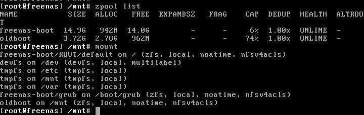

I am trying to do the same thing, but I get the following error when trying to mount da1s4 no such file or directory. I am trying to recover a 9.3 configuration. Any help to recover a 9.3 config would be much appreciated. I see /dev/da1, /dev/da1p1, and /dev/da1p2.
bigshow
Nov 29, 2014
4
I assume the issue might be that the OS is using zfs. Is there a way to mount the old zfs OS usb to copy freenas_v1.db?
Bidule0hm
Server Electronics Sorcerer
Aug 5, 2013
3,710
bigshow
Nov 29, 2014
4
Thanks for the help. I am able to import and mount the old zfs usb, but nothing is in the mount directory. I get no errors after mounting and I am able to unmount just fine, but the directory is empty where I mount. The zpool list command shows the oldboot allocation so there should be files there. Could there be a permissions issue on why I cant see the files?
Bidule0hm
Aug 5, 2013
3,710
Interresting...
You've mounted it with another name than freenas-boot, right?
Also, are you connected with the root user?
bigshow
Nov 29, 2014
4
Yes, its named oldboot and as root.
Bidule0hm
Aug 5, 2013
3,710
I'm puzzled...
If you go to /mnt/oldboot and do a ls -la what's the result?
