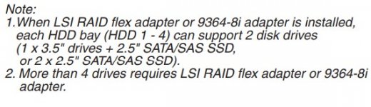

Do you mean there are not enough drives in the box to connect to two storage controllers?
Or this motherboard does not support running two controllers at the same time (that I really doubt)...?
A H330 HBA (and some others) has the same connectors as your flex adapter.
So, you could simply disconnect the cables from the flex adapter and connect to the H330...
I don't know what the other end of the cable is.
Since it is capable of accommodating SAS and SATA drives, I suspect it's some sort of a backplane...

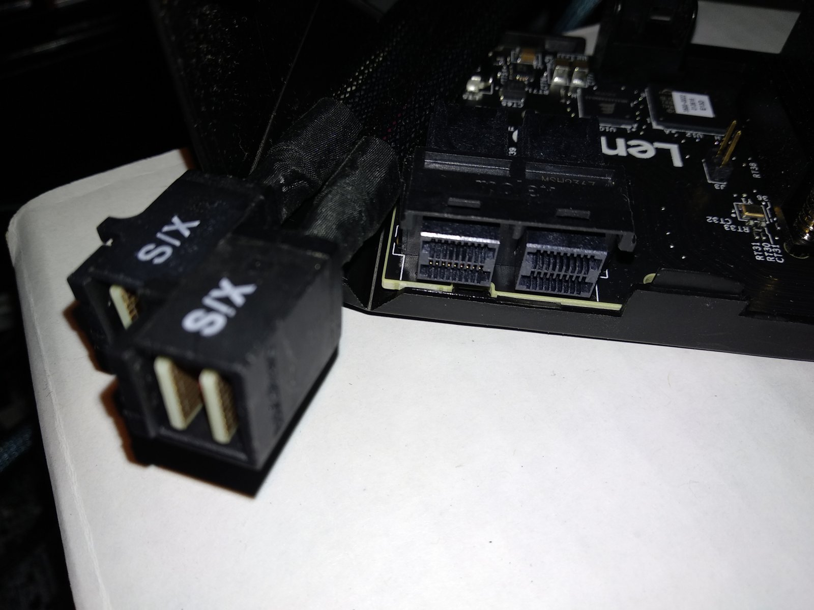

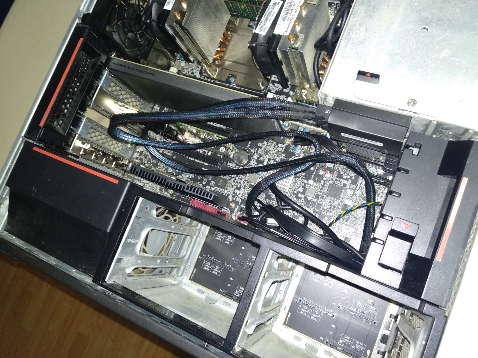

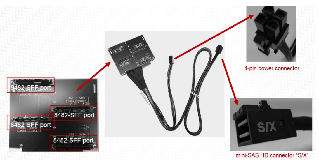

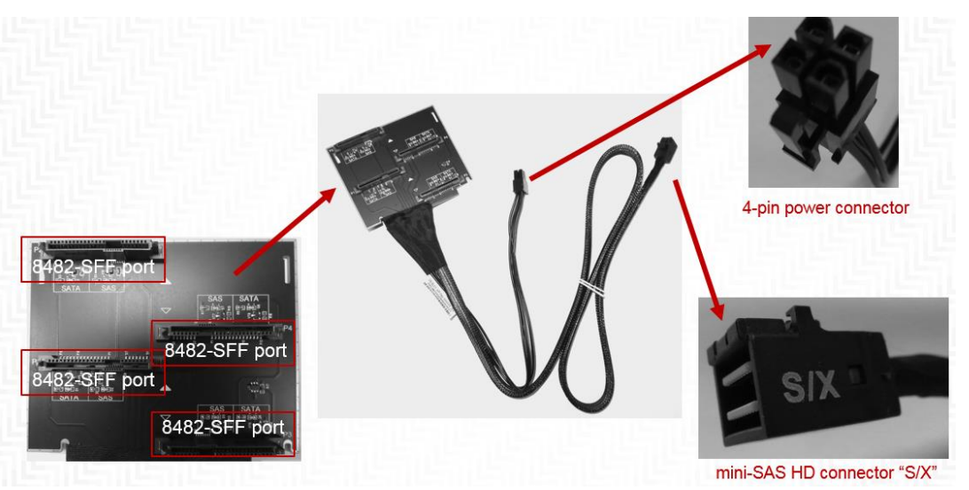

I never thought of that, I just spent $50 on SATA power cables. Looks like the IBM M5110 cannot direct connect. Will the 530-8i work for me? I found a good deal locally.
Yes, it should.
Both, the flex adapter and the 530-8i use a pair of SFF-8643 connectors (your first picture).
And it does end on a backplane (your second picture), so you'd need something like this (standard cables won't work)...
Drives that you install in the 5.25" slots can be connected to on-board SATA connectors with standard cables...

would it be best to install them in RAID5 because of my 4 Bay limit?
Die-hard TrueNAS/FreeNAS users would say you need RAIDZ2 (aka RAID6). I think RAIDZ1 over 4 drives should be ok...
Looking at the backplane, you can have 4 drives per bay, i.e. 8 drives total. And it can even handle U.2 drives.
There are probably restrictions what size (3.5" and 2.5") and type can be installed at the same time...

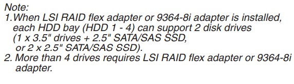

I don't know how 2 x 2.5" SATA/SAS SSD is possible without a 3.5" to 2.5" drive adapter. I can get a good deal on 4TB 2.5" SAS SSDs that I am considering using on my 2nd P700 with Proxmox.

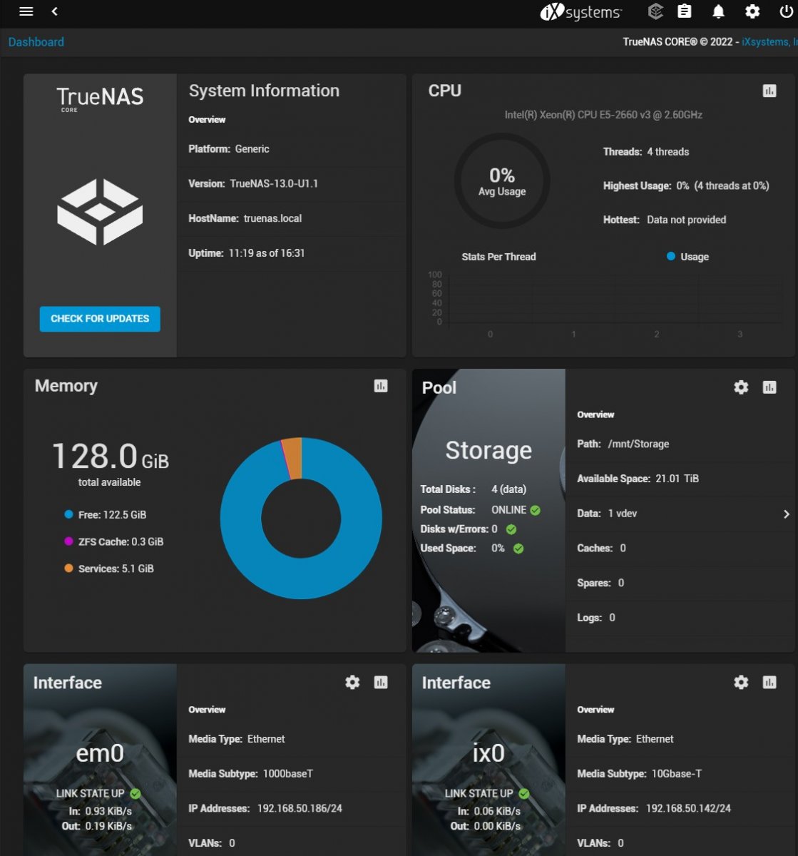

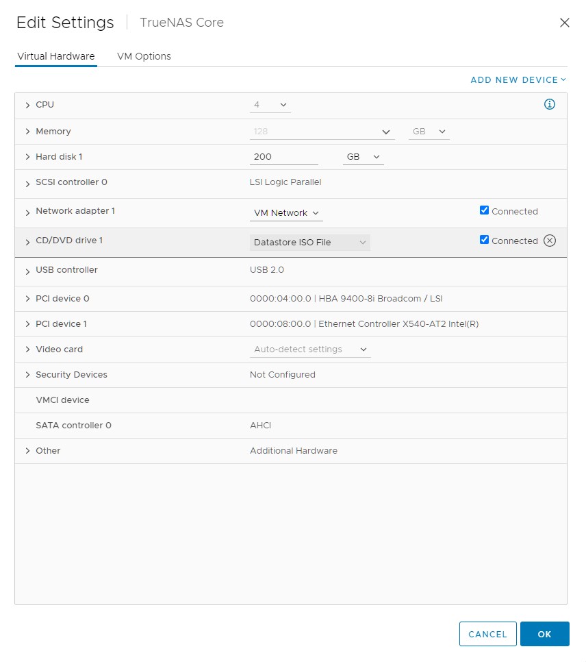

I couldn't figure out how to partition the boot drive, maybe diskpart or vcenter. I installed ESXI and on a mirrored Dual M.2 SATA to 2.5" RAID adapter. I read ESXi doesn't support RAID with my onboard SATA controller. Installed a separate 750GB SSD for VMs. 64GB to ESXi, 128GB to TrueNAS Core. I seemed to have passed the HBA successfully and created a Raid-Z 4 x 8TB. I also passed 1 port of my x540 NIC. Let me know if you see anything wrong and things I need to consider.
