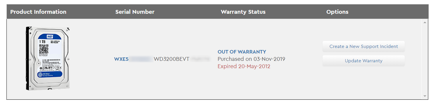

I already have a bad taste in my mouth by dipping my toes in Western Digital's warranty website. I registered a laptop drive (WD Blue), that I purchased from Amazon in November 2019. If you view the attached image, you might conclude I traveled through time!
Seriously, why would it even claim that my drive's warranty expired seven years before I purchased it?
* Yes, I double-checked the serial number, and it matches exactly. I blurred it out in the image.
* I have not yet registered my NAS drives. I'm already disliking the process.
UPDATE: Is someone manipulating the serial numbers? Is there a risk to ordering WD drives from Amazon? I just entered another drive's serial number, and not only does it claim the warranty expired in 2011, but that it is an external drive (even though it's an internal drive.)
