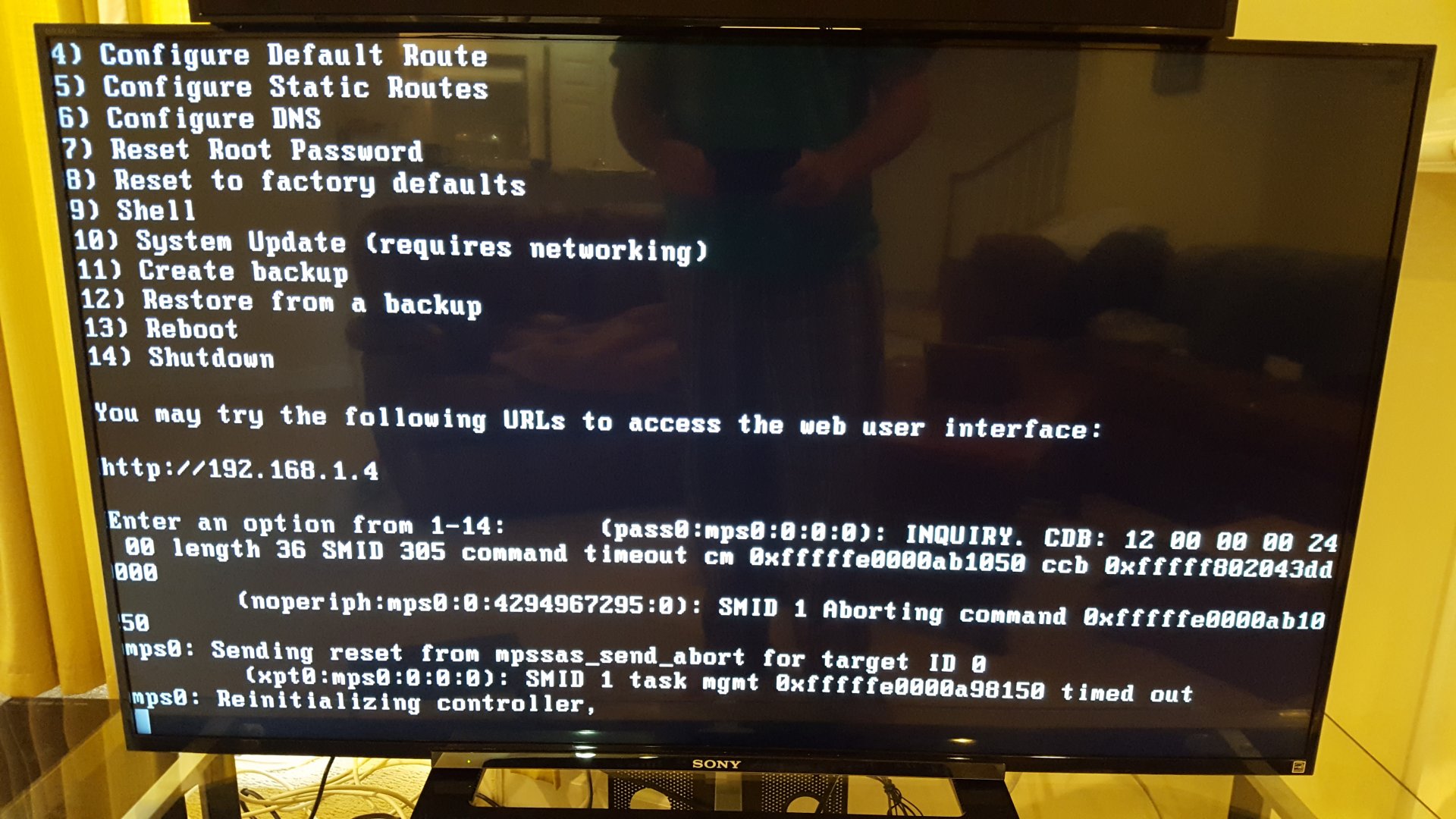

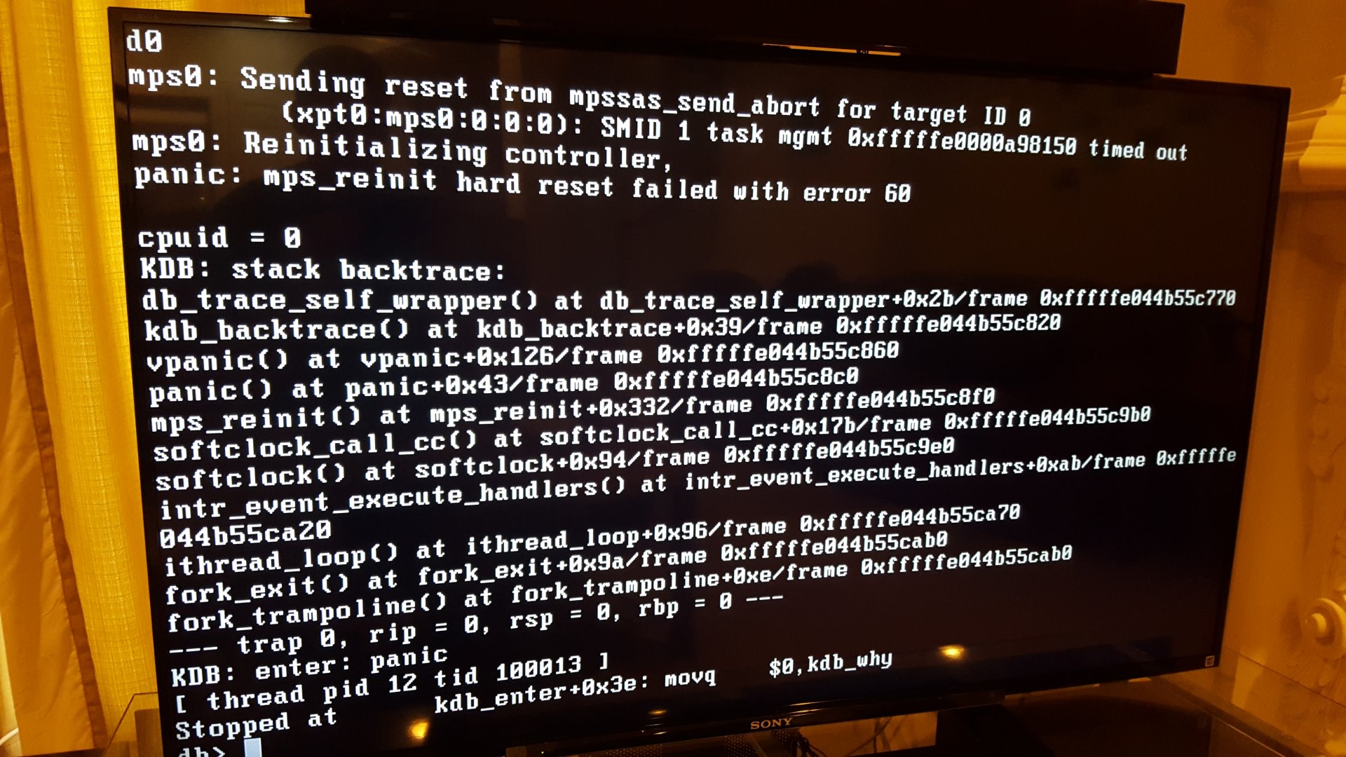

so i managed to catch some errors before restarting.
Any ideas?

depasseg
FreeNAS Replicant
Sep 16, 2014
2,874
MPSSAS is the disk controller. Looks like there is an issue with that. Have you installed a driver recently, or is this a stock out of the box installation?
toyebox
Aug 20, 2016
87
it's a fresh out of the box system now. i reinstalled to check that off my list. just happened again 10 minutes after being on. doing absolutely nothing. I am using an m1015 flashed to IT mode.
depasseg
FreeNAS Replicant
Sep 16, 2014
2,874
Given the troubleshooting that you've done so far, if it were me, I'd pull the card out and see if the reboots stop. It's possible you have a faulty or counterfeit card.
toyebox
Aug 20, 2016
87
I don't want to speak too soon but... I think i have identified the issue as being a super hot chipset on my LSI raid card. through a little fan on it for temporary use to see what it would do.. i couldn't even create a snapshot.
right now i just started a badblocks test on all 4 disks. it was failing within the first minute before, freezing all input. still going strong now. I think it has to do with the airflow in the case.
It definitely looks and acts like a legit card. I felt the heat sink on the chipset and damn, it was pretty hot.
