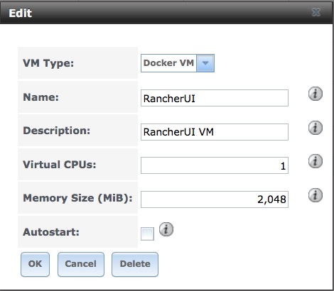

Configured as per the 11.1 U4 Guide instructions.

VM Configuration:

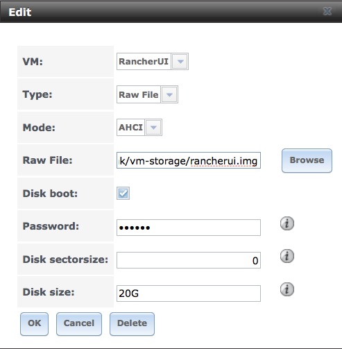

RAW Device configuration:

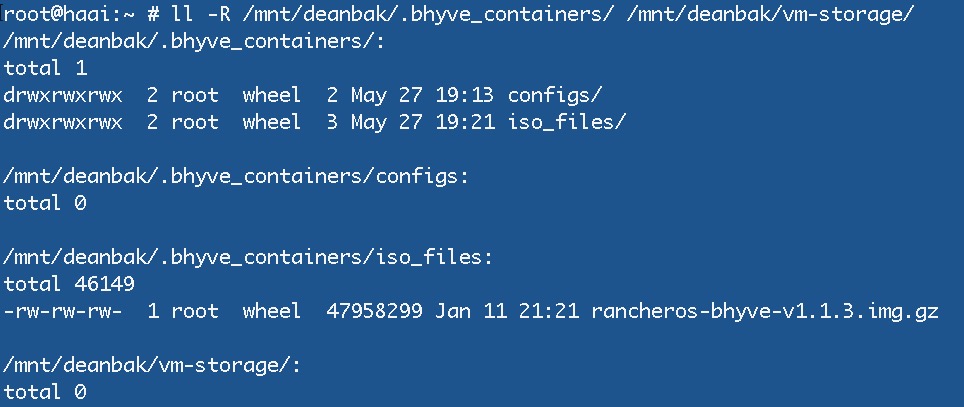

ll -R of .bhyve_containers and vm-storage after attempting a start:
index.php
(I changed the go+w permissions, but it didn't change the result)

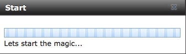

I downloaded the rancheros-bhyve-v1.1.3.img.gz file manually (above) because when I try and start the VM it sits and spins on:
index.php
But if I check from another tab the VM does not appear to start (and does not download the img.gz file):
index.php

Did you solve this? I've never had a rancheros img download failure, but others have. I'd suggest deleting any docker VMs you have created via the WebUI. Then delete any/all img files at the CLI. Then finally destroy the zfs .bhyve_containers dataset. Start the process from scratch and the "start" pop-up window should hopefully show a completed dowload and environment creation message. Remember that any img file you select to use, like rancherui.img, should not pre-exist when you add devices to a docker VM.
It's only after a successful download that the necessary config files are created in .bhyve_containers which will allow the docker VM to boot, e.g:
root@freenas:/mnt/NasPool/VM # ll -R /mnt/NasPool/.bhyve_containers
total 1
drwxr-xr-x  3 root  wheel  3 May 29 10:00 configs/
drwxr-xr-x  2 root  wheel  3 May 29 09:58 iso_files/
/mnt/NasPool/.bhyve_containers/configs:
total 1
drwxr-xr-x  3 root  wheel  4 May 29 10:00 2_docker1/
/mnt/NasPool/.bhyve_containers/configs/2_docker1:
total 1
-rw-r--r--  1 root  wheel  33 May 29 10:00 device.map
drwxr-xr-x  2 root  wheel   3 May 29 10:00 grub/
/mnt/NasPool/.bhyve_containers/configs/2_docker1/grub:
total 5
-rw-r--r--  1 root  wheel  288 May 29 10:00 grub.cfg
/mnt/NasPool/.bhyve_containers/iso_files:
total 46149
-rw-r--r--  1 root  wheel  47958299 May 29 10:00 rancheros-bhyve-v1.1.3.img.gz

Nope, still not working. I’ve tried the “nuke and pave” approach destroying .bhyve from CLI and the vm from the GUI and the same thing happens. I’d love to know if there’s a log file that gives me more information than the asinine “magic” message so I could get a clue as to what’s not working?
