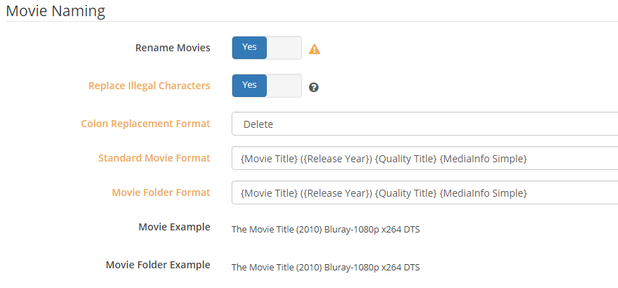

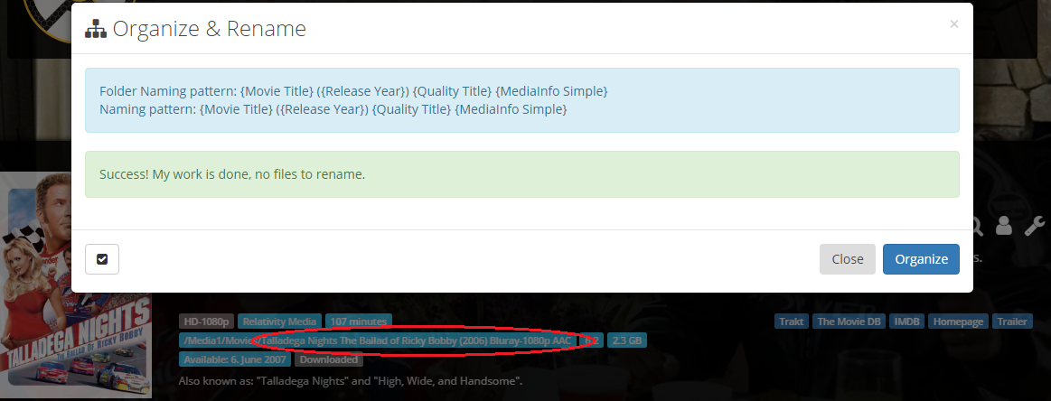

Hi all,
Thank you in advance for your support.
I used the web GUI in freenas 11.2 to install the plugins for radarr, sonarr and transmission. I seem to have everything working fine for all 3 except that for some reason radarr does not add the video codec to the file or folder name when using the rename feature, with any of the {MediaInfo ....} options such as attached photo. It doesnt work for existing movies that I imported or for new movies obtained through radarr. See example of renaming attempt attached, you can see it does everything apart from the video codec type. This is the same for all movies. It works fine in Sonarr for TV episodes with the exact same settings (to my knowledge).
Any advice would be greatly appreciated please.
