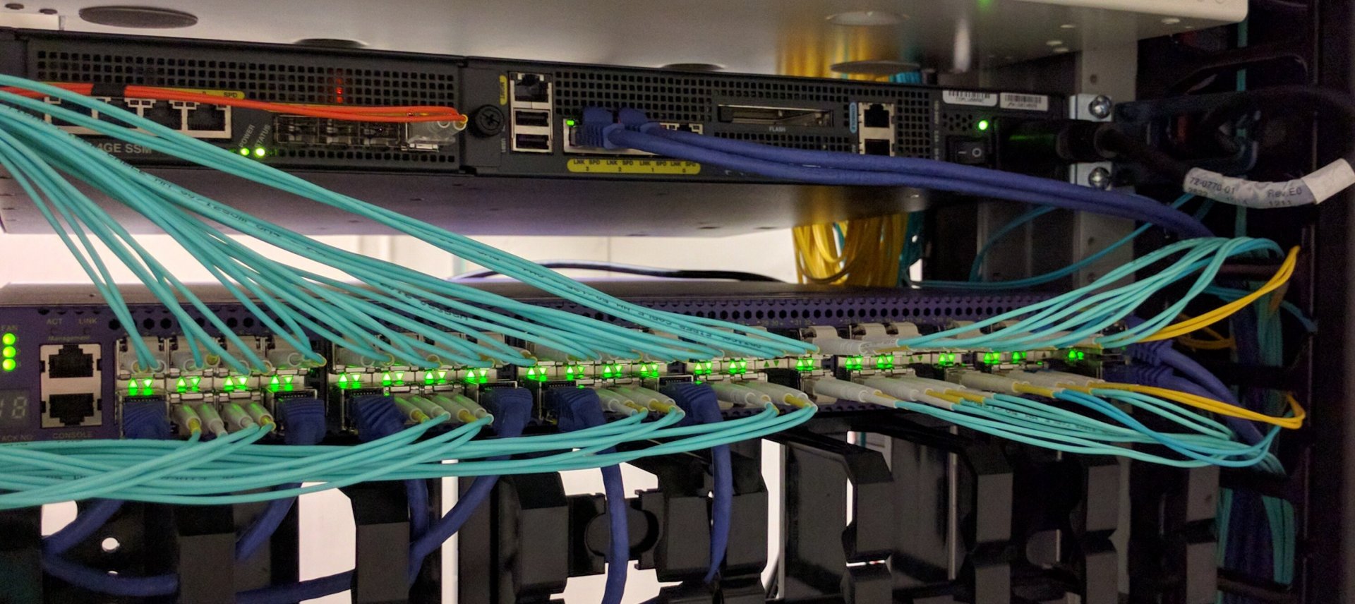

I bought the 2mm cables I linked earlier. The 3mm might be better for an interior inner wall run, but my use is top of rack server connections.

I've got a few Extreme Networks X670V-48X switches ;)
It looks beautiful.:smile:
Well this switch I won't need since I already have 20 port 10Gb switch, but I am always curious how other people are doing things , so I can borrow ideas for myself. If think their implementation is better that what I have of-course.

I see. Perhaps that's how it should be used. Mine looks similar , but it's on the front of the rack and more bending is needed to be able to close the door.
