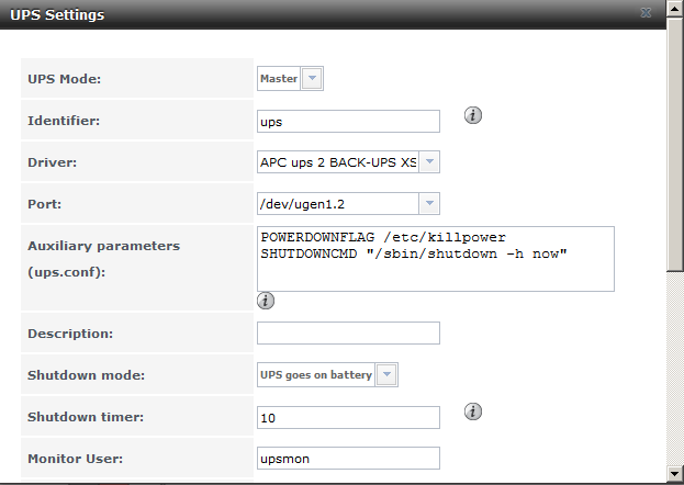

Nov 24, 2013
214
This is a screen shot of my UPS configuration on FreeNAS GUI. Something wrong with this configuration?

cyberjock
Inactive Account
Mar 25, 2012
19,525
Not all UPSes turn off. Some have like a 5 minute delay before they power down. My friend and I figured out the UPS powers down on its own because we powered off the desktop, powered the desktop back on and used it for 2-3 minutes (we were logged in and surfing the net...) and it suddenly turned off. That was how we found out the UPS turns off at all. :/
