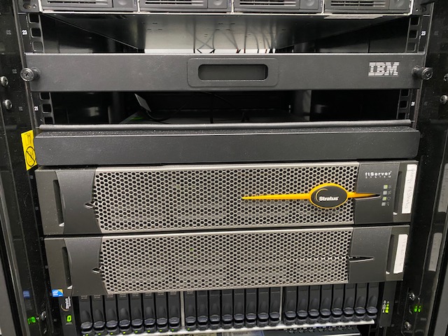

Stratus with 24 2.5" bays underneath it

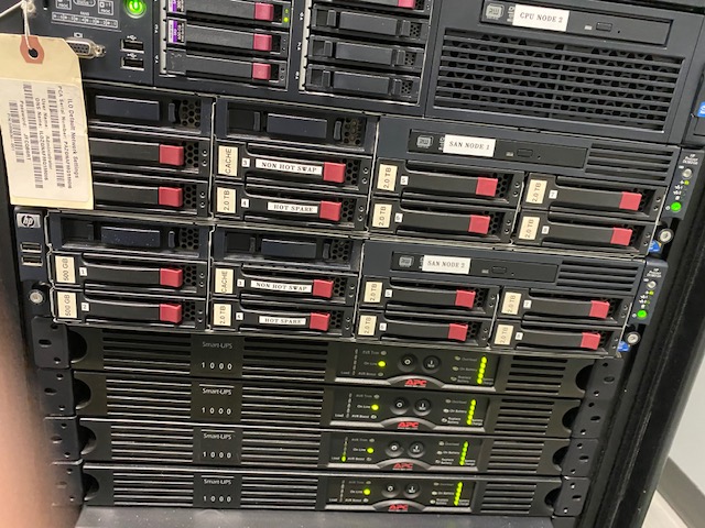

2x HP ProLiant DL180 G6 with mixture of 500GB and 2TB drives
2x HP ProLiant DL360 G7 with mixture of 300GB and 600GB drives

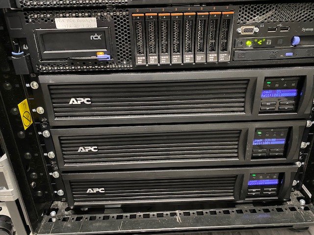

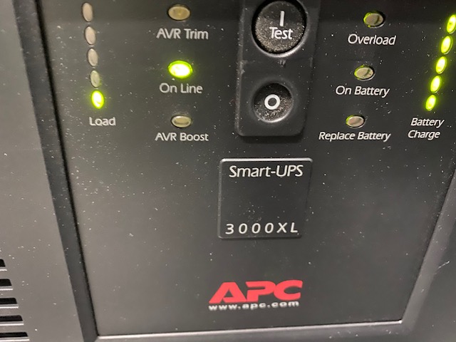

Multiple APC UPS see attached pics

4) Which UPS is worth keeping? Should I keep one for each server?

4) No idea. All I know is, batteries wear over time and if misused. Misusing should be prevented by those UPS'es naturally.
I would try to calculate the power needed for the equipment you want to keep and then see if there is a strong enough UPS to cover them all. Why ? Each UPS will use some extra power on top of the power the system attached to it takes, so if you can cover with one, you only waste lets say 50 watts, if you need 4, its already 200 watts wasted. On the other hand, if this one UPS fails, all systems go down. So its either cheaper or (maybe) safer...
