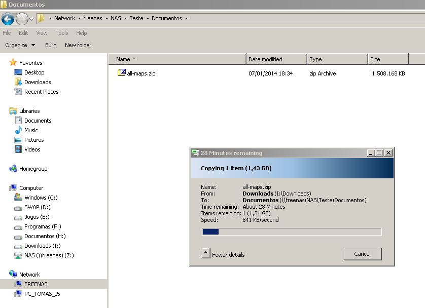

Hello,
I just finished installing FreeNAS and setup (mounted) 2 volumes. Created a CIFS share and was able to access it from a Windows workstation.
I started copying a 1.5Gb file to test the network performance and it is performing very poorly: 845kb/s only!
See screenshot attached. NAS share is on Z: drive.
FreeNAS system is running on an ASRock AS68-UCC with Realtek RTL8201 onboard NIC.
Network runs over 100Mb (cabled) across home.
Any suggestions?
Thanks,
Gaucho

First of the all, dump the Realtek NIC and pick up an Intel. The Pro/1000 CT is ~$30 USD for an OEM version. A lot of Realtek's are realcrap.
Check your cabling, you might have a loose connection or bad cable.
Post the output of ifconfig in code tags.
For optimum performance, upgrade to gigabit Ethernet.

Have you tried it with other files, some files (and I have noticed this often with zip files and other archive files) will simply just perform poorly for read access, be it ver the network or even locally accessed. A file that I've found actually works quite reliable at least for me for good read speed is the 64-bit OpenSUSE ISO. If that thing transfers from my NAS at any slower than 60MB/s then I know that there is a problem somewhere.
Not yet, I'll try this today. Thanks
