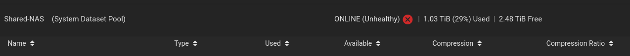

Hello All,
im running TrueNas core 12.0.u6 with 2 (4TB) drives. and 12 GB Ram.
I notices my Pool Status was "degraded" do to 1 checksum error on each drive. I ran (zpool clear) and the pool Status went to ONLINE but now its now Unhealthy.
root@freenas[~]# zpool status -v Shared-NAS
  pool: Shared-NAS
 state: ONLINE
    corruption.  Applications may be affected.
action: Restore the file in question if possible.  Otherwise restore the
    entire pool from backup.
   see: https://openzfs.github.io/openzfs-docs/msg/ZFS-8000-8A
  scan: scrub repaired 0B in 04:05:26 with 6 errors on Sun Jul 10 04:05:27 2022
config:
    Shared-NAS                                      ONLINE       0     0     0
      mirror-0                                      ONLINE       0     0     0
        gptid/ba610235-21f3-11e9-943b-f8b156a6494f  ONLINE       0     0     1
        gptid/bb4b3520-21f3-11e9-943b-f8b156a6494f  ONLINE       0     0     1
        <0x237>:<0xb8f>
        <0x237>:<0xbd5>
        <0x237>:<0xbe4>
        /var/db/system/rrd-1c36823397d74dbc9e7d4fbefe8b455e/localhost/interface-bridge0/if_octets.rrd
        /var/db/system/rrd-1c36823397d74dbc9e7d4fbefe8b455e/localhost/df-mnt-Shared-NAS-iocage-jails-nextcloudjail/df_complex-free.rrd
        /var/db/system/rrd-1c36823397d74dbc9e7d4fbefe8b455e/localhost/disk-da1/disk_time.rrd
root@freenas[~]#

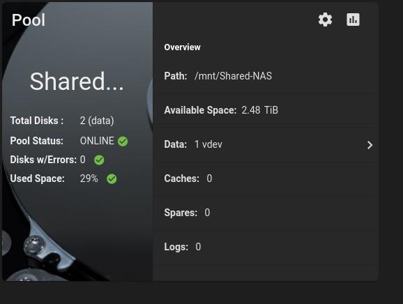

ChrisRJ
Oct 23, 2020
1,919
For the time being you should work under the assumption that a serious problem exists in your setup. Until the details have been figured out, please make a backup immediately.
Whether one of your disks is about to die, you have a cabling issue, or some other problems needs further investigation. And, as @NugentS pointed out, we need more information.

OK - well the usual suspects haven't appeared (other than non-server grade kit). How are the disks connected to the computer. I would assume via on-board SATA at this point - but it would nice if that were confirmed please.
You don't say if the RAM is ECC or not - I guess probably not
The 16GB USB Boot drive is not ideal - but isn't the cause of this issue - do you have a backup of the TrueNAS config? From before this issue occurred preferably?
chksum errors are usually (but not always) caused by bad cables. So I would reseat / replace the SATA cables
Your pool is hosed - but not is a totally disastrous way. You appear to have lost some metadata and some of the system dataset.
Do you have a backup of your data? If not then make one immediately.
