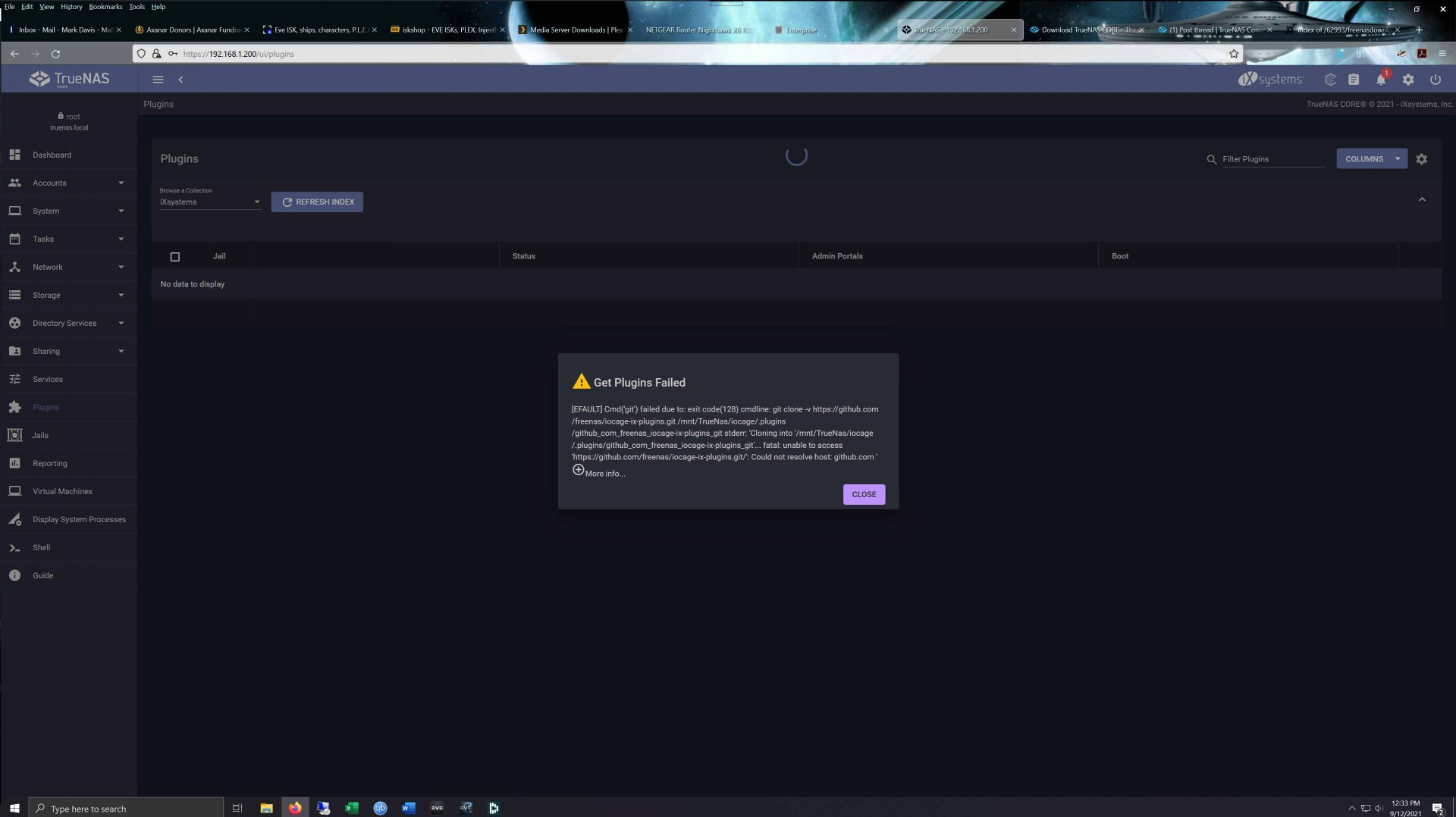

Greetings all,
I started to try after viewing a video to install the Plex server into the TrueNAS, and ran into a bit of trouble.
It will not find the files. See screen shot 1. So I looked to find that there was several updates from U2 to U5. Had a bit of trouble getting that to work but done.
I still have this issue after the update, not seeing any of the plugins from Community or IXsystems. This also happens on the Update, it to will not auto check to see if the updates are there. Thus I have been using manual updates for this time.
Someone have a thought as to why this is happening. I did copy and paste the url and found they are good. So what gives.
I am on a Fiber Optic system with a fiber connection from the company. ,
custom server build, but nothing that would give is fits.
CPU+ I4790
Memory 32Gig
SSD for software
10G Internet
Version: TrueNAS-12.0-U5.1
Thank you
