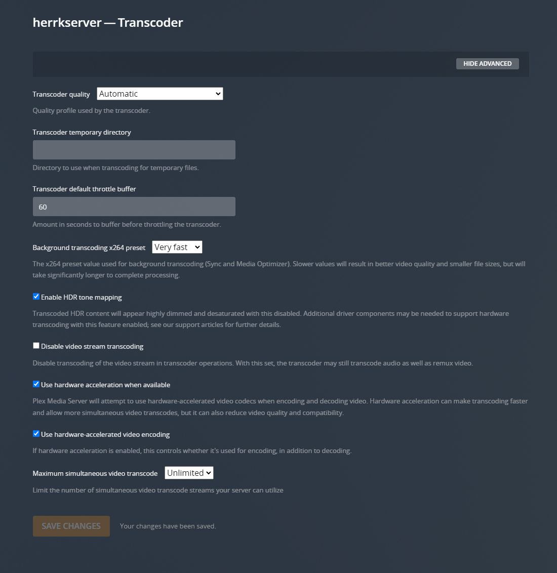

It was working before, I didn't change anything and it started failing outside my LAN environment. I attached the transcoder settings, they're basically default on everything. And on the player itself: I'm just testing by using my mobile phone and then turning WiFi off and on. I don't think I can be more granular on any of the other settings for transcoding on the player, can I?
Disabling Direct Play stops the videos working on both, haha. So it seems like you said it's related to transcoding. While the server is set to transcoding, I do see it in the dashboard (H.264, transcoding) and CPU stays at max 80.06-81.54%, both when set to "make my CPU hurt" or "Prefer higher speed encoding".

You have hardware encoding enabled... do you have the hardware and correct setup for that? (there's a thread in the forum for enabling plex hardware transcoding).
You also haven't specified the temp directory location for the transcode to happen in... ideally that will be a fast disk location that's mounted inside your jail, somewhere like /mnt/tmp
