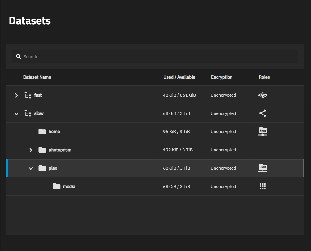

I had the same problem. Take a look at how my datasets are arranged. My plex library is slow/plex/media folder (not the plex parent).
This means I can make the slow/plex folder an SMB share. Make sure you run plex as the user who owns the datasets, you set that when installing plex in Security & Permissions.
Exactly, Thanks for that.
