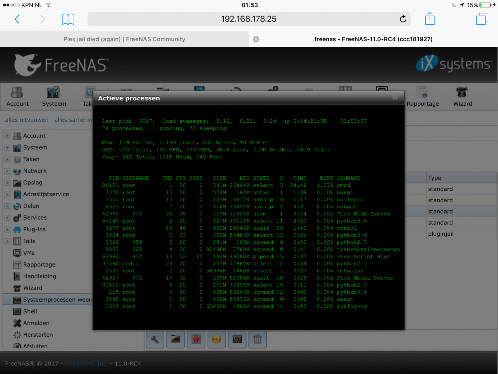

Also here is the system process showing it is running

Hello all,
I have a problem reagrding to jails in FN11 (RC3 and now RC4)
Plex jail is not reacheable anymore, service is running but for some reason the web gui is not reachable.
To be clear it was running, i had this also a couple of days ago but for some reason yesterday it stopped working again.
I tried the normal plex media server first, but after 2 days it was not reachable and then i created a new jail with plex-pass, but now after 1,5 days of running fine i have the same problem.
root@PlexServer:/ # service plexmediaserver_plexpass start
plexmediaserver_plexpass already running?  (pid=53619).
root@PlexServer:/ #
last pid: 56379;  load averages:  0.09,  0.18,  0.16  up 0+23:17:09	10:49:28
81 processes:  1 running, 80 sleeping
Mem: 12M Active, 995M Inact, 61G Wired, 794M Free
ARC: 54G Total, 10G MFU, 42G MRU, 1359K Anon, 214M Header, 1756M Other
Swap: 24G Total, 131M Used, 24G Free
  PID USERNAME	THR PRI NICE   SIZE	RES STATE   C   TIME	WCPU COMMAND
26121 root		  1  21	0   343M 24324K select  9  68:30   1.37% smbd
7370 root		 16  20	0   528M   155M umtxn  13   1:49   0.10% uwsgi
3551 root		 12  20	0   207M 15332K nanslp 12   8:25   0.00% collectd
9323 root		  7  20	0   116M 22484K nanslp  4   4:51   0.00% nzbget
3477 root		 43  46	0   102M 20760K uwait   3   2:40   0.00% consul
57240 root		  2  20	0   127M 30980K select 13   2:31   0.00% python3.6
3434 root		  1  23	0   302M 38448K select 12   1:24   0.00% python3.6
9369	950		2  20	0   291M   102M kqread  5   1:17   0.00% python2.7
9807	921		4  20	0 90436K  6264K kqread 15   1:00   0.00% transmission-daemon
37590 media		20  20	0   203M 69900K select 10   0:57   0.00% python2.7
2531 root		  2  20	0 58984K  3840K select 15   0:43   0.00% vmtoolsd
31519 root		  6  20	0   171M 72608K select  0   0:16   0.00% python2.7
  215 root		  6  20	0   410M 83476K kqread  4   0:11   0.00% python3.6
3445 root		  1  20	0   408M 71576K kqread  2   0:09   0.00% uwsgi
3481 root		 44  20	0 71152K  9456K uwait  14   0:08   0.00% consul-alerts
53663	972	   22  41	0   162M 30932K usem	8   0:07   0.00% Plex DLNA Server
1624 root		  1  20	0 62008K  3028K kqread 11   0:06   0.00% syslog-ng
53652	972	   14  52   15   184M 48736K piperd 18   0:06   0.00% Plex Script Host
As you can see the service is running.
But when i try to reach it at IP:32400/web and also in plex.tv it can't find the server anymore, and not in apps DNLA is also not reachable.
I can't anymore, it stopped when i tried to let the library scan for new files.
I have no idea, i tried to restart the jail, update, upgrade and restart the whole FN11, also checked if the IP address was doubled and if the mac address of the jail was doubled but that was not the issue.
Also just did a forced install and that also did not do the trick.
I run FN11 in ESXi 6.5 with 16 cores avialeble of my E5-2658v4 and 64GB ECC reserved memory for just only this VM. 2x LSI9211-8i IT passthrough VM. I have some other jails running that are working fine at the moment.
Only thing i did what maybe involved is that i set all up already for the other Plex before that when i made the new jail i copied the macaddress from the old deleted jail.
Is tere a reason why this happend or any way to find this out?
Also for now important is there a way to get this working again or do i have to install again an set everything up again from the start?
