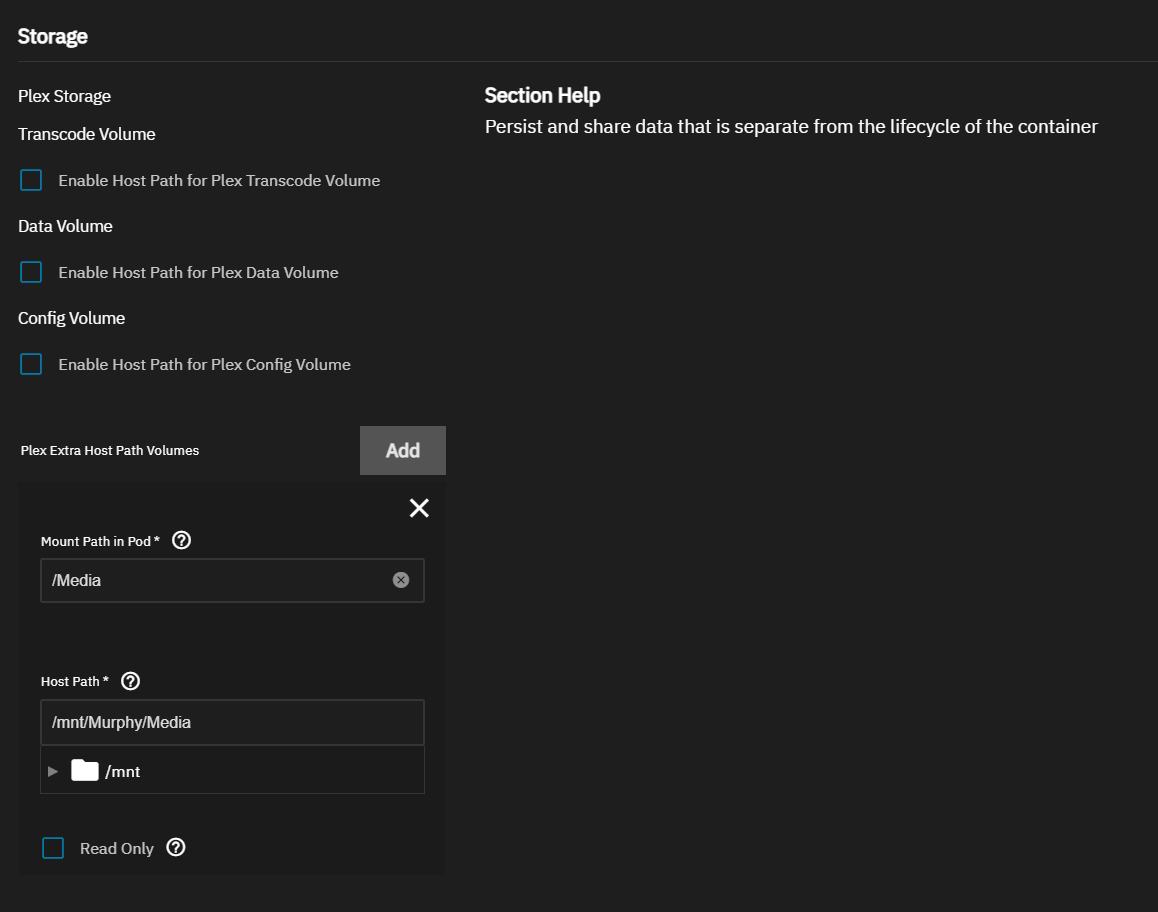

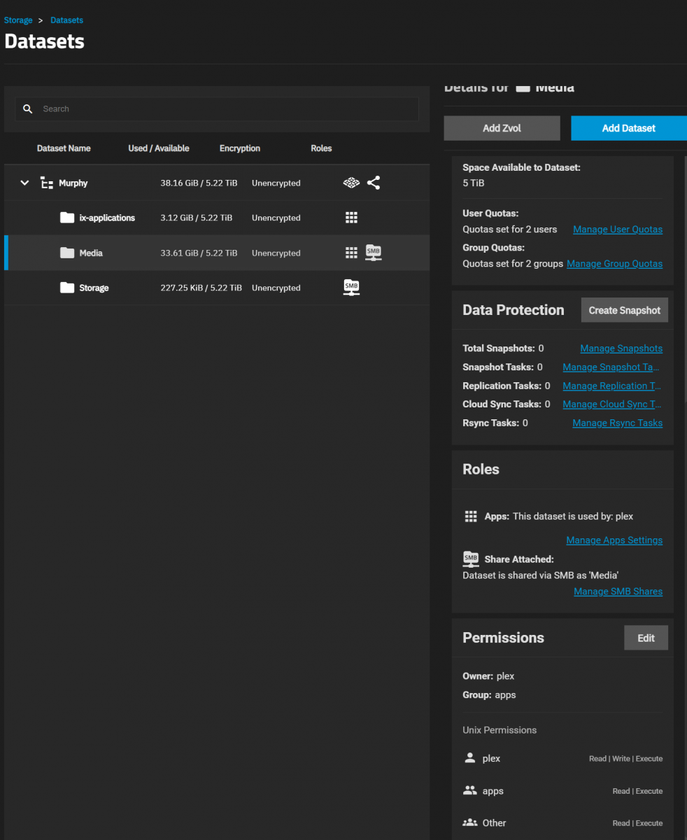

Hi, I am running Truenas Scale 23.10.1 with Plex 1.32.8.7639 and Samba.

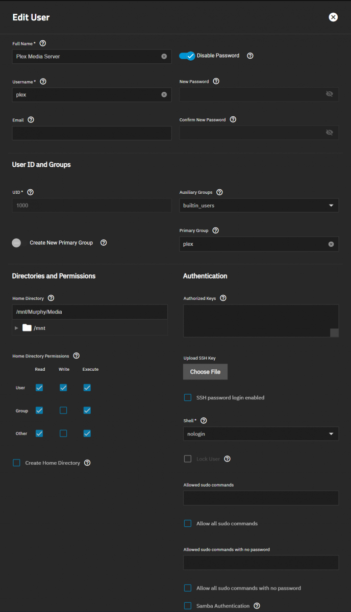

I created a plex user, and created a Media Dataset, and made plex the owner.

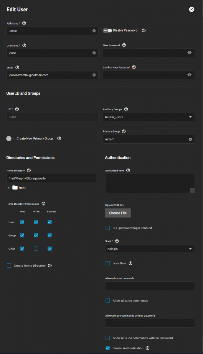

I shared the Media folder via Samba, and gave my user "joelle" access to it.
When I copy files to the Media folder, they are not detected by Plex Server even after using "Scan Library"

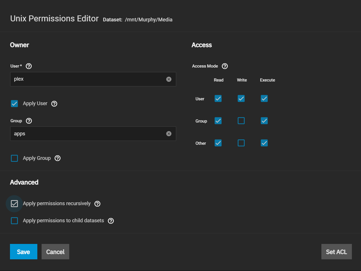

If I go the Dataset permissions and re-apply ownership recursively to the plex user, the files show up in plex.
The problem is that I have to do that to each new file I copy in order for it to appear.
I have attached screenshots of all my configurations.
I would appreciate your input on this.

Thank you for your answer. By default plex user has a UID and GOD of 1000. Manually changing the owner of the files to plex enables plex to access the files. My issue is because user joelle is using samba to add the files, the files are now owned by joelle and plex can't access them despite the directory being owned by plex.

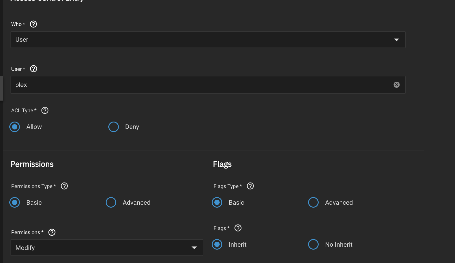

I solved this by going to dataset and enabling ACLs. That allowed me to set FLAG inherit like below.
That makes the permission to be set every time you move a file inside the share.

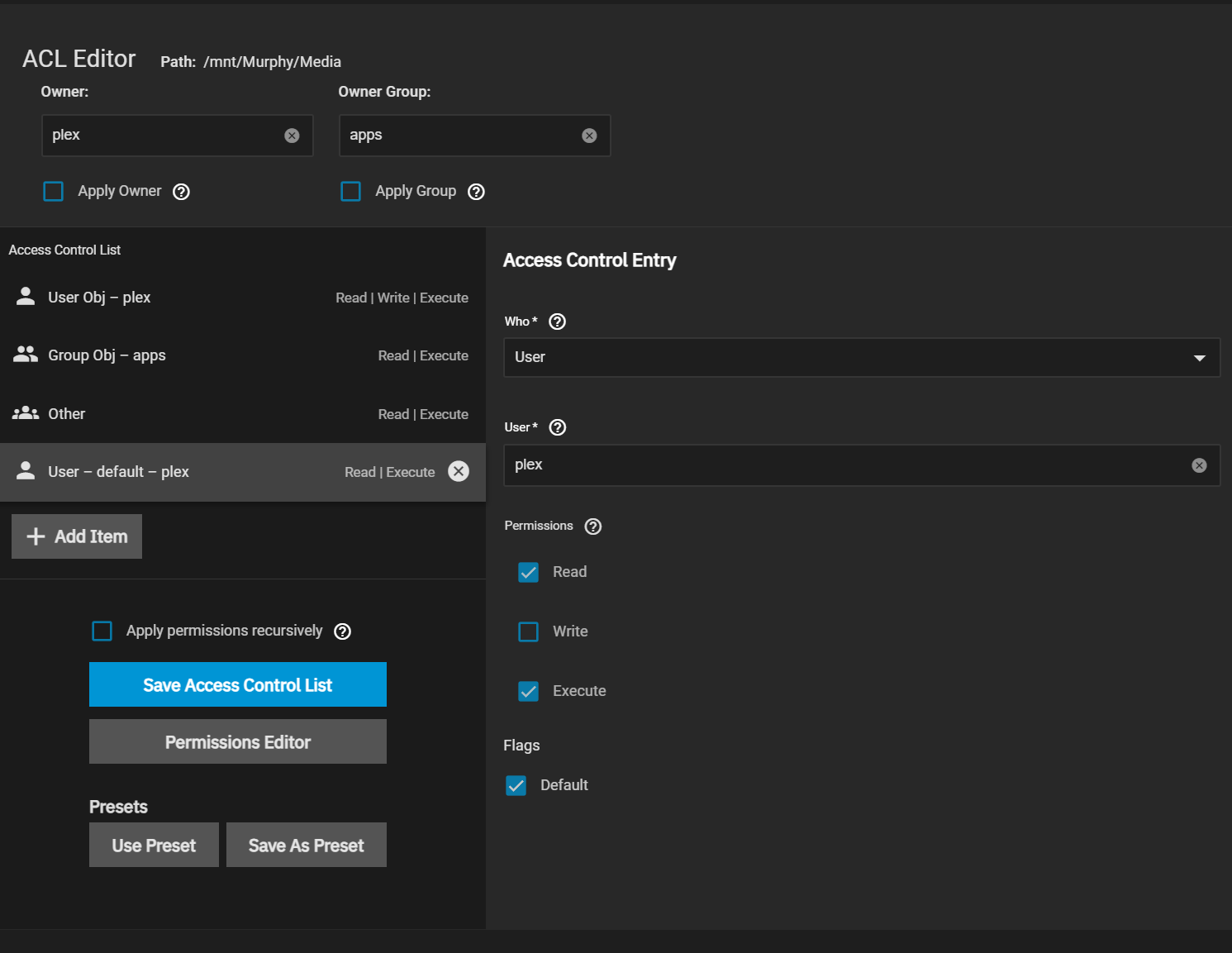

I think that is the solution I am looking for, however my interface looks very different from yours, any ideas how I can set the flag to inherit?
NightWatcher
Dec 14, 2023
7
ok wait I got the same menu I needed to go into the dataset setting and change the share type to SMB to get the right ACL settings
