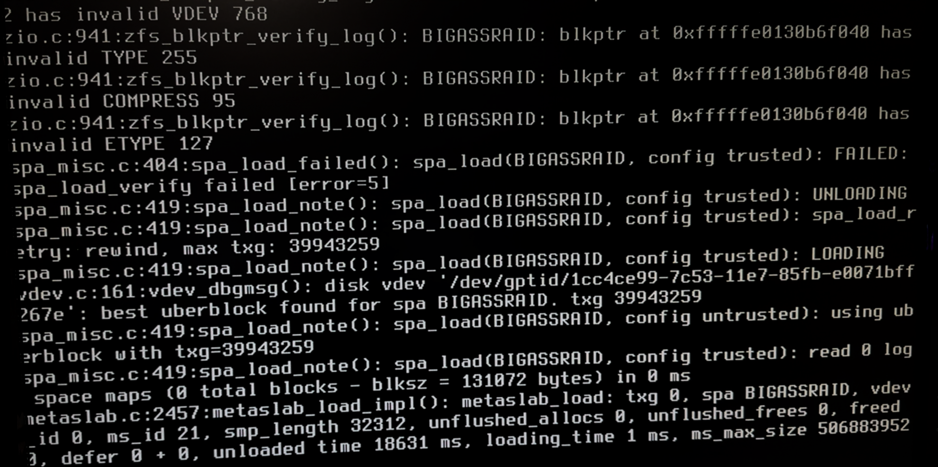

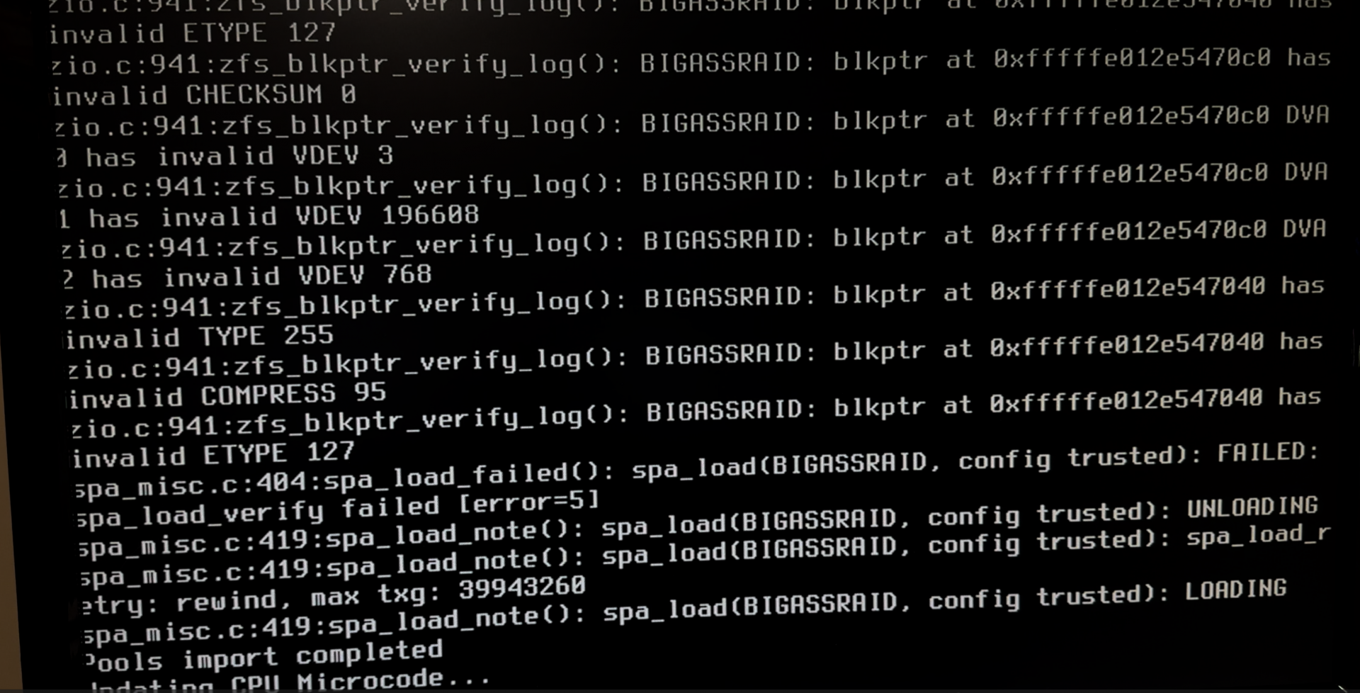

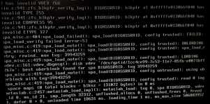

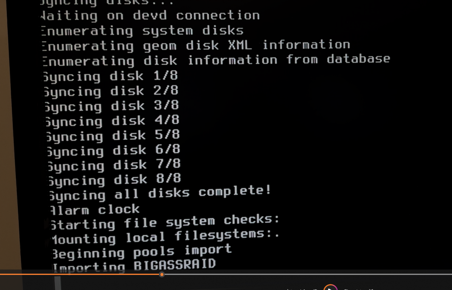

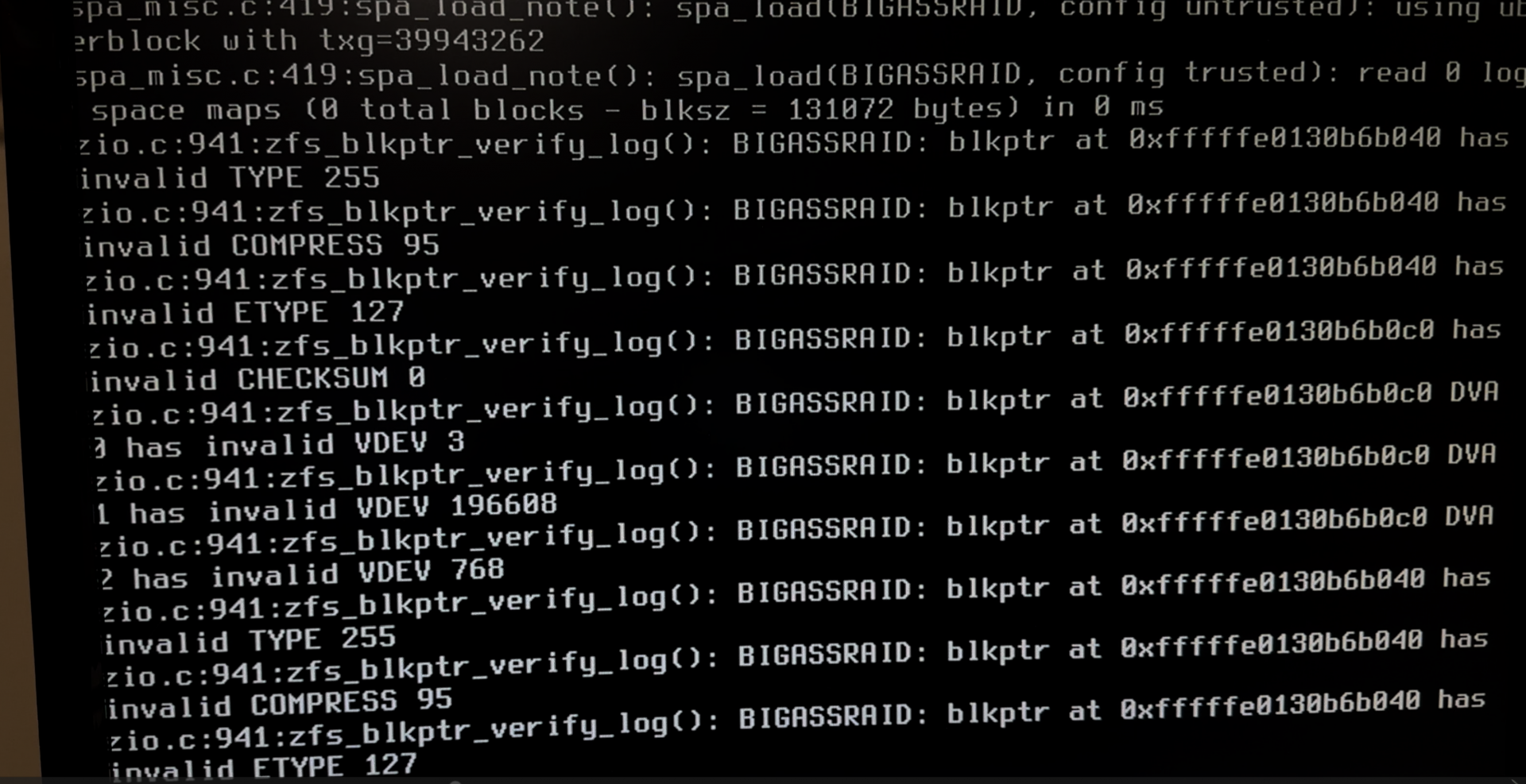

I took a video on my phone when its booting up and then took screenshots
here
rvassar
May 2, 2018
972
How old is this pool? The drives are at 53k hours, so I'm thinking ~6 years. I'm wondering if it's old enough to hit a backwards compatibility bug with the features flags. That isn't anything I can offer a recommended action on, but maybe someone will come along with a Christmas miracle for you.
I would try booting the previous update. I believe you should be able to interrupt the boot process and select an older kernel, etc... If that works and the pool imports, I'd run a scrub. If the scrub comes thru clean, I'd do my homework on maybe a pool feature flags update after the guests leave.
If the previous running version throws the same errors.... You're probably in a restore from backup scenario.

Dec 24 18:23:26 freenas pci1: <ACPI PCI bus> on pcib1
Dec 24 18:23:26 freenas pcib2: <ACPI PCI-PCI bridge> irq 16 at device 1.1 on pci0
Dec 24 18:23:26 freenas pci2: <ACPI PCI bus> on pcib2
Dec 24 18:23:26 freenas ahci0: <Marvell 88SE9235 AHCI SATA controller> port 0xe050-0xe057,0xe040-0xe043,0xe030-0xe037,0xe020-0xe023,0xe000-0xe01f mem 0xdf140000-0xdf1407ff irq 17 at device 0.0 on pci2
Dec 24 18:23:26 freenas ahci0: AHCI v1.00 with 4 6Gbps ports, Port Multiplier supported with FBS
Dec 24 18:23:26 freenas ahcich0: <AHCI channel> at channel 0 on ahci0
Dec 24 18:23:26 freenas ahcich1: <AHCI channel> at channel 1 on ahci0
Dec 24 18:23:26 freenas ahcich2: <AHCI channel> at channel 2 on ahci0
Dec 24 18:23:26 freenas ahcich3: <AHCI channel> at channel 3 on ahci0
Dec 24 18:23:26 freenas vgapci0: <VGA-compatible display> port 0xf000-0xf03f mem 0xde000000-0xdeffffff,0xc0000000-0xcfffffff irq 16 at device 2.0 on pci0
Dec 24 18:23:26 freenas vgapci0: Boot video device
Dec 24 18:23:26 freenas xhci0: <Intel Sunrise Point USB 3.0 controller> mem 0xdf220000-0xdf22ffff irq 16 at device 20.0 on pci0
Dec 24 18:23:26 freenas xhci0: 32 bytes context size, 64-bit DMA
Dec 24 18:23:26 freenas usbus0 on xhci0
Dec 24 18:23:26 freenas usbus0: 5.0Gbps Super Speed USB v3.0
Dec 24 18:23:26 freenas pci0: <simple comms> at device 22.0 (no driver attached)
Dec 24 18:23:26 freenas uart2: <100 Series/C230 Series Chipset Family KT Redirection> port 0xf0a0-0xf0a7 mem 0xdf23f000-0xdf23ffff irq 19 at device 22.3 on pci0
Dec 24 18:23:26 freenas uart2: Using 1 MSI message
Dec 24 18:23:26 freenas ahci1: <Intel Sunrise Point AHCI SATA controller> port 0xf090-0xf097,0xf080-0xf083,0xf060-0xf07f mem 0xdf230000-0xdf231fff,0xdf23e000-0xdf23e0ff,0xdf23d000-0xdf23d7ff irq 16 at device 23.0 on pci0
Dec 24 18:23:26 freenas ahci1: AHCI v1.31 with 6 6Gbps ports, Port Multiplier not supported
Dec 24 18:23:26 freenas ahcich4: <AHCI channel> at channel 0 on ahci1
Dec 24 18:23:26 freenas ahcich5: <AHCI channel> at channel 1 on ahci1
Dec 24 18:23:26 freenas ahcich6: <AHCI channel> at channel 2 on ahci1
Dec 24 18:23:26 freenas ahcich7: <AHCI channel> at channel 3 on ahci1
Dec 24 18:23:26 freenas ahcich8: <AHCI channel> at channel 4 on ahci1
Dec 24 18:23:26 freenas ahcich9: <AHCI channel> at channel 5 on ahci1
Dec 24 18:23:26 freenas ahciem0: <AHCI enclosure management bridge> on ahci1
Dec 24 18:23:26 freenas pcib3: <ACPI PCI-PCI bridge> irq 18 at device 28.0 on pci0
Dec 24 18:23:26 freenas pci3: <ACPI PCI bus> on pcib3
Dec 24 18:23:26 freenas em0: <Intel(R) PRO/1000 PT 82571EB/82571GB (Copper)> port 0xd020-0xd03f mem 0xdf060000-0xdf07ffff,0xdf040000-0xdf05ffff irq 18 at device 0.0 on pci3
Dec 24 18:23:26 freenas em0: EEPROM V5.6-2
Dec 24 18:23:26 freenas em0: Using 1024 TX descriptors and 1024 RX descriptors
Dec 24 18:23:26 freenas em0: Using an MSI interrupt
Dec 24 18:23:26 freenas kernel: em0: Ethernet address: 00:15:17:2e:f0:0e
Dec 24 18:23:26 freenas em1: <Intel(R) PRO/1000 PT 82571EB/82571GB (Copper)> port 0xd000-0xd01f mem 0xdf020000-0xdf03ffff,0xdf000000-0xdf01ffff irq 19 at device 0.1 on pci3
Dec 24 18:23:26 freenas em1: EEPROM V5.6-2
Dec 24 18:23:26 freenas em1: Using 1024 TX descriptors and 1024 RX descriptors
Dec 24 18:23:26 freenas em1: Using an MSI interrupt
Dec 24 18:23:26 freenas kernel: em1: Ethernet address: 00:15:17:2e:f0:0f
Dec 24 18:23:26 freenas isab0: <PCI-ISA bridge> at device 31.0 on pci0
Dec 24 18:23:26 freenas isa0: <ISA bus> on isab0
Dec 24 18:23:26 freenas pci0: <memory> at device 31.2 (no driver attached)
Dec 24 18:23:26 freenas em2: <Intel(R) I219-LM SPT-H(2)> mem 0xdf200000-0xdf21ffff irq 16 at device 31.6 on pci0
Dec 24 18:23:26 freenas em2: EEPROM V0.8-4
Dec 24 18:23:26 freenas em2: Using 1024 TX descriptors and 1024 RX descriptors
Dec 24 18:23:26 freenas em2: Using an MSI interrupt
Dec 24 18:23:26 freenas kernel: em2: Ethernet address: e0:07:1b:ff:26:7e
Dec 24 18:23:26 freenas pci0: <unknown> at device 31.7 (no driver attached)
Dec 24 18:23:26 freenas acpi_button0: <Sleep Button> on acpi0
Dec 24 18:23:26 freenas acpi_button1: <Power Button> on acpi0
Dec 24 18:23:26 freenas acpi_tz0: <Thermal Zone> on acpi0
Dec 24 18:23:26 freenas acpi_tz1: <Thermal Zone> on acpi0
Dec 24 18:23:26 freenas orm0: <ISA Option ROMs> at iomem 0xc0000-0xcffff,0xd0000-0xd2fff,0xd3000-0xd3fff pnpid ORM0000 on isa0
Dec 24 18:23:26 freenas coretemp0: <CPU On-Die Thermal Sensors> on cpu0
Dec 24 18:23:26 freenas hwpstate_intel0: <Intel Speed Shift> on cpu0
Dec 24 18:23:26 freenas hwpstate_intel1: <Intel Speed Shift> on cpu1
Dec 24 18:23:26 freenas hwpstate_intel2: <Intel Speed Shift> on cpu2
Dec 24 18:23:26 freenas hwpstate_intel3: <Intel Speed Shift> on cpu3
Dec 24 18:23:26 freenas Timecounter "TSC-low" frequency 1847999864 Hz quality 1000
Dec 24 18:23:26 freenas Timecounters tick every 1.000 msec
Dec 24 18:23:26 freenas ZFS filesystem version: 5
Dec 24 18:23:26 freenas ZFS storage pool version: features support (5000)
Dec 24 18:23:26 freenas ipfw2 (+ipv6) initialized, divert enabled, nat enabled, default to accept, logging disabled
Dec 24 18:23:26 freenas ugen0.1: <Intel XHCI root HUB> at usbus0
Dec 24 18:23:26 freenas uhub0 on usbus0
Dec 24 18:23:26 freenas uhub0: <Intel XHCI root HUB, class 9/0, rev 3.00/1.00, addr 1> on usbus0
Dec 24 18:23:26 freenas Trying to mount root from zfs:freenas-boot/ROOT/13.0-U3.1 []...
Dec 24 18:23:26 freenas ses0 at ahciem0 bus 0 scbus10 target 0 lun 0
Dec 24 18:23:26 freenas ses0: <AHCI SGPIO Enclosure 2.00 0001> SEMB S-E-S 2.00 device
Dec 24 18:23:26 freenas ses0: SEMB SES Device
Dec 24 18:23:26 freenas ada0 at ahcich0 bus 0 scbus0 target 0 lun 0
Dec 24 18:23:26 freenas ada0: <WDC WD80EFZX-68UW8N0 83.H0A83> ACS-2 ATA SATA 3.x device
Dec 24 18:23:26 freenas ada0: Serial Number VK1EX8HY
Dec 24 18:23:26 freenas ada0: 600.000MB/s transfers (SATA 3.x, UDMA6, PIO 8192bytes)
Dec 24 18:23:26 freenas ada0: Command Queueing enabled
Dec 24 18:23:26 freenas ada0: 7630885MB (15628053168 512 byte sectors)
Dec 24 18:23:26 freenas ses0: pass3 in 'Slot 01', SATA Slot: scbus5 target 0
Dec 24 18:23:26 freenas ses0: pass4 in 'Slot 02', SATA Slot: scbus6 target 0
Dec 24 18:23:26 freenas ada1 at ahcich2 bus 0 scbus2 target 0 lun 0
Dec 24 18:23:26 freenas ada1: <WDC WD80EFZX-68UW8N0 83.H0A83> ACS-2 ATA SATA 3.x device
Dec 24 18:23:26 freenas ada1: Serial Number VK1GHX4Y
Dec 24 18:23:26 freenas ada1: 600.000MB/s transfers (SATA 3.x, UDMA6, PIO 8192bytes)
Dec 24 18:23:26 freenas ada1: Command Queueing enabled
Dec 24 18:23:26 freenas ada1: 7630885MB (15628053168 512 byte sectors)
Dec 24 18:23:26 freenas ses0: pass5 in 'Slot 03', SATA Slot: scbus7 target 0
Dec 24 18:23:26 freenas ada2 at ahcich3 bus 0 scbus3 target 0 lun 0
Dec 24 18:23:26 freenas ada2: <WDC WD80EFZX-68UW8N0 83.H0A83> ACS-2 ATA SATA 3.x device
Dec 24 18:23:26 freenas ada2: Serial Number VJH5RDPX
Dec 24 18:23:26 freenas ada2: 600.000MB/s transfers (SATA 3.x, UDMA6, PIO 8192bytes)
Dec 24 18:23:26 freenas ada2: Command Queueing enabled
Dec 24 18:23:26 freenas ada2: 7630885MB (15628053168 512 byte sectors)
Dec 24 18:23:26 freenas ses0: pass6 in 'Slot 04', SATA Slot: scbus8 target 0
Dec 24 18:23:26 freenas ada3 at ahcich5 bus 0 scbus5 target 0 lun 0
Dec 24 18:23:26 freenas ada3: <SanDisk SDSSDA120G Z33130RL> ACS-2 ATA SATA 3.x device
Dec 24 18:23:26 freenas ada3: Serial Number 172773801991
Dec 24 18:23:26 freenas ada3: 600.000MB/s transfers (SATA 3.x, UDMA6, PIO 512bytes)
Dec 24 18:23:26 freenas ada3: Command Queueing enabled
Dec 24 18:23:26 freenas ada3: 114473MB (234441648 512 byte sectors)
Dec 24 18:23:26 freenas ada4 at ahcich6 bus 0 scbus6 target 0 lun 0
Dec 24 18:23:26 freenas ada4: <WDC WD80EFZX-68UW8N0 83.H0A83> ACS-2 ATA SATA 3.x device
Dec 24 18:23:26 freenas ada4: Serial Number VK1GJA0Y
Dec 24 18:23:26 freenas ada4: 600.000MB/s transfers (SATA 3.x, UDMA6, PIO 8192bytes)
Dec 24 18:23:26 freenas ada4: Command Queueing enabled
Dec 24 18:23:26 freenas ada4: 7630885MB (15628053168 512 byte sectors)
Dec 24 18:23:26 freenas ada5 at ahcich7 bus 0 scbus7 target 0 lun 0
Dec 24 18:23:26 freenas ada5: <WDC WD80EFZX-68UW8N0 83.H0A83> ACS-2 ATA SATA 3.x device
Dec 24 18:23:26 freenas ada5: Serial Number VK1EXGGY
Dec 24 18:23:26 freenas ada5: 600.000MB/s transfers (SATA 3.x, UDMA6, PIO 8192bytes)
Dec 24 18:23:26 freenas ada5: Command Queueing enabled
Dec 24 18:23:26 freenas ada5: 7630885MB (15628053168 512 byte sectors)
Dec 24 18:23:26 freenas ada6 at ahcich8 bus 0 scbus8 target 0 lun 0
Dec 24 18:23:26 freenas ada6: <WDC WD80EFZX-68UW8N0 83.H0A83> ACS-2 ATA SATA 3.x device
Dec 24 18:23:26 freenas ada6: Serial Number VK1EBZTY
Dec 24 18:23:26 freenas ada6: 600.000MB/s transfers (SATA 3.x, UDMA6, PIO 8192bytes)
Dec 24 18:23:26 freenas ada6: Command Queueing enabled
Dec 24 18:23:26 freenas ada6: 7630885MB (15628053168 512 byte sectors)
Dec 24 18:23:26 freenas ada7 at ahcich9 bus 0 scbus9 target 0 lun 0
Dec 24 18:23:26 freenas ada7: <WDC WD80EFZX-68UW8N0 83.H0A83> ACS-2 ATA SATA 3.x device
Dec 24 18:23:26 freenas ada7: Serial Number VK1EH4BY
Dec 24 18:23:26 freenas ada7: 600.000MB/s transfers (SATA 3.x, UDMA6, PIO 8192bytes)
Dec 24 18:23:26 freenas ada7: Command Queueing enabled
Dec 24 18:23:26 freenas ada7: 7630885MB (15628053168 512 byte sectors)
Dec 24 18:23:26 freenas ses0: pass7,ada7 in 'Slot 05', SATA Slot: scbus9 target 0
Dec 24 18:23:26 freenas Root mount waiting for: usbus0
Dec 24 18:23:26 freenas uhub0: 26 ports with 26 removable, self powered
Dec 24 18:23:26 freenas ugen0.2: <CPS CP 1500C> at usbus0
Dec 24 18:23:26 freenas ugen0.3: <Chicony Saitek Eclipse Keyboard> at usbus0
Dec 24 18:23:26 freenas ukbd0 on uhub0
Dec 24 18:23:26 freenas ukbd0: <Chicony Saitek Eclipse Keyboard, class 0/0, rev 2.00/1.30, addr 2> on usbus0
Dec 24 18:23:26 freenas kbd1 at ukbd0
Dec 24 18:23:26 freenas uhid0 on uhub0
Dec 24 18:23:26 freenas uhid0: <Chicony Saitek Eclipse Keyboard, class 0/0, rev 2.00/1.30, addr 2> on usbus0
Dec 24 18:23:26 freenas ichsmb0: <Intel Sunrise Point-H SMBus controller> port 0xf040-0xf05f mem 0xdf23c000-0xdf23c0ff irq 16 at device 31.4 on pci0
Dec 24 18:23:26 freenas smbus0: <System Management Bus> on ichsmb0
Dec 24 18:23:26 freenas kernel: lo0: link state changed to UP
Dec 24 18:23:26 freenas kernel: em0: link state changed to UP
Dec 24 18:23:26 freenas debugnet_any_ifnet_update: Bad dn_init result from em0 (ifp 0xfffff80005031800), ignoring.
Dec 24 18:23:26 freenas kernel: em1: link state changed to UP
Dec 24 18:23:26 freenas debugnet_any_ifnet_update: Bad dn_init result from em1 (ifp 0xfffff80004acc800), ignoring.
Dec 24 18:23:26 freenas CPU: Intel(R) Core(TM) i3-6100 CPU @ 3.70GHz (3696.00-MHz K8-class CPU)
Dec 24 18:23:26 freenas Origin="GenuineIntel" Id=0x506e3 Family=0x6 Model=0x5e Stepping=3
Dec 24 18:23:26 freenas Features=0xbfebfbff<FPU,VME,DE,PSE,TSC,MSR,PAE,MCE,CX8,APIC,SEP,MTRR,PGE,MCA,CMOV,PAT,PSE36,CLFLUSH,DTS,ACPI,MMX,FXSR,SSE,SSE2,SS,HTT,TM,PBE>
Dec 24 18:23:26 freenas Features2=0x7ffafbbf<SSE3,PCLMULQDQ,DTES64,MON,DS_CPL,VMX,EST,TM2,SSSE3,SDBG,FMA,CX16,xTPR,PDCM,PCID,SSE4.1,SSE4.2,x2APIC,MOVBE,POPCNT,TSCDLT,AESNI,XSAVE,OSXSAVE,AVX,F16C,RDRAND>
Dec 24 18:23:26 freenas AMD Features=0x2c100800<SYSCALL,NX,Page1GB,RDTSCP,LM>
Dec 24 18:23:26 freenas AMD Features2=0x121<LAHF,ABM,Prefetch>
Dec 24 18:23:26 freenas Structured Extended Features=0x29c67af<FSGSBASE,TSCADJ,SGX,BMI1,AVX2,SMEP,BMI2,ERMS,INVPCID,NFPUSG,MPX,RDSEED,ADX,SMAP,CLFLUSHOPT,PROCTRACE>
Dec 24 18:23:26 freenas Structured Extended Features3=0x9c002e00<MCUOPT,MD_CLEAR,TSXFA,IBPB,STIBP,L1DFL,SSBD>
Dec 24 18:23:26 freenas XSAVE Features=0xf<XSAVEOPT,XSAVEC,XINUSE,XSAVES>
Dec 24 18:23:26 freenas VT-x: PAT,HLT,MTF,PAUSE,EPT,UG,VPID
Dec 24 18:23:26 freenas TSC: P-state invariant, performance statistics
Dec 24 18:23:26 freenas kernel: lagg0: link state changed to UP
Dec 24 18:23:26 freenas kernel: em1: link state changed to DOWN
Dec 24 18:23:26 freenas kernel: lagg0: link state changed to DOWN
Dec 24 18:23:26 freenas hwpmc: SOFT/16/64/0x67<INT,USR,SYS,REA,WRI> TSC/1/64/0x20<REA> IAP/4/48/0x3ff<INT,USR,SYS,EDG,THR,REA,WRI,INV,QUA,PRC> IAF/3/48/0x67<INT,USR,SYS,REA,WRI>
Dec 24 18:23:26 freenas 1 2023-12-24T18:23:26.849127-05:00 freenas.local ntpd 1354 - - ntpd 4.2.8p15-a (1): Starting
Dec 24 18:23:26 freenas 1 2023-12-24T18:23:26.849429-05:00 freenas.local ntpd 1354 - - Command line: /usr/sbin/ntpd -p /var/db/ntp/ntpd.pid -c /etc/ntp.conf -f /var/db/ntp/ntpd.drift -g
Dec 24 18:23:26 freenas 1 2023-12-24T18:23:26.849442-05:00 freenas.local ntpd 1354 - - ----------------------------------------------------
Dec 24 18:23:26 freenas 1 2023-12-24T18:23:26.849451-05:00 freenas.local ntpd 1354 - - ntp-4 is maintained by Network Time Foundation,
Dec 24 18:23:26 freenas 1 2023-12-24T18:23:26.849470-05:00 freenas.local ntpd 1354 - - Inc. (NTF), a non-profit 501(c)(3) public-benefit
Dec 24 18:23:26 freenas 1 2023-12-24T18:23:26.849482-05:00 freenas.local ntpd 1354 - - corporation. Support and training for ntp-4 are
Dec 24 18:23:26 freenas 1 2023-12-24T18:23:26.849498-05:00 freenas.local ntpd 1354 - - available at https://www.nwtime.org/support
Dec 24 18:23:26 freenas 1 2023-12-24T18:23:26.849510-05:00 freenas.local ntpd 1354 - - ----------------------------------------------------
Dec 24 18:23:27 freenas Security policy loaded: MAC/ntpd (mac_ntpd)
Dec 24 18:23:53 freenas 1 2023-12-24T18:23:53.921439-05:00 freenas.local ntpd 1355 - - restrict: ignoring line 10, address/host '0.freebsd.pool.ntp.org' unusable.
Dec 24 18:23:57 freenas proftpd[1399]: 127.0.0.1 - ProFTPD 1.3.7c (maint) (built Fri Nov 11 2022 15:28:34 UTC) standalone mode STARTUP
Dec 24 18:23:58 freenas 1 2023-12-24T18:23:58.407094-05:00 freenas.local daemon 1461 - - 2023-12-24 18:23:58,406:wsdd WARNING(pid 1462): no interface given, using all interfaces
Dec 24 18:24:07 freenas 1 2023-12-24T18:24:07.459304-05:00 freenas.local daemon 1693 - - 2023-12-24 18:24:07,459:wsdd WARNING(pid 1694): no interface given, using all interfaces
Dec 25 00:00:00 freenas syslog-ng[1287]: Configuration reload request received, reloading configuration;
Dec 25 00:00:00 freenas syslog-ng[1287]: Configuration reload finished;

Would be able to return pool to its state as of (INSERT DATE AND TIME HERE)
Would discard approximately N seconds of transations.
Make your judgement call if you can live with that, then issue
zpool import -FXf BIGASSRAID
joeschmuck
Old Man
May 28, 2011
10,996
I would recommend you do what @HoneyBadger is suggesting. It may be the only way to recover your data. Make sure you wait the time for it to respond. I don't know if it takes 2 minutes or 6 hours. I suspect it depends on how much data you have.
In the meantime while waiting on your drives to finish SMART testing, the data you attached for the 'messages' file had no usable data that I could see to help. Let's try this one:
mail -s "dmesg.today" youremailaddr < /var/log/dmesg.today
and do the same for file
/var/log/dmesg.yesterday
and why not add one more file,
/var/log/console.log
as I suspect that will list the data you previously posted.
You can take a look in this log file area and see all the files there. To look at them on the system you just need to type
cat filename | more
and it will display the file on the screen one page at a time. Press the SPACE BAR to advance to the next screen. I don't look in this area often but you can see there are some interesting things here.
