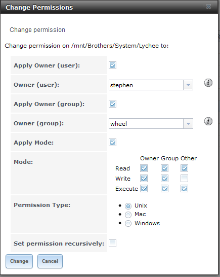

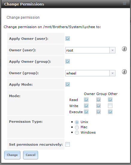

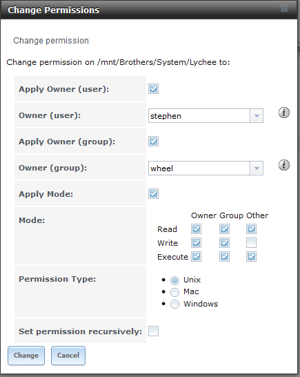

I am trying to redirect a mysql database for a photo sharing app to a shared folder on my FreeNAS box. This is just for personal use, so I'm not too concerned with any possible performance limitations of this implementation. However, no matter what I do as far as users go, I am getting permission denied errors when trying to copy files to the freenas box from the VM. I have the share mounted with fstab and it works fine to create files in manually, but if I try to rsync the mysql directory to it and keep permissions, it fails. I can post any kind of error log or output that would be helpful.

The zfs aclmode might be preventing rsync from keeping permissions. Create a new dataset / samba share, but this time set permissions type to "Unix" and try it again.
Is this what you mean? If so, I've had it created with Unix permissions from the start. If you mean NFS vs SMB then I have it configured as SMB (samba).
