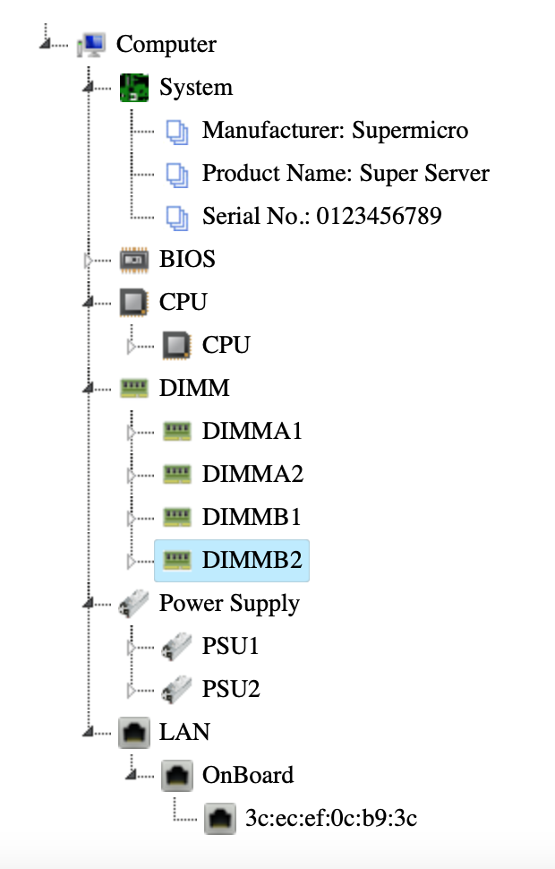

Hello everybody,
I hope this is the right forum to ask my question. I recently upgraded to a new mainboard (Supermircro A2SDi-H-TP4F) and new RAM (4x 64GB RDIMM Kingston Server Premier) for my NAS. I installed my M.2 SSD and plugged in all the SATA HDDs and booted it up.
The problem I have is that my system is stuck in POST with the message "PEI--Intel MRC Execution 63". I have googled this code but haven't found anything on 63 (but other Execution codes).
Does anyone know what might cause this POST issue? The mainboard does support up to 256GB ECC RDIMM (according to the product page). I posted the system information as an attachment. I have yet to write the Supermicro Support but I thought I ask in this forum, if someone has had similar issues.
Edit: Both the RAM and the Mainboard are brand-new (just received them in the mail the other day)
