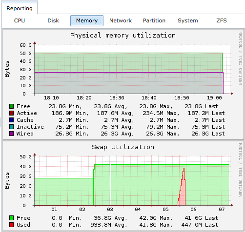

Here is a screenshot of the swap usage, but i think i can determine what occurred just from the screenshot.
My thoughts: Is its from my short SMART test
>Short tests on days 3,6,9,12,18,21,24,27 , at 23:00 hours
>Long tests on days 1 and 15 , at 23:00 hours

Something was wrong with your box. Some kind of process went into some kind of runaway status. I'd say look at stuff in top next time you see swapspace being used. That's how you are going to find out what is going haywire.
I would upgrade the OS if it is old. You didn't provide a version number, so I don't have a clue if you are using the 9.3-RELEASE version or a version that is just 2 weeks old. :P

I don't know if you rebooted or what, but the fact that it suddenly dropped to no swapspace used makes me wonder if the swapspace was freed when proftpd was killed. :P
