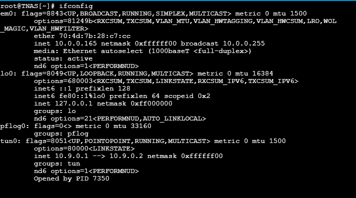

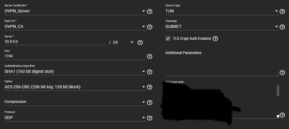

Sounds like a networking issue. I just spent a few minutes looking at the built in Openvpn server settings, and i suspect you might be using an IP within your subnet as the server address. In this box youll want to use an IP outside of your subnet. For instance if your IP scheme for your network is 192.168.1.0/24 in the server box for Openvpn use something different such as 192.168.111.111/24. This is the network that the tunnel will use. This is just a hunch. Post your output of ifconfig with the tunnel active, and your OVPN server settings (redact any keys).

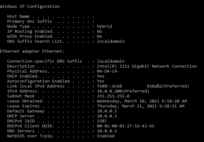

Hi John. I ran ipconfig from one of my main computers on the internal system and there is nothing indicating that I have a tunnel connected from the Truenas out of my network. The only thing showing is the interface of the computer itself. Same report with and without the connection. Unless I'm missing something, that's what I expected. I did try ipconfig in the Truenas shell, even though I knew it wouldn't work, and it didn't. I've attached the two snips as requested and hopefully they are what you are looking for. FYI, my Truenas is sitting at 10.0.0.165, and the OpenVPN client on my iPhone is showing as 10.9.0.2 upon connection. Thanks for your assistance.
The command in unix is ifconfig but if your phone gets the correct 10.9.0.0 address i suspect it will check out.

so the ifconfig (Thanks.) listing changes by one line when connected, see attached, it is the last line only. Yes I am trying to access the SMB shares that are on my Nas. They are fully accessible from within the network. When I use the iPhone file browser app, it does the redirect via the DDNS and gets to my external ip address and then shows "connect failed. socket timed out". Nothing else is showing as far as logs that I can find nor any other errors.

Ok so this all seems legit as predicted. My last working theory is you need to get the routes pushed to the clients so it knows where to go. In additional parameters in Ovpn server do these.
local 10.0.0.165
push "route 10.0.0.0 255.255.255.0"
route 10.0.0.165 255.255.255.0 10.9.0.1
push "dhcp-option DNS 10.0.0.165"
Then regenerate your client config (or edit the existing one) deploy it and test.
After looking around the forums seems several have had the same issues as you. Where it connects but you can't get to internal lan. There are several bug reports for it. I'd tried setting it up to test and I can't get it to start, but I didn't try very hard. So it seems to be a work in progress.
