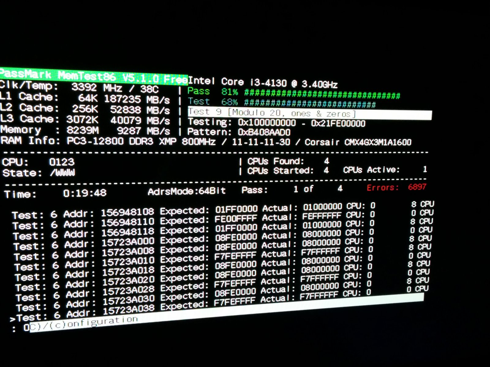

I ran memtest on my memory.
As soon as it started I got errors.
After a few minutes there were thousands of errors (see pic)
I presume this means my memory is dead?

So at this point you are at the stage where we say "you are f*cked". You're in for some hurt now because of bad RAM. See all those warnings about why ECC RAM is so important. You just became a poster child.
Basically anything you've ever put on your pool is potentially corrupt. So if you have backups I'd get a system with ECC support, recreate a new pool, then move your data back.
Now you see why my first post said "this is gonna be messy". I saw the writing on the wall and I knew where this was going to end up. ;)

This is the second time I've seen Corsair push out a bad dimm. Sorry for your loss, hopefully you've still got the data on the external drives
