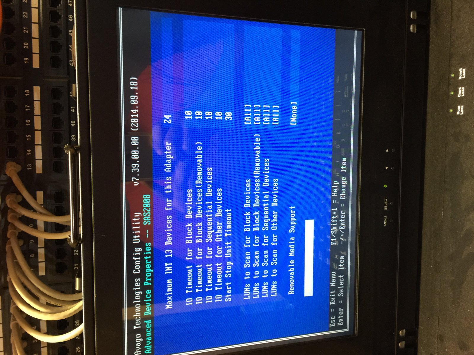

Looks like its not possible sort of. the m1015 can only use a max of 24 drives, trying to set this higher in the bios fails. The daisy chain works, but not if you already have 24 on the first sas expander.

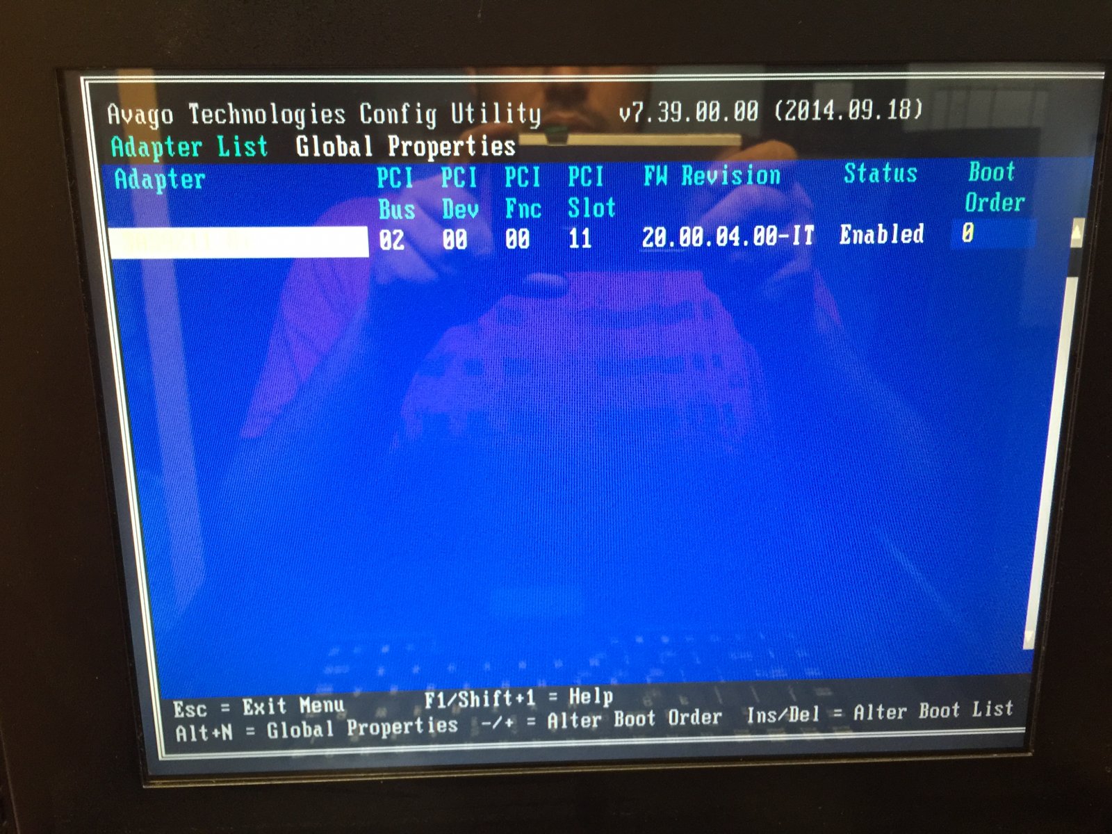

What's the output of sas2ircu (whatever the command is that shows you the SAS topology)?
Raymond Matos
Dec 19, 2011
64
See screenshot attached

Isn't there a menu in that BIOS extension ROM that displays all drives?
In any case, are the additional drives missing in FreeNAS or just in the extension ROM setup menu?
Raymond Matos
Dec 19, 2011
64
Both. I already tried swapping out another sas expander (brought 2) and cables. But in this bios is where the max is set to 24.

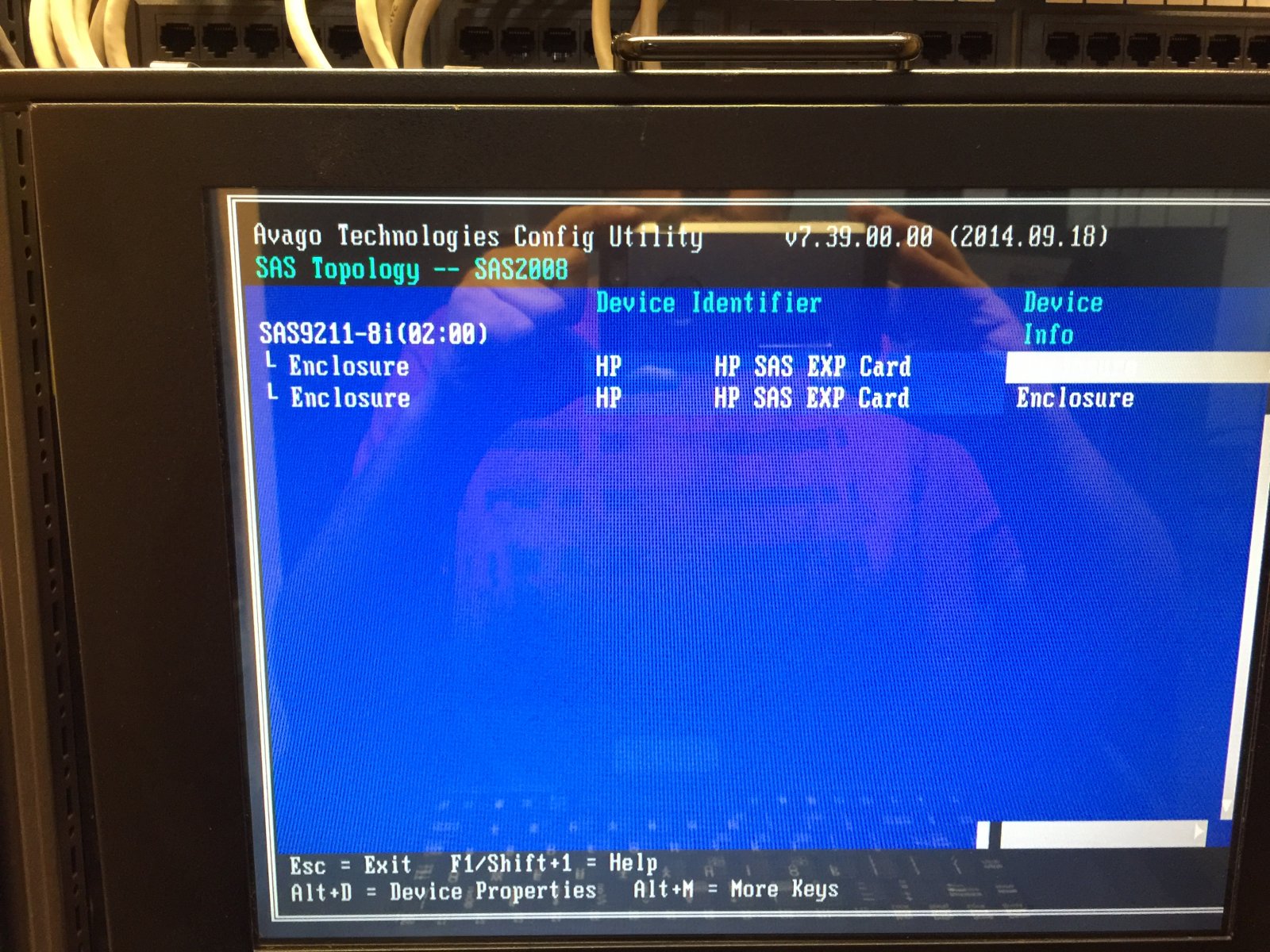

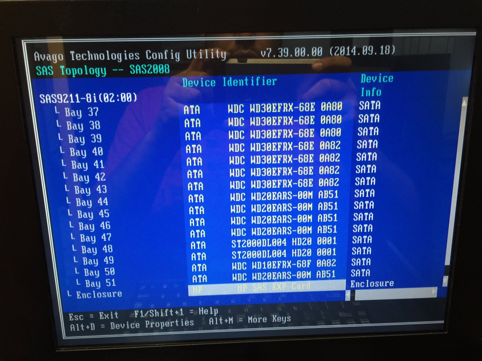

Raymond Matos
Dec 19, 2011
64
Hitting enter on the first card shows all the drives connected to that.
However hitting enter on the 2nd does nothing

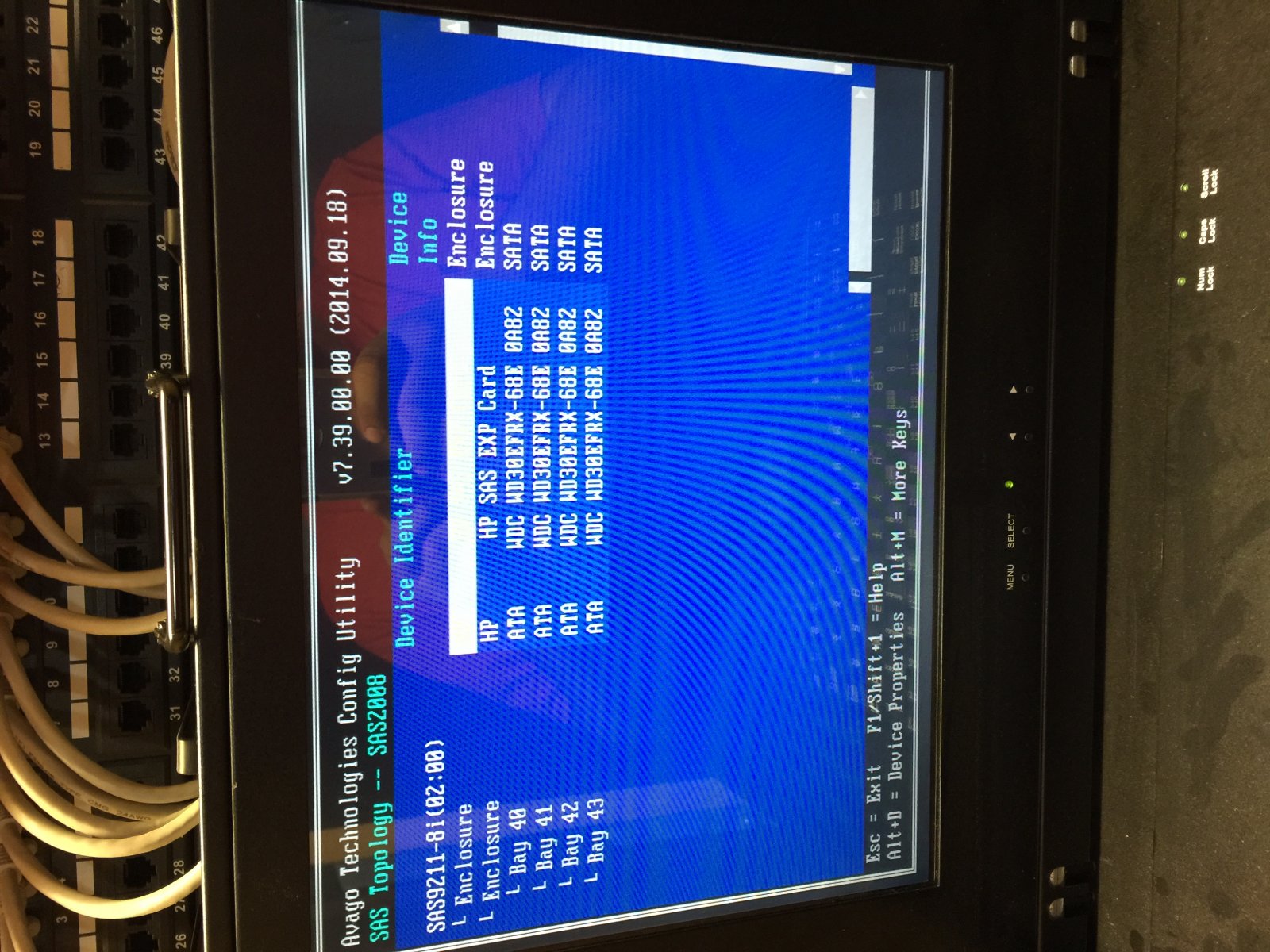

Raymond Matos
Dec 19, 2011
64
Actually i was able to see some of the drives connected to sas2 but only 4 of the 16 or so i have in there.
Raymond Matos
Dec 19, 2011
64
See the screenshots below

Well, that 24 drive indication only applies to BIOS-driven disk accesses, judging by what it says. It really should be working as expected in FreeNAS...

So i should be able to see all the drives connected on sas2 on that screen? What else could be preventing me from seeing those drives?
Not necessarily, the BIOS extension ROM has long been buggy and somewhat unreliable.
