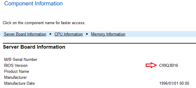

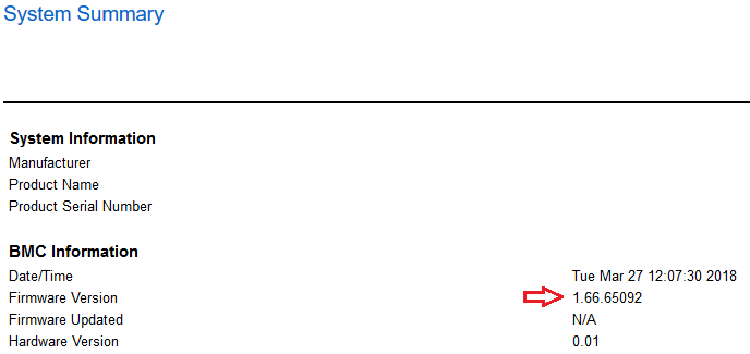

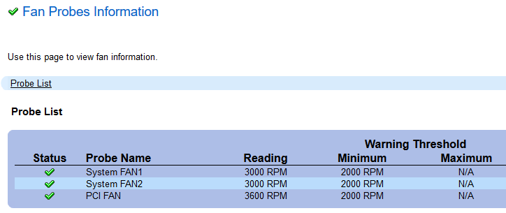

Hmm, something is off then. Can you post some screenshots of the system info (from IPMI)?
For reference, here is one of mine:

Ok here are some screenshots from ipmi, note that the fan speeds are roughly 10-15 minutes after booting into OS.
