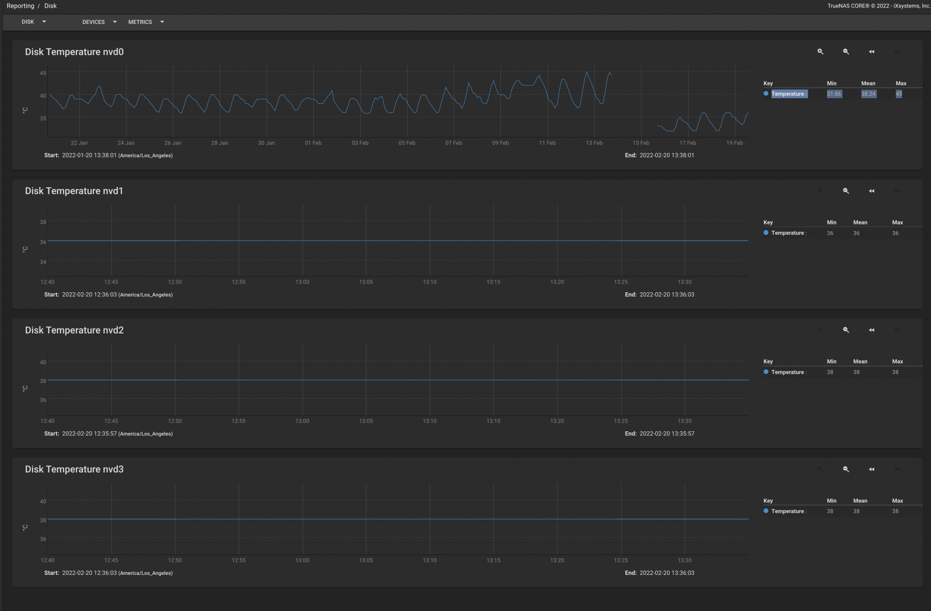

Here's something interesting. nvd0 was the drive that disconnected.

Samuel Tai
Apr 24, 2020
5,399
Definitely looks like overheating. 45 C, when all the others are at 36 C.
AlexGG
Dec 13, 2018
171
