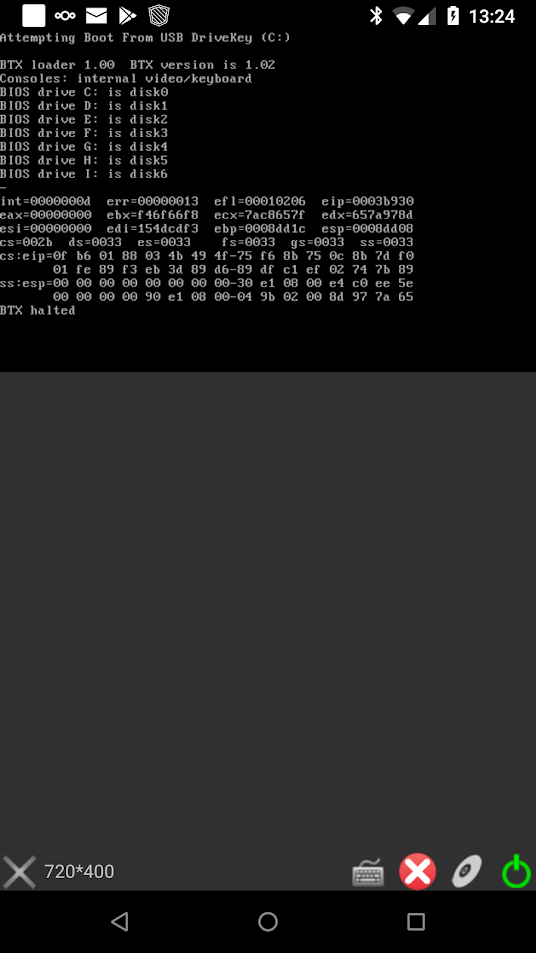

Ok, I tried to downgrade to FreeNAS 11.1 (via normal WebUI-> System-Boot 11.1-U6 -> activate), now it doesn't boot anymore at all and I really need you help!
How to recover? (FreeNAS itself, not the jails at first)
The Hardware is fine, boots from another USB-Stick..
Edit: And yes, I have snapshots, snapshots, snapshots local and on an external (detached) backup-disk (and just doing a dd of the boot-sticks) but cannot mount them under Mint 18.3):

My guess is that the change of bootloader in 11.2 is messing up your boot environments. Can you interrupt the boot process and choose 11.2 again?
I don't see a reason to boot from 11.1 again, your warden jails are still working under 11.2 (use the legacy gui to stop/start them).
If you can't solve it this way, I would reinstall 11.2 from ISO and import your backed-up config.

No, the boot doesn't start at all (no GRUB or anything to choose)
The reason to boot 11.1 is simply, that anything, including PHP just *worked*..
I've booted from the 11.2-Installer now, question: how to fix the freenas-boot mirrored sticks from there to boot at least 11.2 again?
thanks, Michael
Then reinstall and import your config.
PHP on FreeNAS or PHP in the jail? I don't see a reason (maybe I am wrong) why the upgrade would've touched anything inside of the jails. Again, you can still run an untouched warden jail on 11.2.
You don't fix them, reinstall and import the config file.

Puhhh, at least "upgrade"-install worked with a 11.2-installer-stick over the existing Sticks preserving the config, it boots again :eek:
(should this be considered a bug, that the whole box is fully trashed if one activates the last version to boot?)
