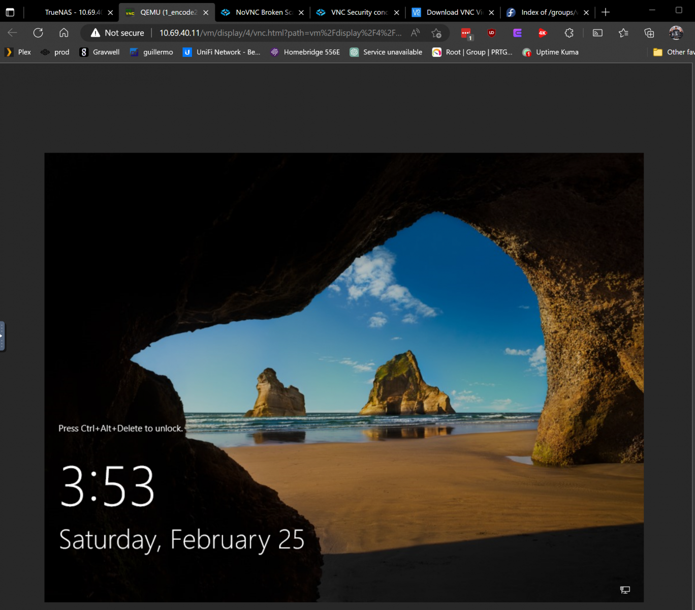

You should be able to get into the VM using a standalone VNC client. It's just the built in web-based one that's broken. I do not recommend using VNC after setup is completed, and you should transition to RDP, SSH or something else more secure.
But anyway, I was able to get in using this: https://www.realvnc.com/en/connect/download/viewer/
The VM status page on SCALE will tell you what port VNC is listening on for a particular VM.

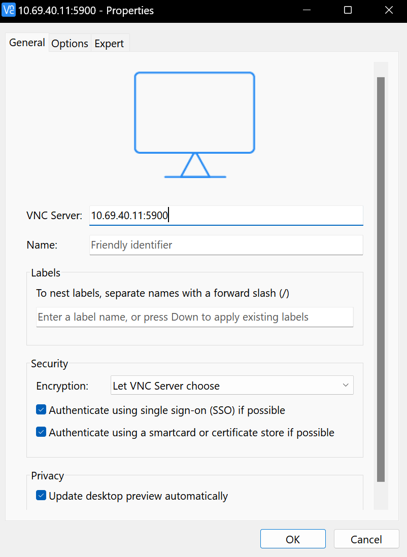

Then add it to VNC, with the management IP of your SCALE host and that port number:

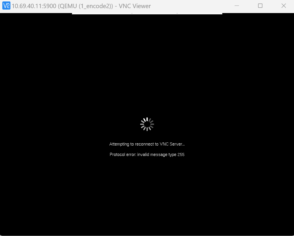

It should work for initial setup now. For me, even this will not work unless I have the VNC console open BEFORE I start the VM. If I try to use it after the VM is already started it looks like this and never loads:
Before I open the new ticket, let me know if you can reproduce the same behavior if you can.

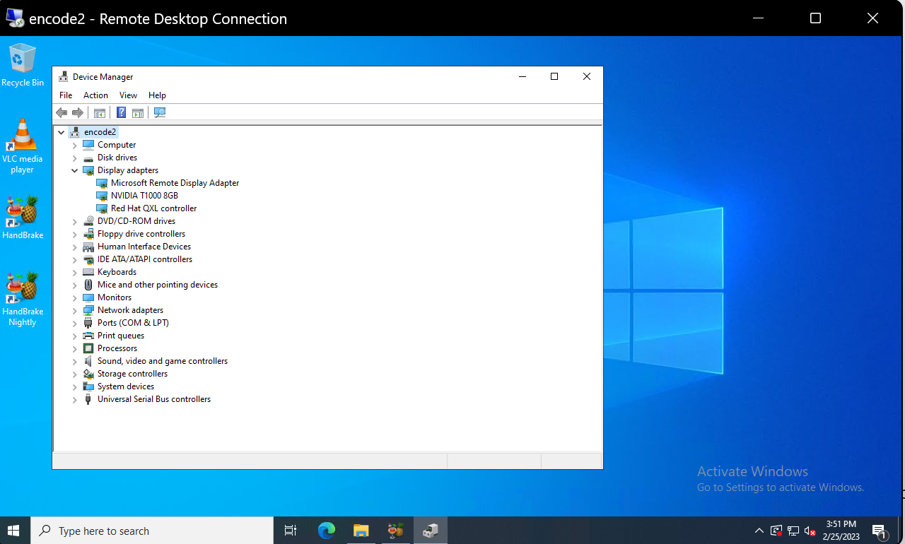

But after I setup my VM and installed the NVIDIA drivers, I am able to use RDP reliably to access my VM whenever after the initial setup. If you are using Windows make sure you install the latest Virtio drivers AND the guest agent (both installers in the same ISO) https://fedorapeople.org/groups/virt/virtio-win/direct-downloads/archive-virtio/?C=M;O=D

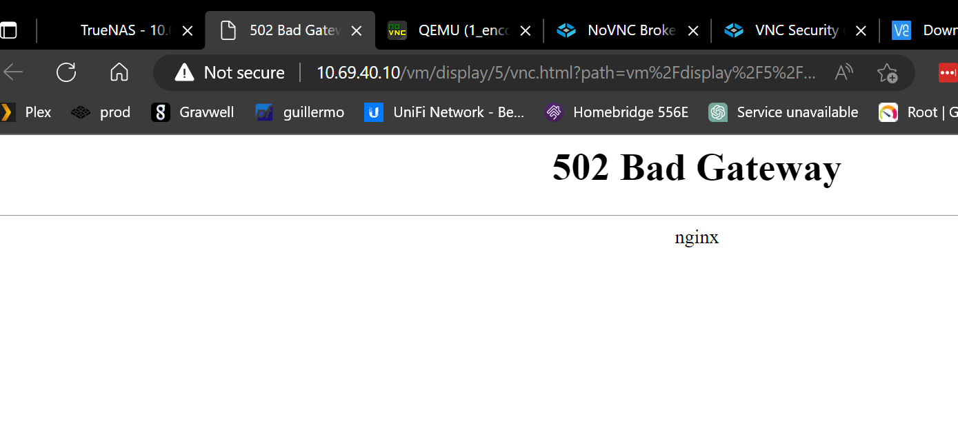

What's weird is that sometimes the VNC console does work for me. In the example above its working right now. It may continue to work, but it also may stop working if I restart EITHER the host OR the guest:
But on another host, with the EXACT same hardware configuration and a CLONE (ZFS Send of the hard drive's ZVOL to this host) of the same VM with the only difference being it's hostname, I get this error. I cannot explain the inconsistency, and I have been racking my brain on this for weeks. I didn't even put 2 and 2 together with the NVidia passthru until I saw your post, so you have definitely helped me make progress here in understanding what's going on...

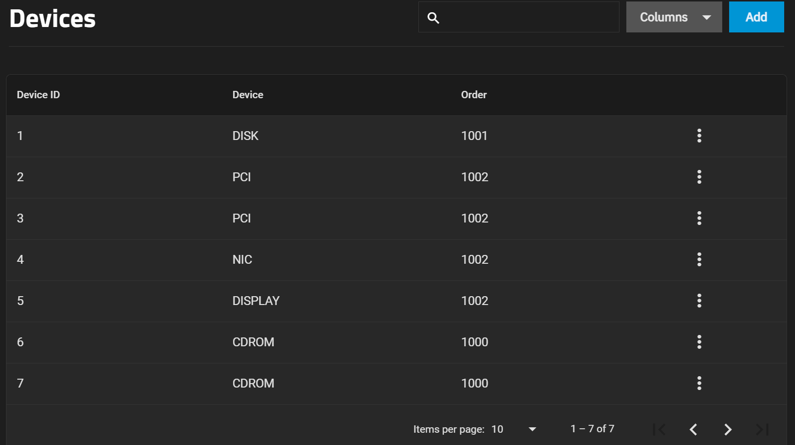

Hardware tab for both VMs are exactly the same:

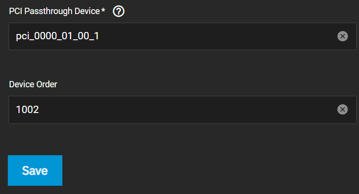

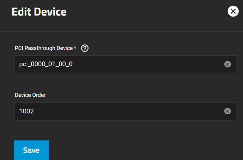

Same device IDs are passed:

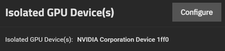

And both of them have the GPU isolation set:

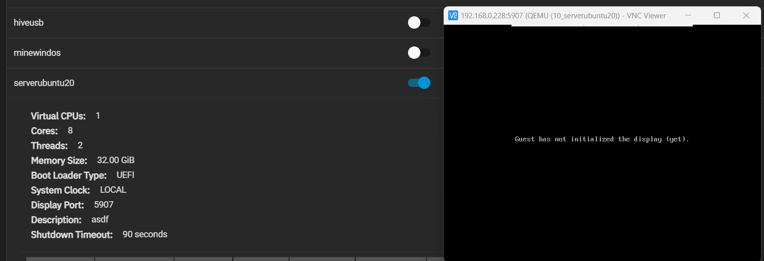

Yep. Gave that a go now. And it looks the same. Without the GPU the VM boots. And with GPU passthrough it shows "Guest has not initialized the display yet".
